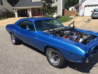

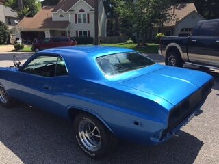

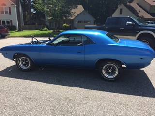

Magnum 500 15x7 on front and magnum 15x8 on rear. What size tires should I go with and not have to make any modification to a 72 challenger.
what brand did you go with?
I went with 235/60 on front and 295/50 on back. Looks killer thanks
235/60-15 or 215/70-15 for the front and 255/60-15 , 275/60-15 or 295/50-15 on the rear.
