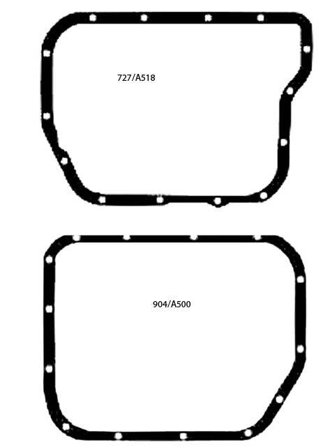

If you don't mind spending a little extra money, I highly recommend getting a deeper pan from a 90's A500/42rh (if 904) or A518/46rh (if 727) and filter extension. Extra transmission fluid helps the fluid stay cooler and the transmission last longer! See gasket photo below to determine your transmission.

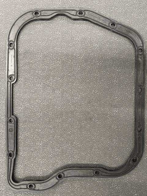

Another 727 tip...
Use the Mopar 02464324AD pan gasket. It is far better than a fiber or cork gasket.

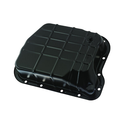

I run the deep pans from RockAuto built by Dorman for the 96+ 46re transmission. That pan has small 1/8" ribs built into the bottom and a drain plug of course.

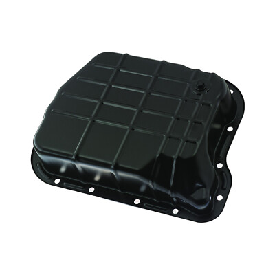

I use this $20 extension. I even drilled an extra hole in one to use in my 64 Imperial with the rear pump. Maybe it's just because I live in the heat and I'm always wanting to keep things as cool as possible! 😀
