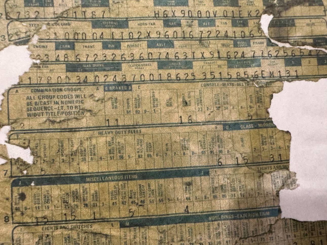

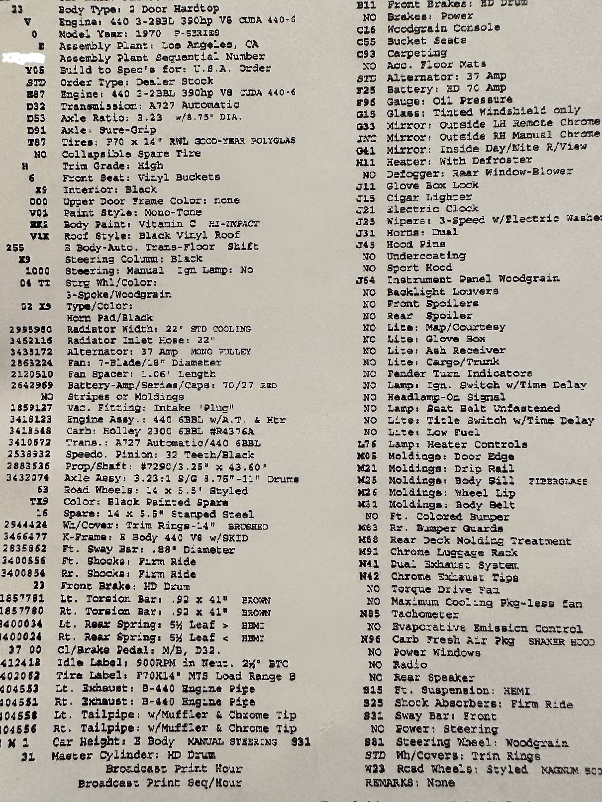

OK, to me it looks like T87 (F70/14" Good Year RWL tires). Easy enough. I am assuming galens' report is correct with the magnum 500's with a trim ring.
But, notice the build sheet has code 63 Road wheels, and W24. Galens' report shows W23 (Styled Road wheels/Magnum 500). Why am I seeing different numbers, or am I misreading something?
