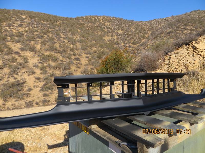

On my grill I repaired the back side of several cracks with body panel adhesive (incredibly strong stuff, but not brittle like epoxy) and in one small place I embedded a piece of sheet metal into the adhesive for strength. You can then fix the front of the cracks with filler; sand smooth and prime with a high build , catalyzed poly primer. (Catalyzed primer is thick, easy to sand, & will prevent any incompatibility issues b/t the original paint, and whatever you top coat it with) Wet sand with 400, then 600. Then paint. Btw, this is a 71 Challenger grill, painted with Hot Rod Flatz. It’s a urethane paint, very tough. After eight years it still looks great.

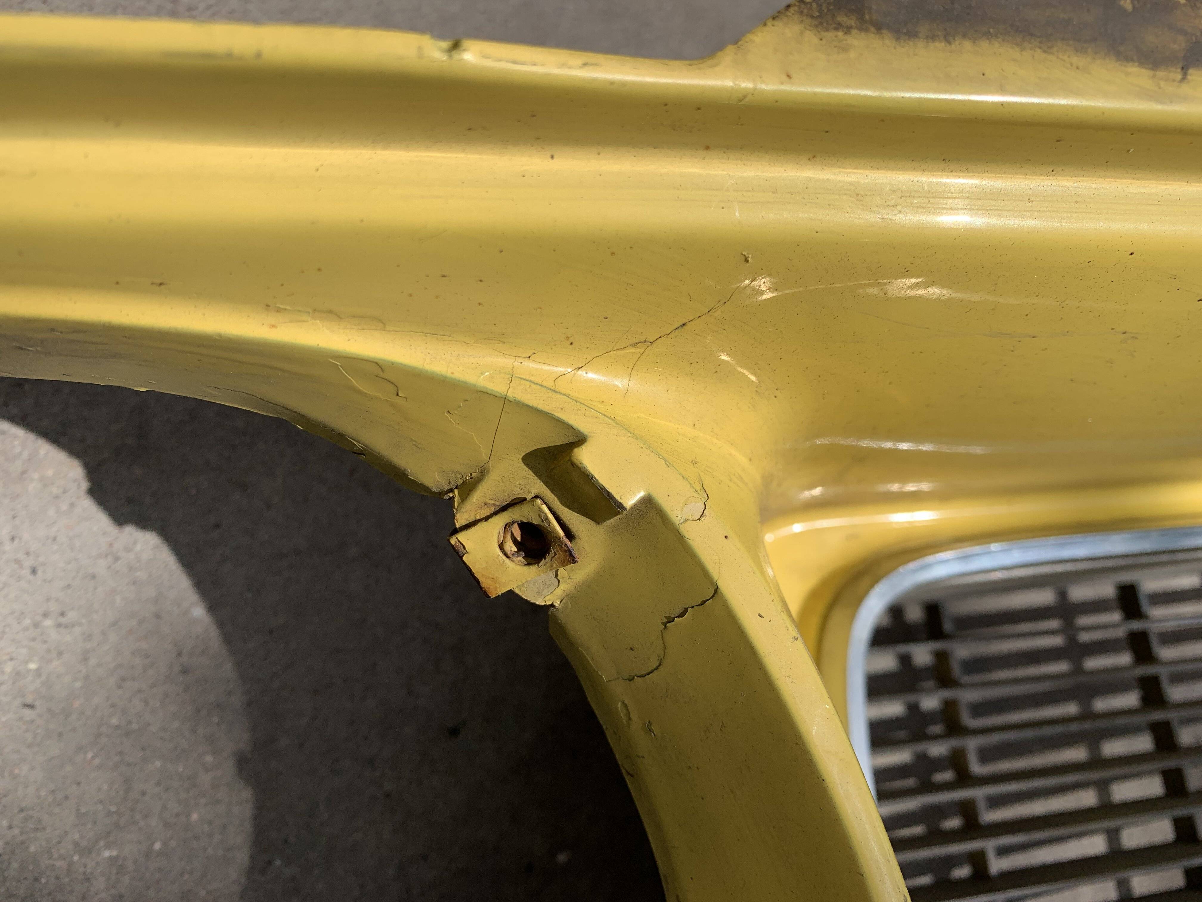

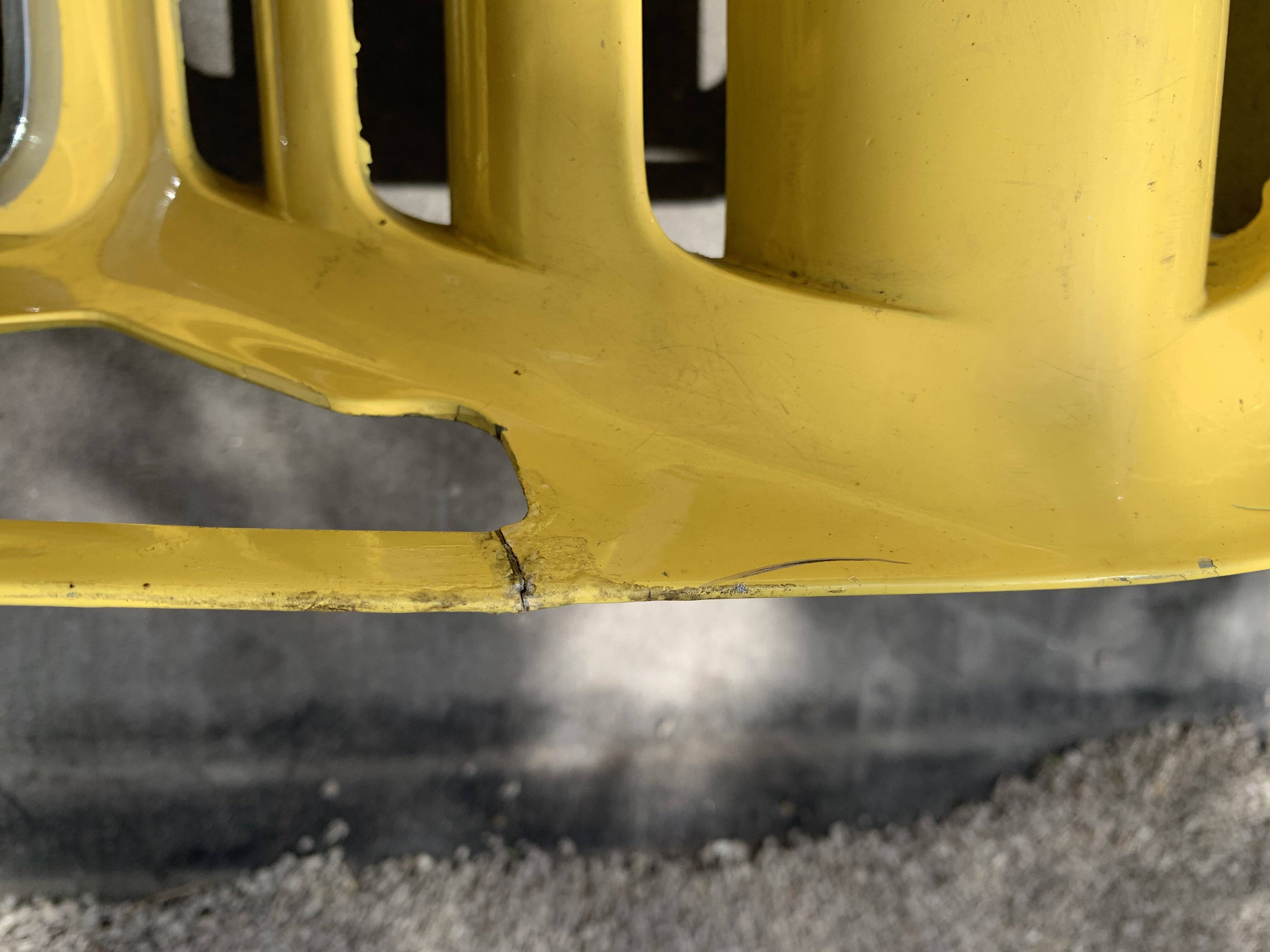

Got the grill yesterday, and I’m quite pleased. There are only a few very small cracks that should be pretty easy to repair. Thanks everyone for the advice!

Those are relatively minor cracks. Clean and epoxy the backsides of them and wherever possible cut a piece of sheetmetal to fit and epoxy it on the backside to reinforce the area. When I did mine I took my dremel tool with a small ball cutter and V'ed out the backside of the cracks before the epoxy. If you do this, be careful and try not to go all the way through. Fill and sand on the front side and then paint! :thumbsup:

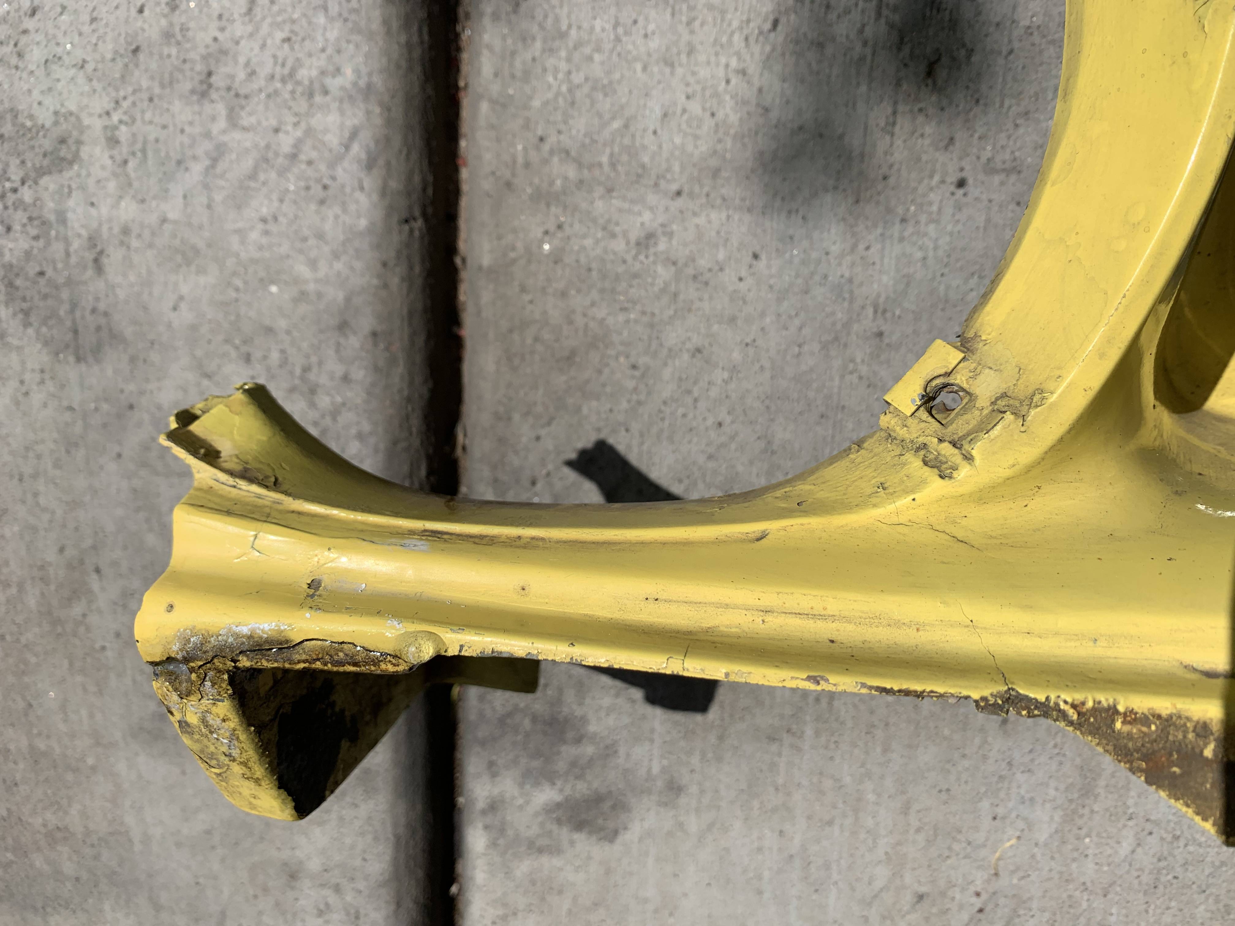

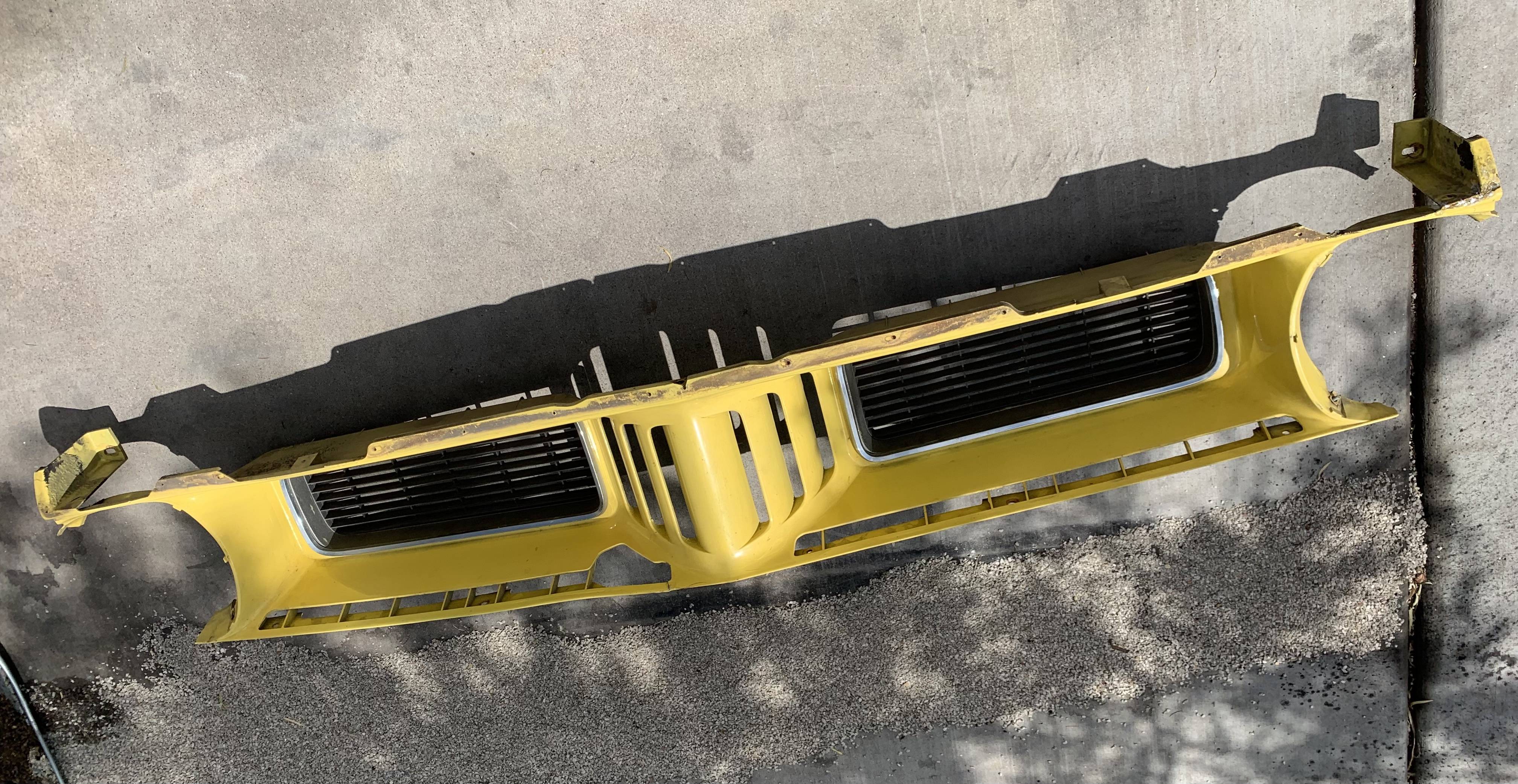

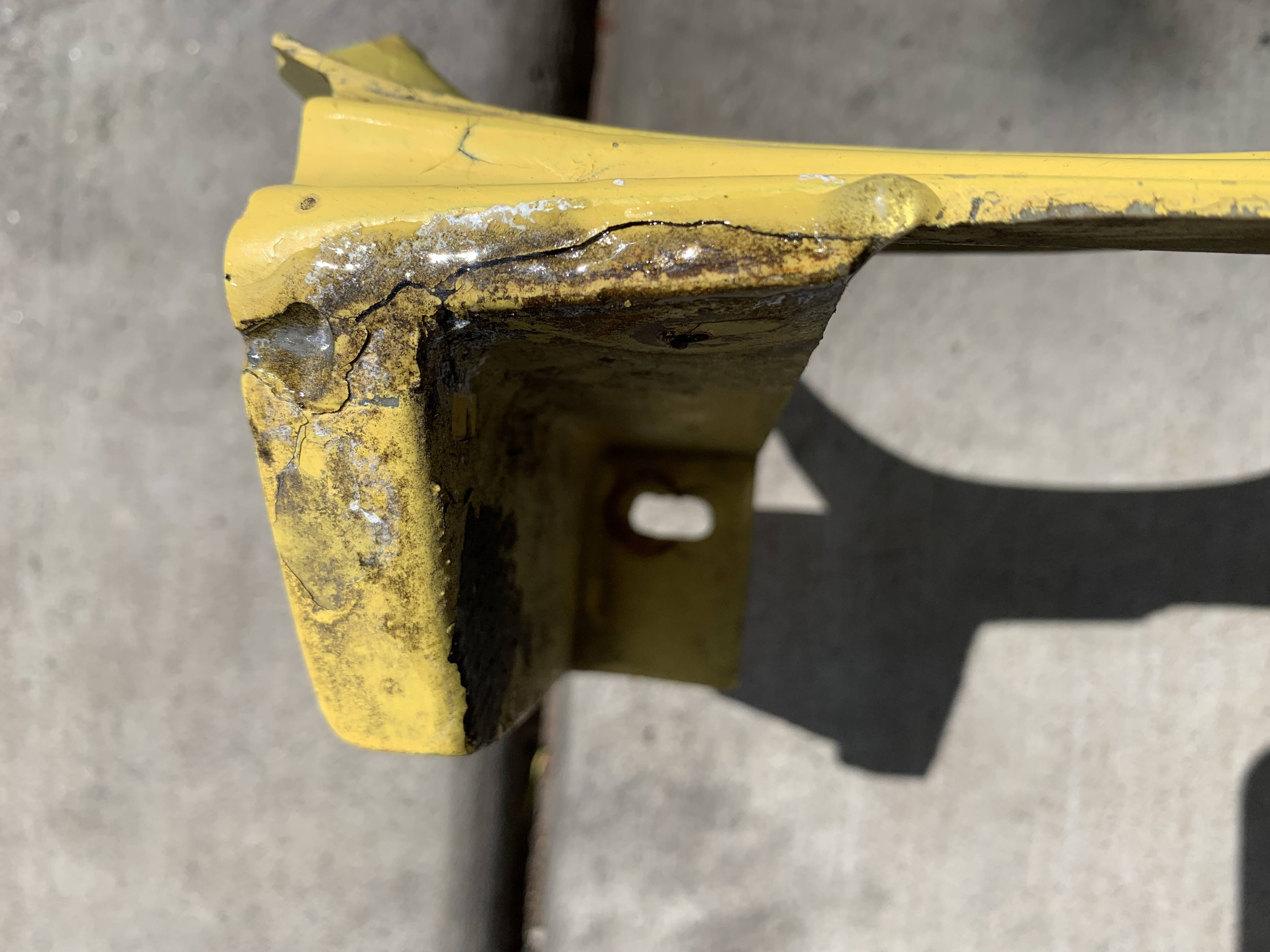

My grill is in pieces and the car doesn't have a front end to speak of. I'd need all of them sadly.

What year is it? Maybe send me a pm with a pic or two of the pieces. I'll see if I can make something useful for you from mine.
That's be awesome. It's a 70. Gonna be later tonight but I'm a long way from the work so feel free to take your time.

I asked google (LOL). From the pics and some videos on line, the 1970 header panel and related grill mounting is very different from any other year. You'll need 1970 details - anything from my '74 will unfortunately only confuse you. Sorry could not help more.
