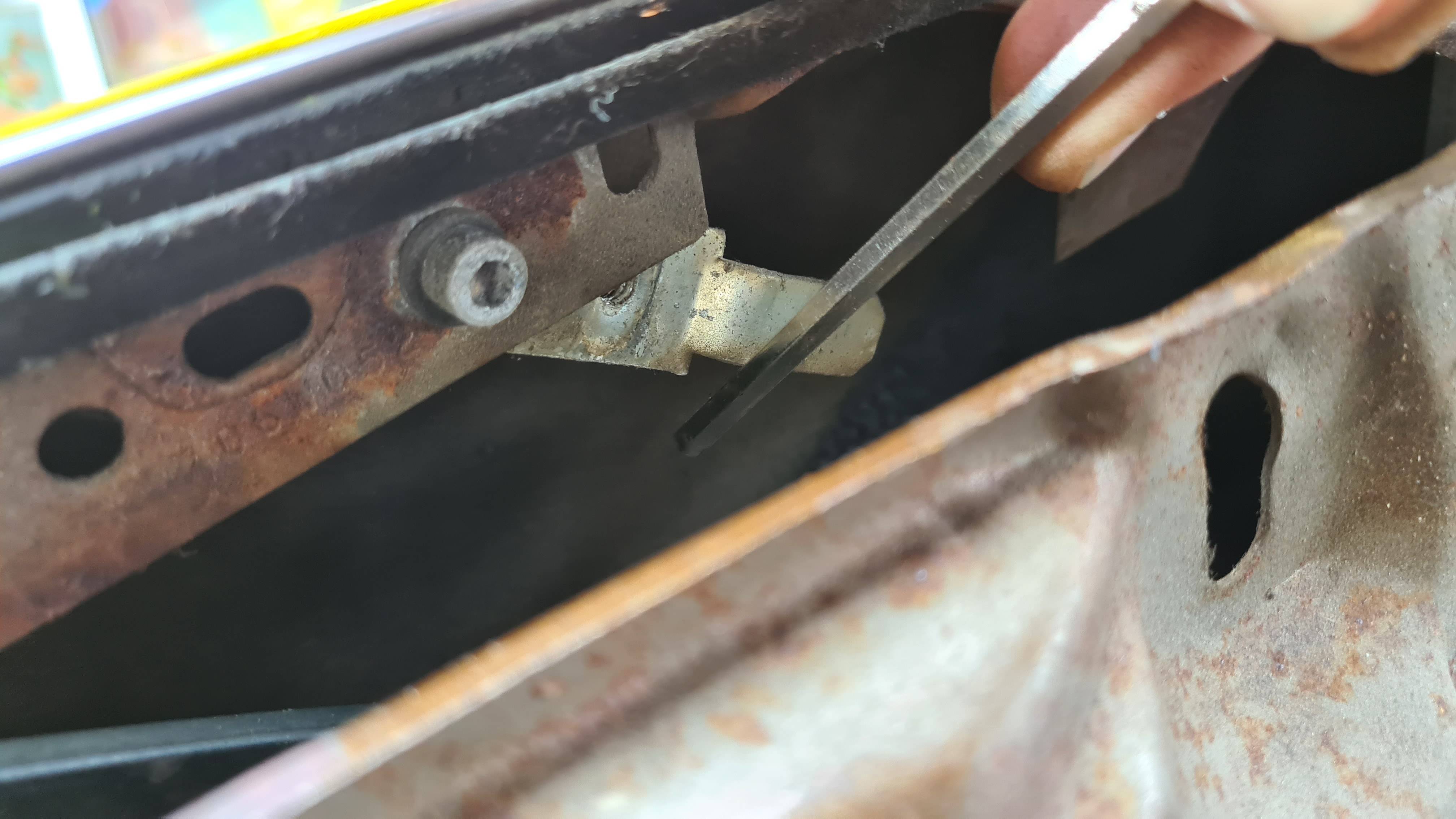

Hi all, been part of FABO for some time and now I'm please to join FEBO.
Got this Challenger recently and today I was sorting an issue in the passenger rear window and came across this. What is it?
Couldn't see any use for it but....
Thank you.

It looks like the remnants of one of the window stabilizer, they have a fuzzy type material on them and the glass rides/lays on that as it goes up and down. I believe that they were used because an E body has curved glass.

I have the same, but on the driver side passenger window, not the other. It is rotated up and out of the way on mine. I have no idea what it's for.

That’s an adjustable bracket for the 1/4 window up stop bumper. It makes contact with one of those plastic plugs that snaps through the lower portion of the glass.
I was looking for one of those awhile back. Additional pics here:
70 E-body 1/4 Window Up Stop Bracket in Parts Wanted

Thanks all.
The way it's installed at the moment seems to be making no difference whatsoever but I'll remove all the door panels and compare everything when I can.
