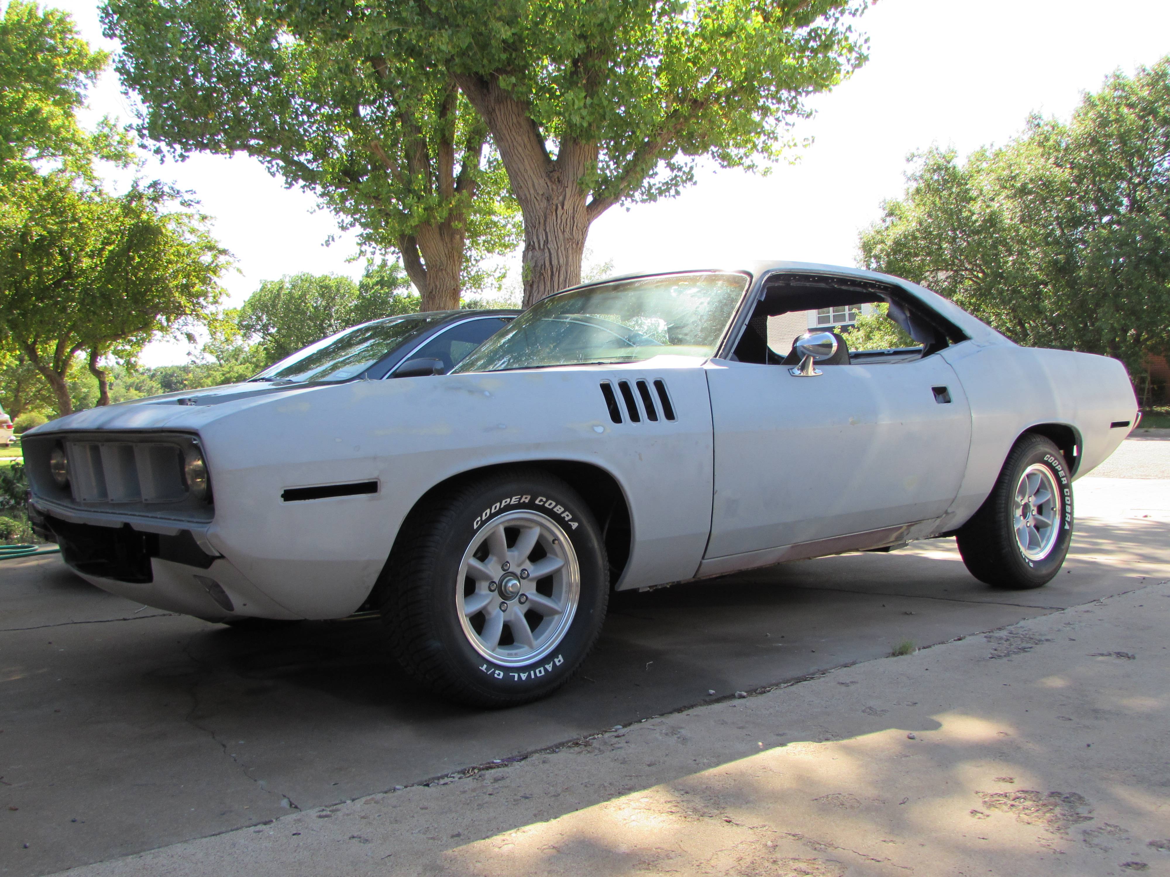

Installed year one aluminum 17 inch ralleye wheels on my 73 Barracuda and the studs are definitely too short. I have searched hours on every forum and can't find a straight answer for info on longer studs. Has anyone replaced front and rear studs for aluminum wheel install? And if so where did you locate the parts? Thanks in advance!

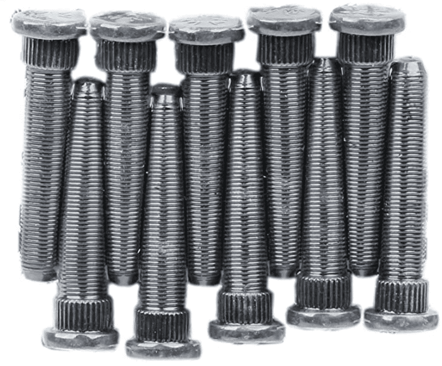

You can try aftermarket race studs like ARP or Strange , they are usually 3" long but can be cut down .
You need 1.5 times the diameter in thread engagement minimum so for 1/2" studs you need 3/4"of thread engagement

I got these to use with our Year One Rallye Wheels.
Part # 8010 - 1/2" - 20 X 3" .625 Knurl - Moser Engineering
Moser Engineering (8010) 1/2"-20x3" and .625" Knurl Diameter Wheel Stud Kit, (Set of 10)​

Thanks for the help! Moser also offers part 8020 with a .685 knurl that will work on the front. Just in case anyone else has this issue
8010 with .625" Knurl Diameter are what fit my front rotors... “¯\_(ツ)_/¯“
