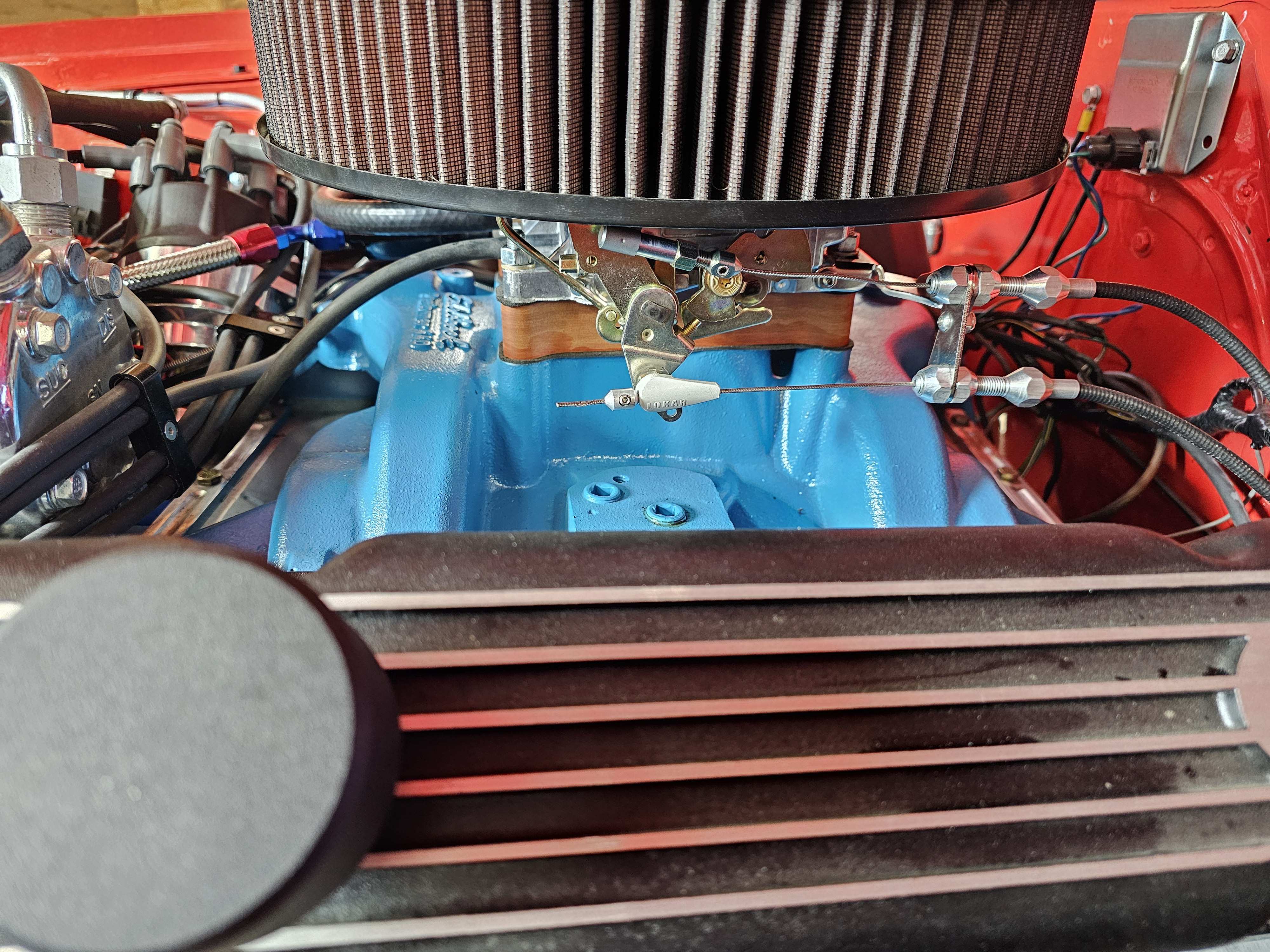

So the angle is off maybe because of the Edelbrock TM6 intake .
Any change of intake manifold almost mandates changing or modifying the throttle cable/kickdown bracket. When the bracket is incorrect it causes the throttle/kickdown to be at a weird angle. That will certainly affect proper operation.
Ricks72Chlgr440
May 2, 2023
391
314
Sisterdale, Texas
The Lokar setup mounts the throttle/kickdown bracket on the corner stud of the carburetor so you can use any intake and it will be lined up correctly.

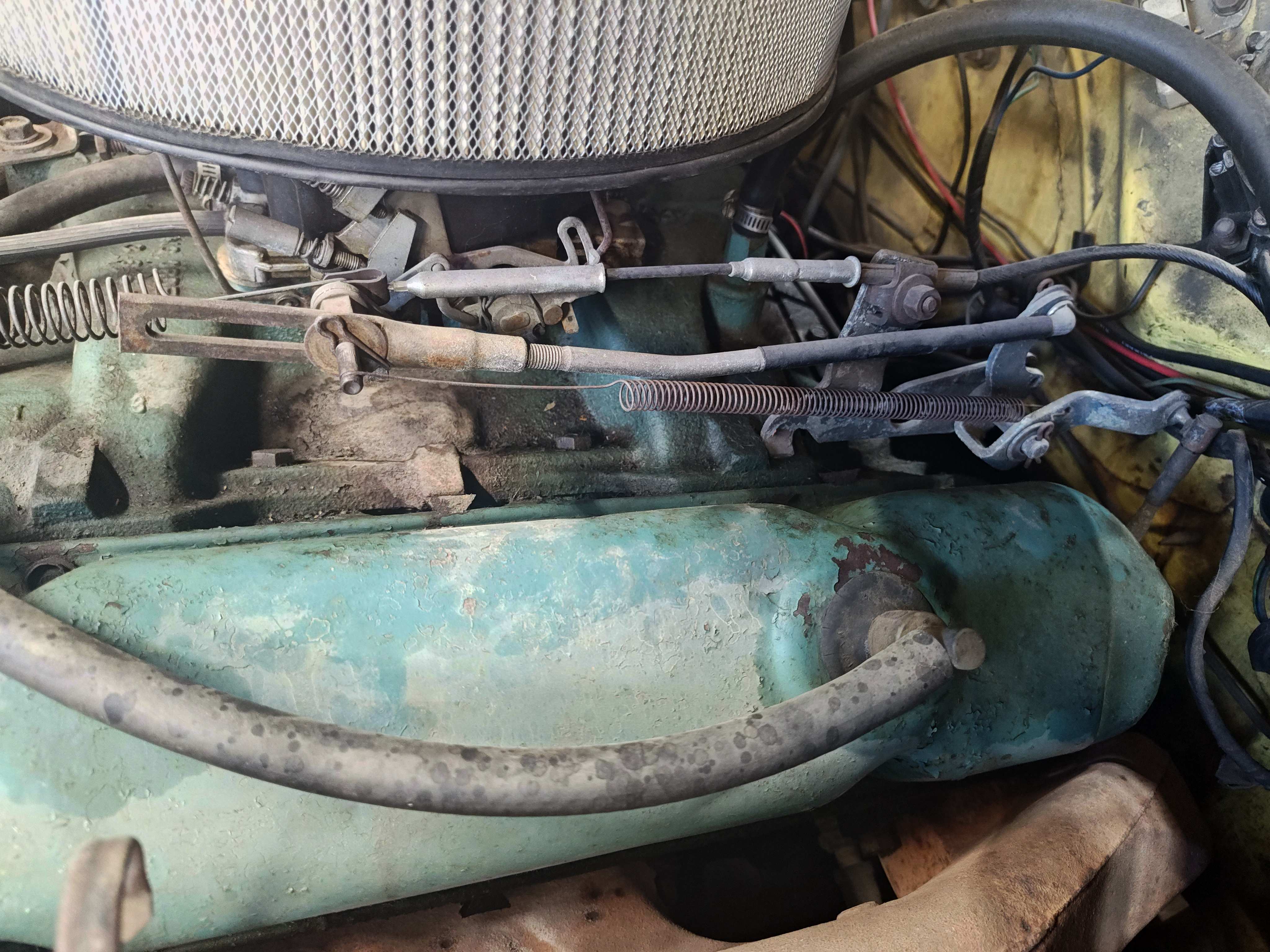

Hey, it's not pretty because I had to modify both the throttle cable and the kickdown leakage, but it's been this way for about 125,000 miles! 😁
I need to buy a four barrel throttle cable and it would "clean" up a lot better. I could get my throttle rod switched over so it's the correct orientation, but, heck, it works!
Hey, you gotta do what you've gotta do!!! By the way, I love the thermoquad!!!
