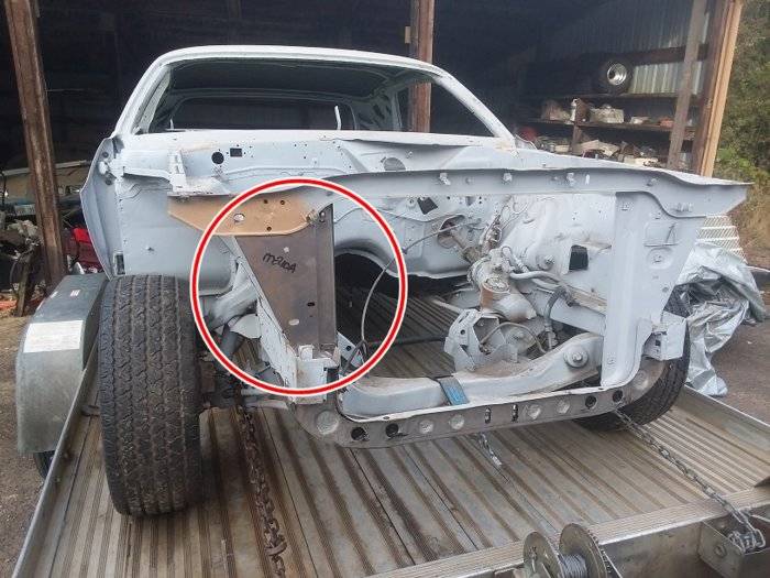

Yes, they had different radiators and core supports depending on the engine. The main difference is the opening for the bigger 26 inch unit. There is a piece available to enlarge the opening, but if you already have it painted you are going to have to redo it, or live with the 22". Below is a picture of the piece that I put on my car (circled). You might be able to use a 22" since you have a manual, but if you are going with A/C might need to rethink it.

This will work fine if you are still running the /6 motor and can live with the non-stock look of it. I wouldn't do that with a hot 440 because the airflow would be somewhat compromised. May not make the difference but hate to find out later. If you want it to look correct either change the support or get a smaller radiator.
I did the opposite of him. I've got a 22" where I should have a 26" and had to make extension brackets. I'd swap you but I need for an auto and shipping would make it pointless.

Thanks guys, I appreciate the help... guess a 22" is the answer for now since its painted. Will let everyone know how things go.

Well I've been running my 440 this way since I posted this thread and never had a cooling issue. This in central VA summers. At 70 mph or idle. Never had the gauge past half way. About 2.5 in of fins are blocked, but the air flows around the support through the blocked fins. Looks totally stock.
