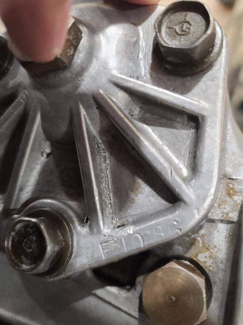

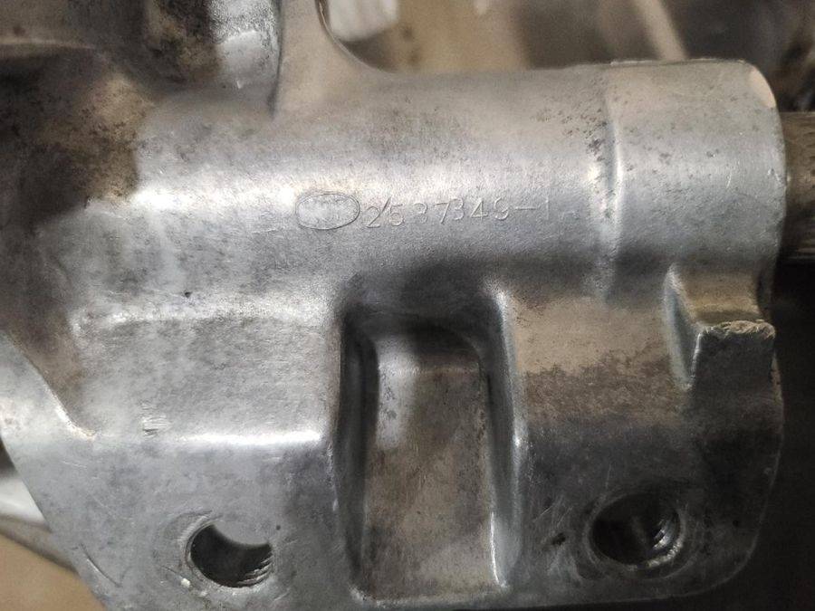

I have a 1970 340 Cuda . And the extra steering Box I have is a Manual box with the casting number 2537349-1A with the date code F108 C or G .
Will this part number fit my Cuda ?
To my knowledge there is not a lot of differences in manual steering boxes so yes it should fit & you will need the smaller pitman arm as the shaft is smaller than the power steering , the cast would indicate mid 60s so C would make sense being 66 .

No the C has nothing to do with the year. F the first letter is the year for 1970.
So the box is a 1970 manual steering box.
Does any one have a 1970 Cuda manual steering box out of their car that can check for sure for the casting number?

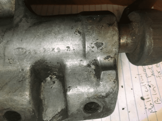

I have a manual box I took from a 70 Challenger I stripped for parts back in the late 1970's. Cast number 2537349-2 with a date code of F0105R = April 15, 1970. Small sector shaft. Still has the original pitman arm #2835878
Your F108 box is just after mine; April 18th, 1970

THANKS !
I also have the original pitman arm on my extra manual box part number 2835880 w a casting number of 2835878
In 1970 the pitman arm was the same for manual and power steering applications
