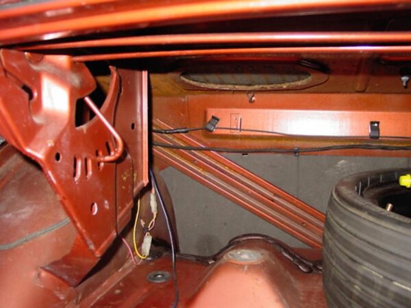

Does anyone out there have a photo of the layout of the under carpet wiring cables for the seats, rear speaker, rear window defogger and power windows?
It would be greatly appreciated.

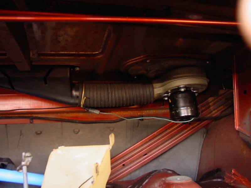

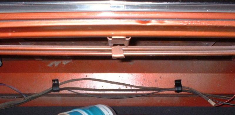

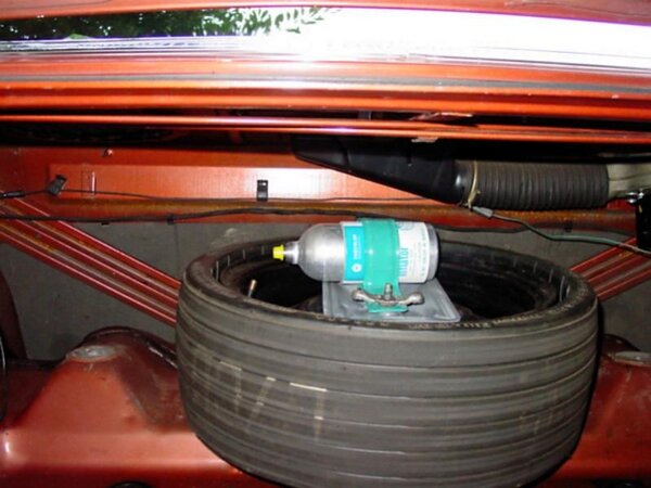

My memory worked this time. I found a few pics of the wiring in a trunk. The lower wire is the passenger side quarter window wiring.
