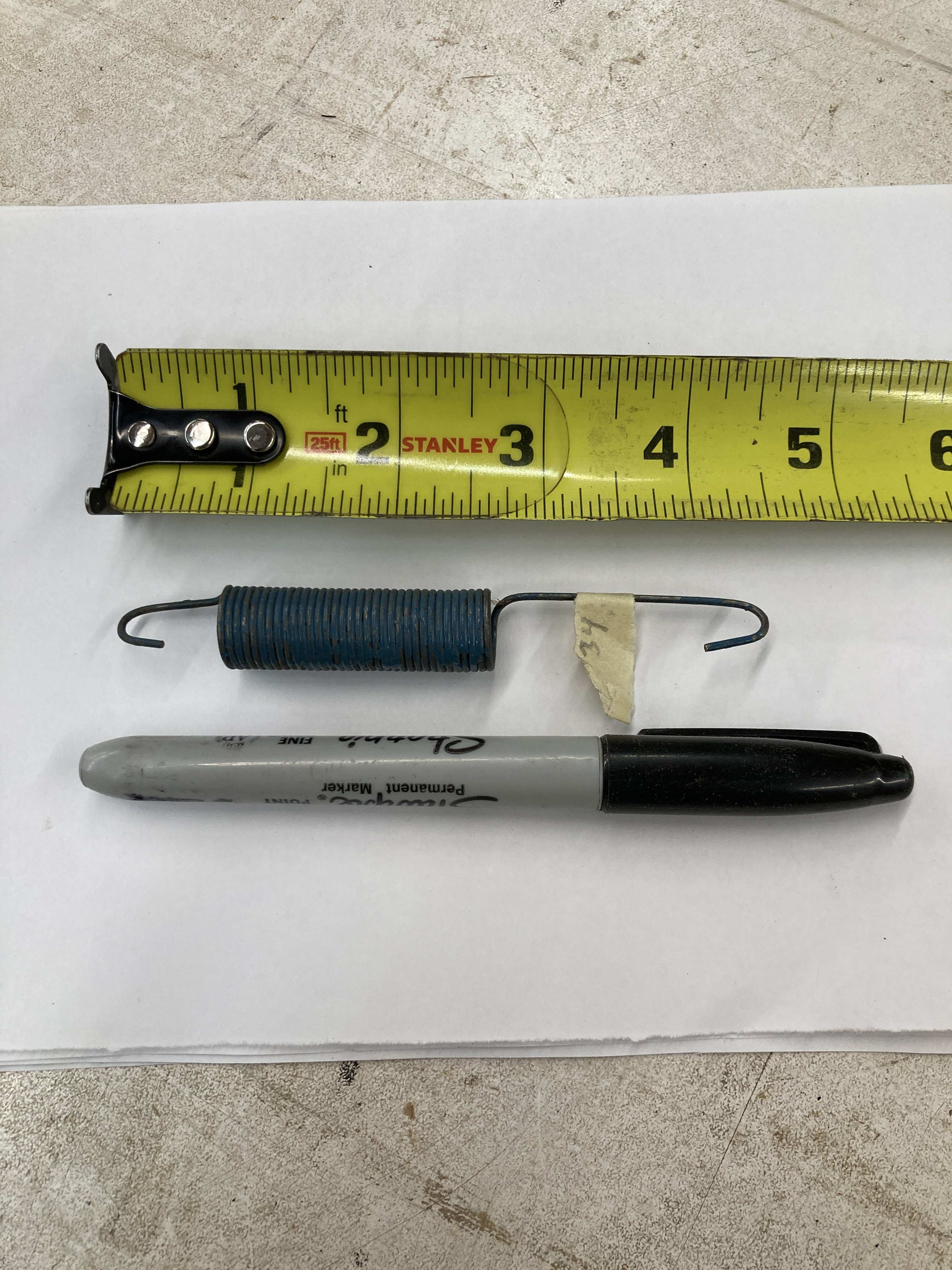

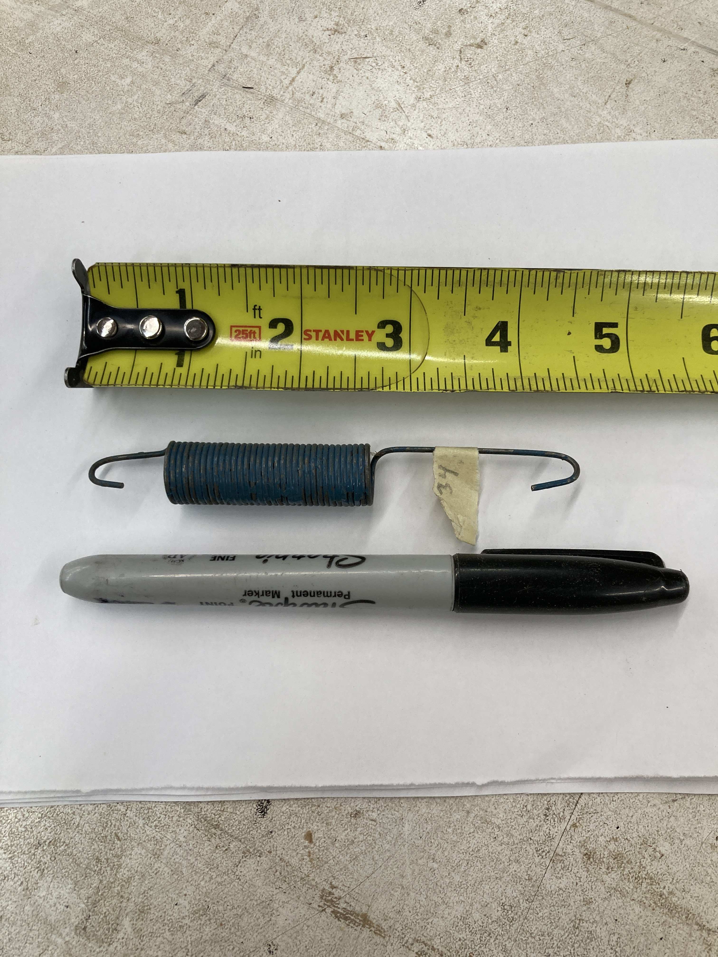

I have a small collection of springs and most appear to be NOS but of course there’s no packaging or really any way of knowing for sure exactly what they go to but I believe this one could be what you’re looking for. It’s blue with 34 coils and might be part number 3418815.

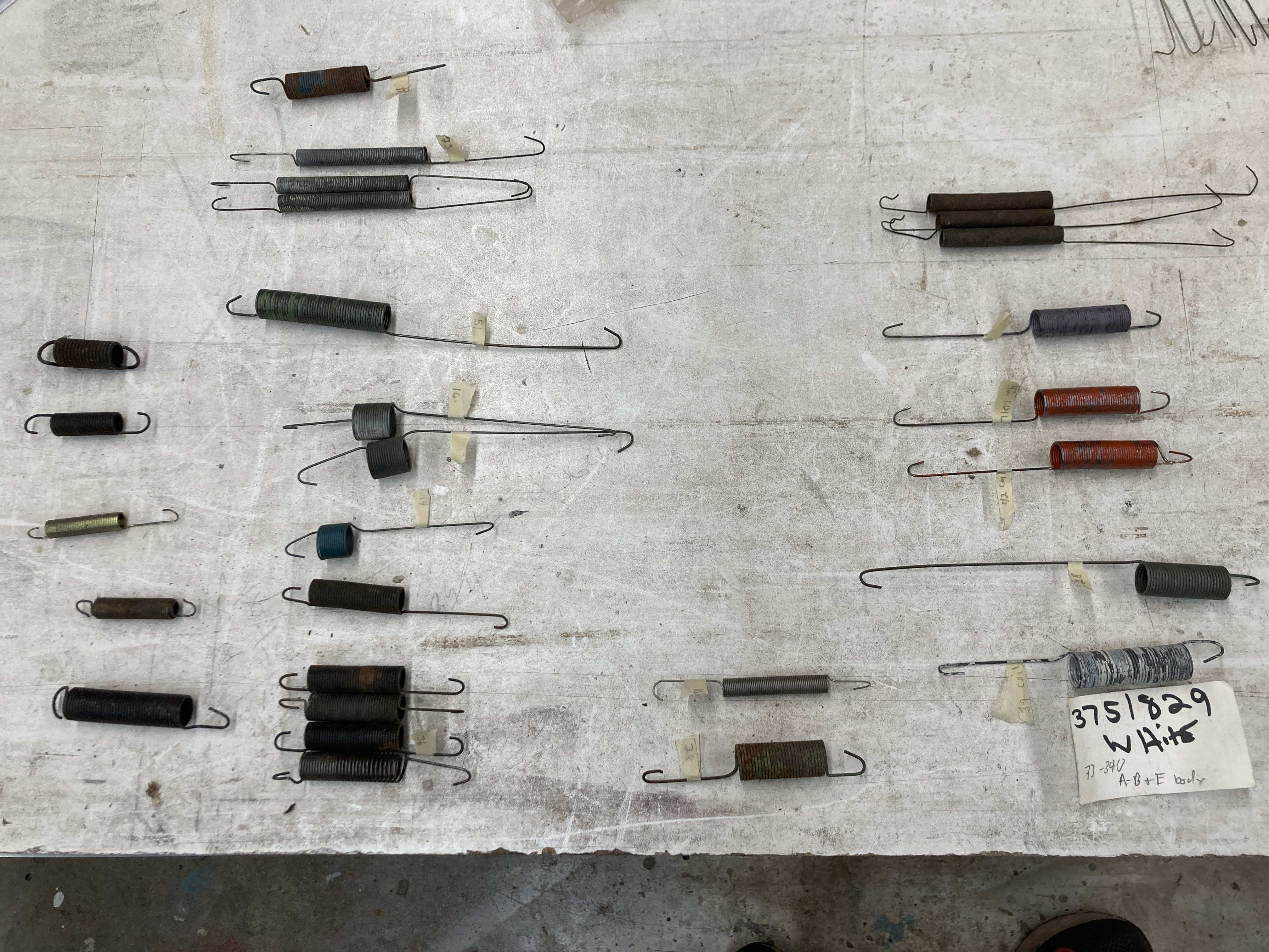

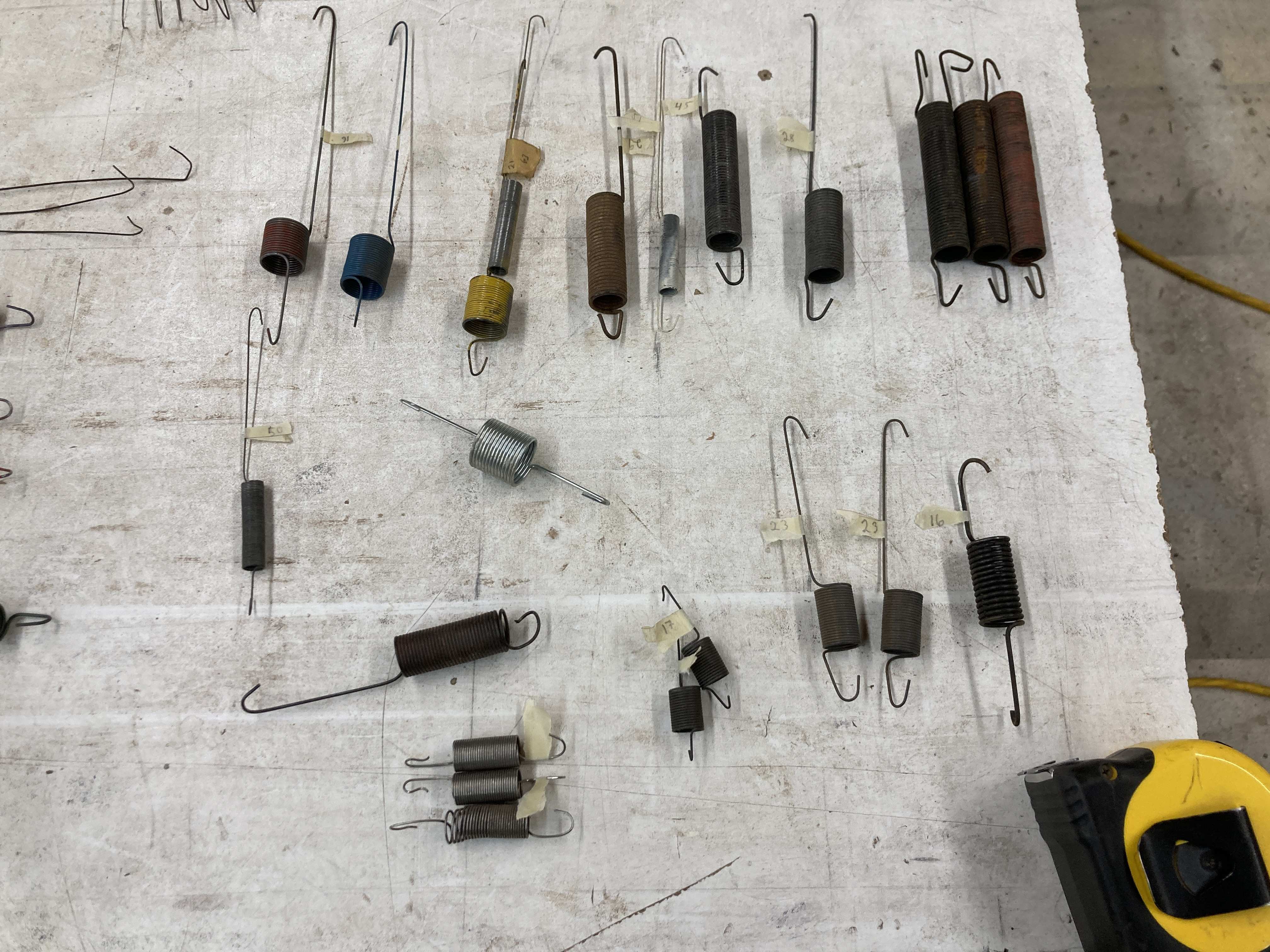

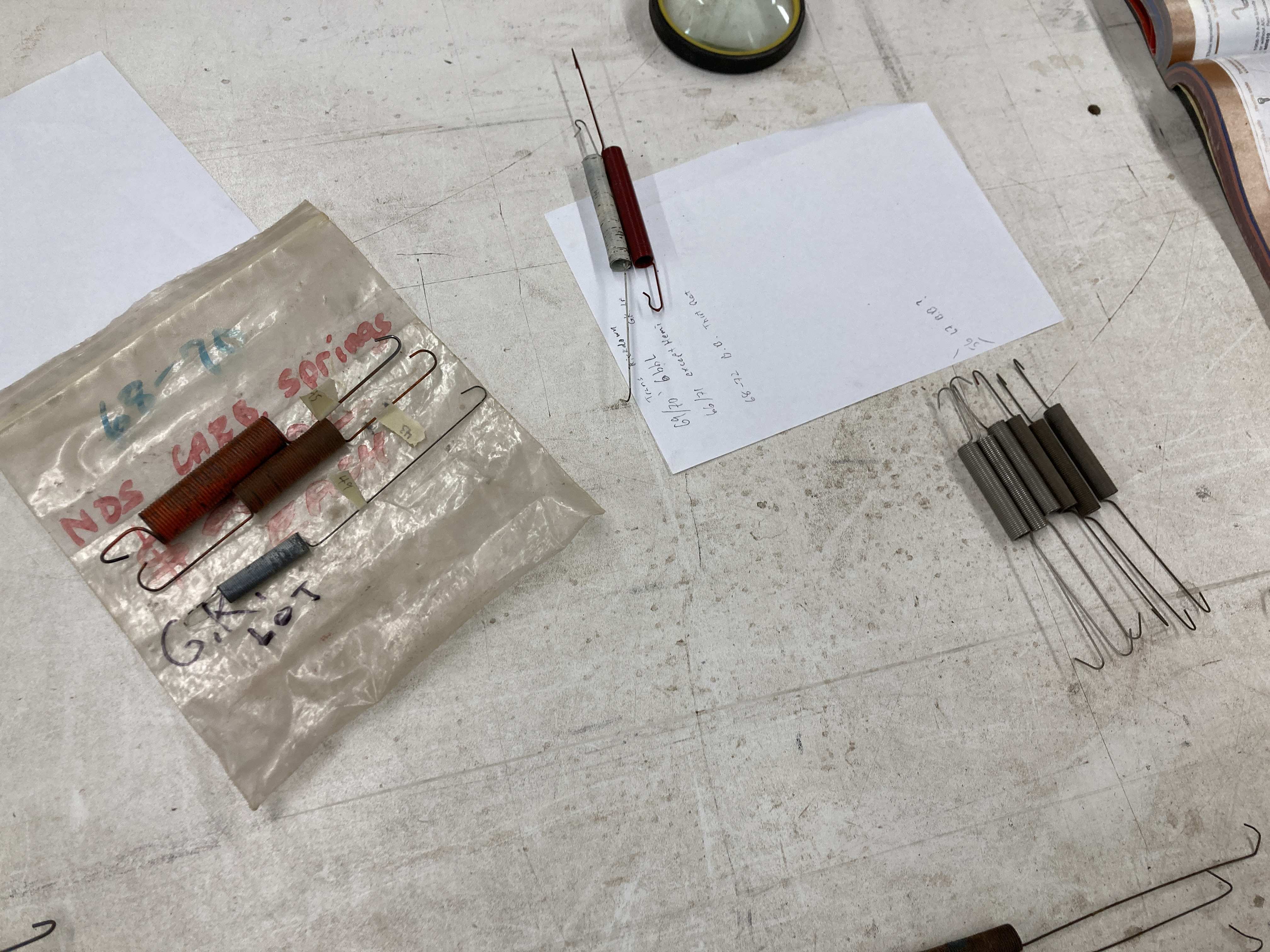

This is my collection and it’d be a whole day project or more to come up with the correct application for each.

I have a small collection of springs and most appear to be NOS but of course there’s no packaging or really any way of knowing for sure exactly what they go to but I believe this one could be what you’re looking for. It’s blue with 34 coils and might be part number 3418815.View attachment 139729View attachment 139730
I'll count my coils tonight.

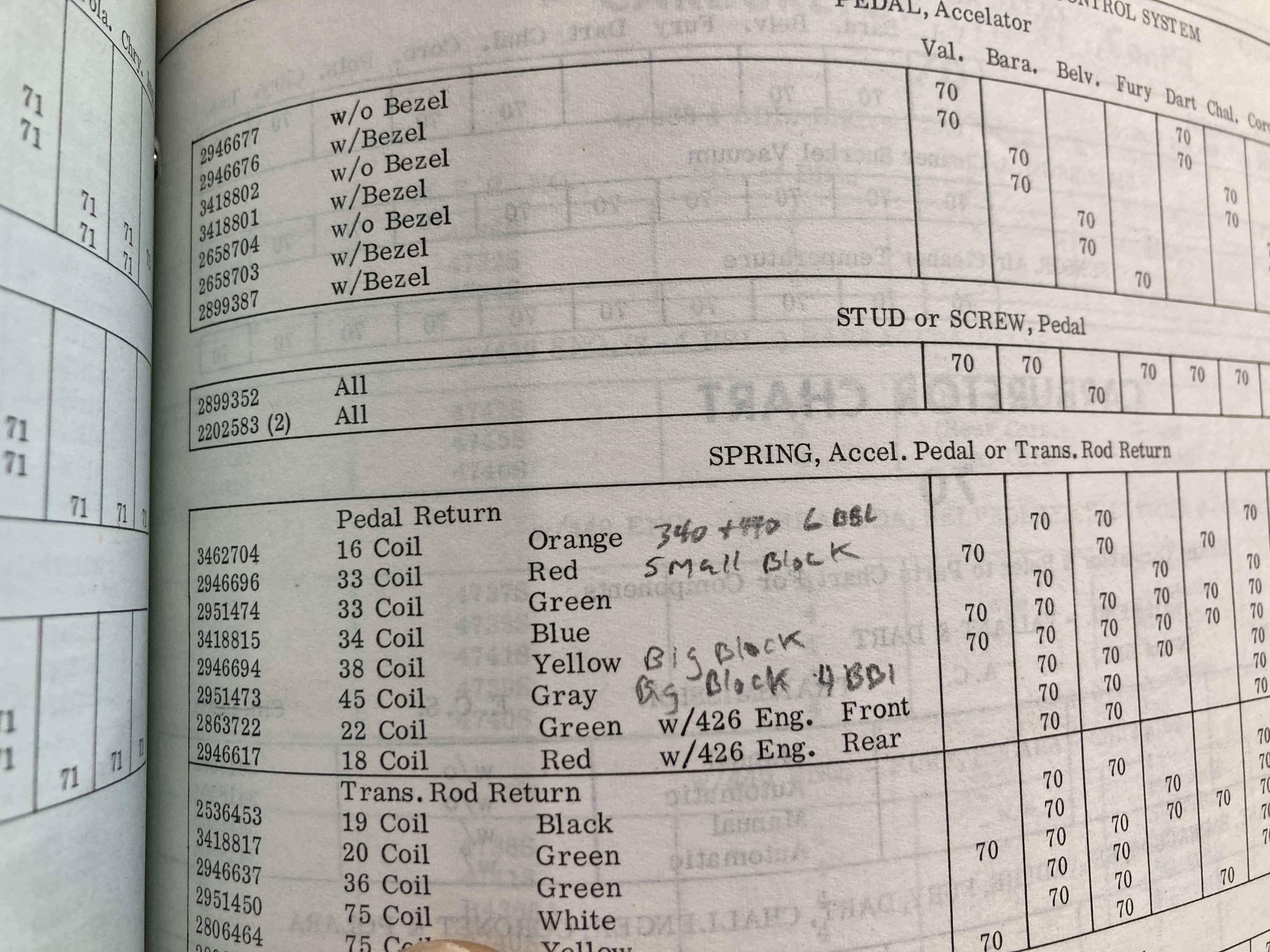

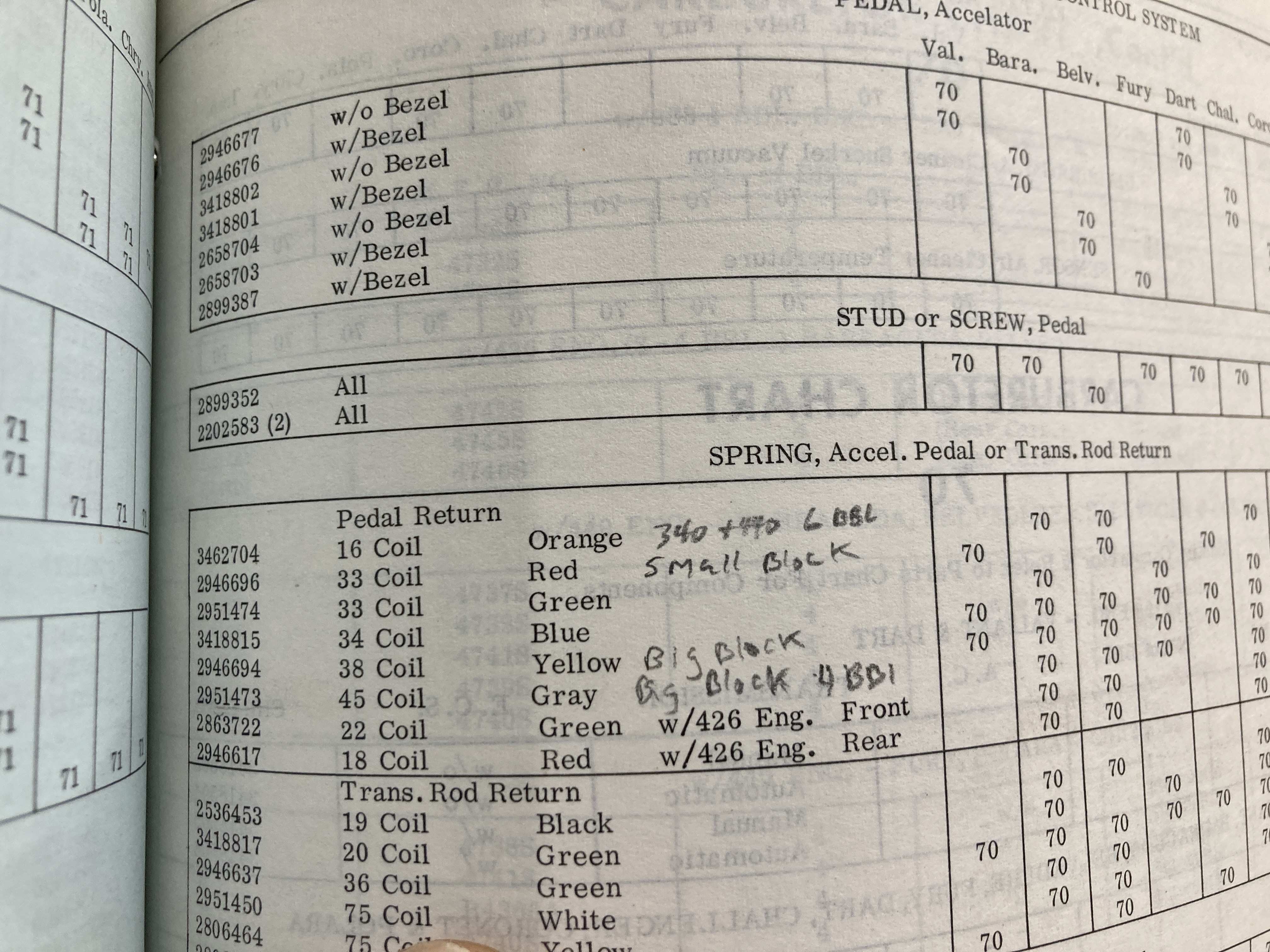

The color of the spring will tell you how many coils it has.
