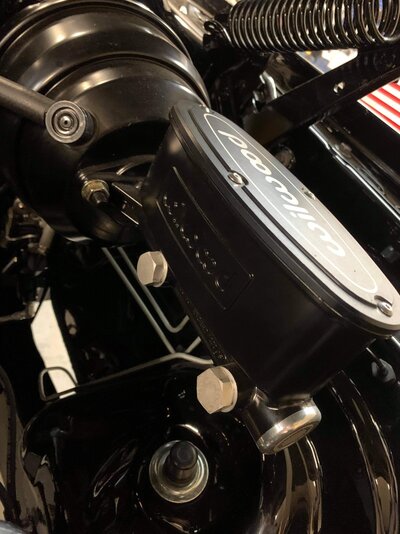

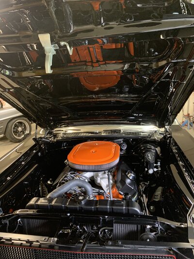

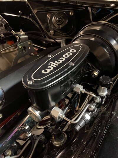

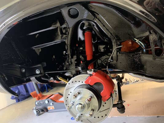

Some more photos on the car.

Ok as Steve 340 said:
You need to start by measuring the line pressures at the callipers. Once you know what you have you can make the right move.
Until you do that you are just guessing.
By the way if you fit a bigger bore master cylinder this would reduce the line pressure and likely make the brakes worse.
You might need to adjust proportioning valve for more pressure to the front brakes.Did the install instructions give any pressure guide lines? This set should be correct with no residual valves installed. Again was this a drum drum car?

Its 15-12.5 wide rim with 315 tires in the rear. Rear rotors is 11.25 in./285.75mm and front is 11.00 in./279.40mm
