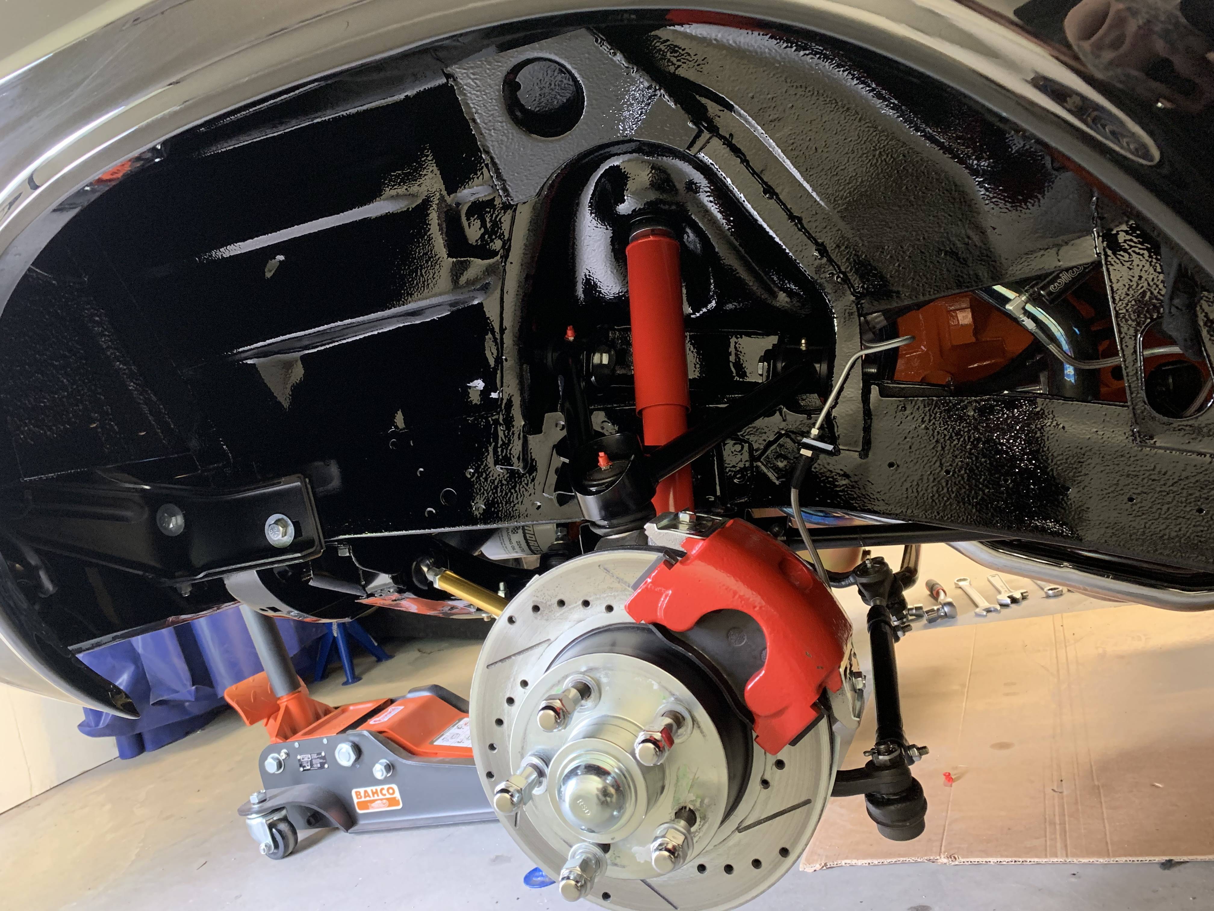

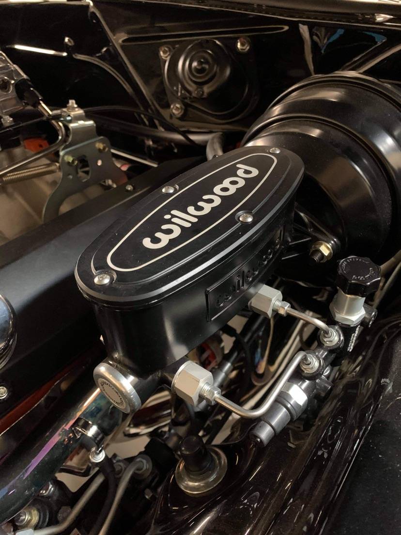

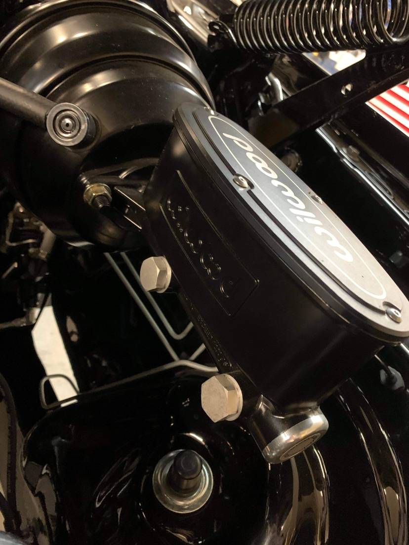

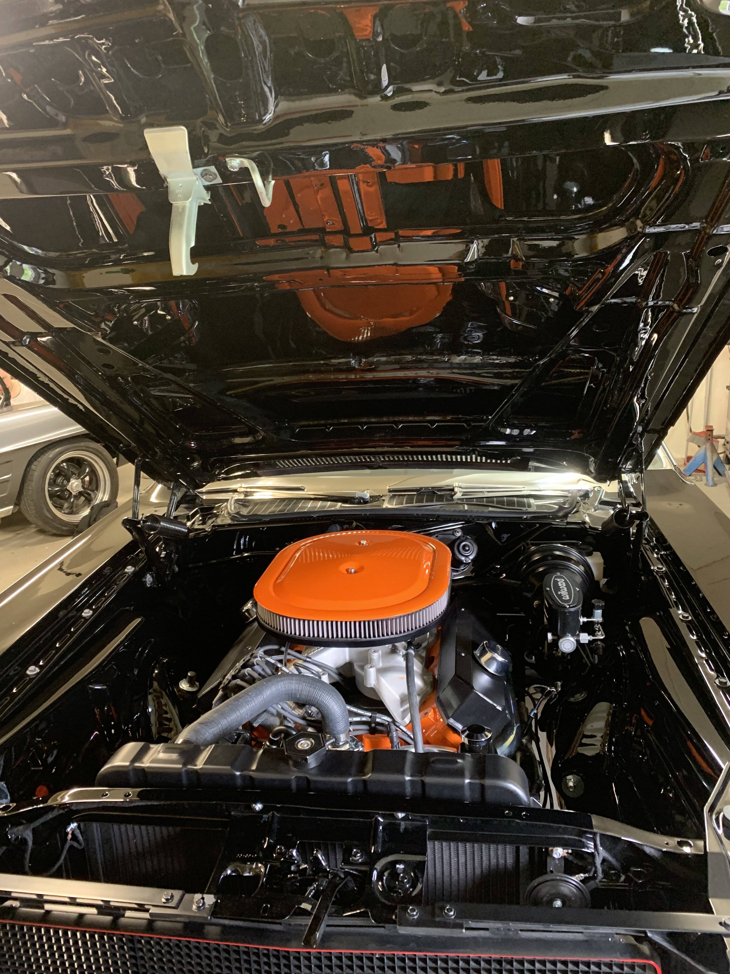

Some more photos on the car.

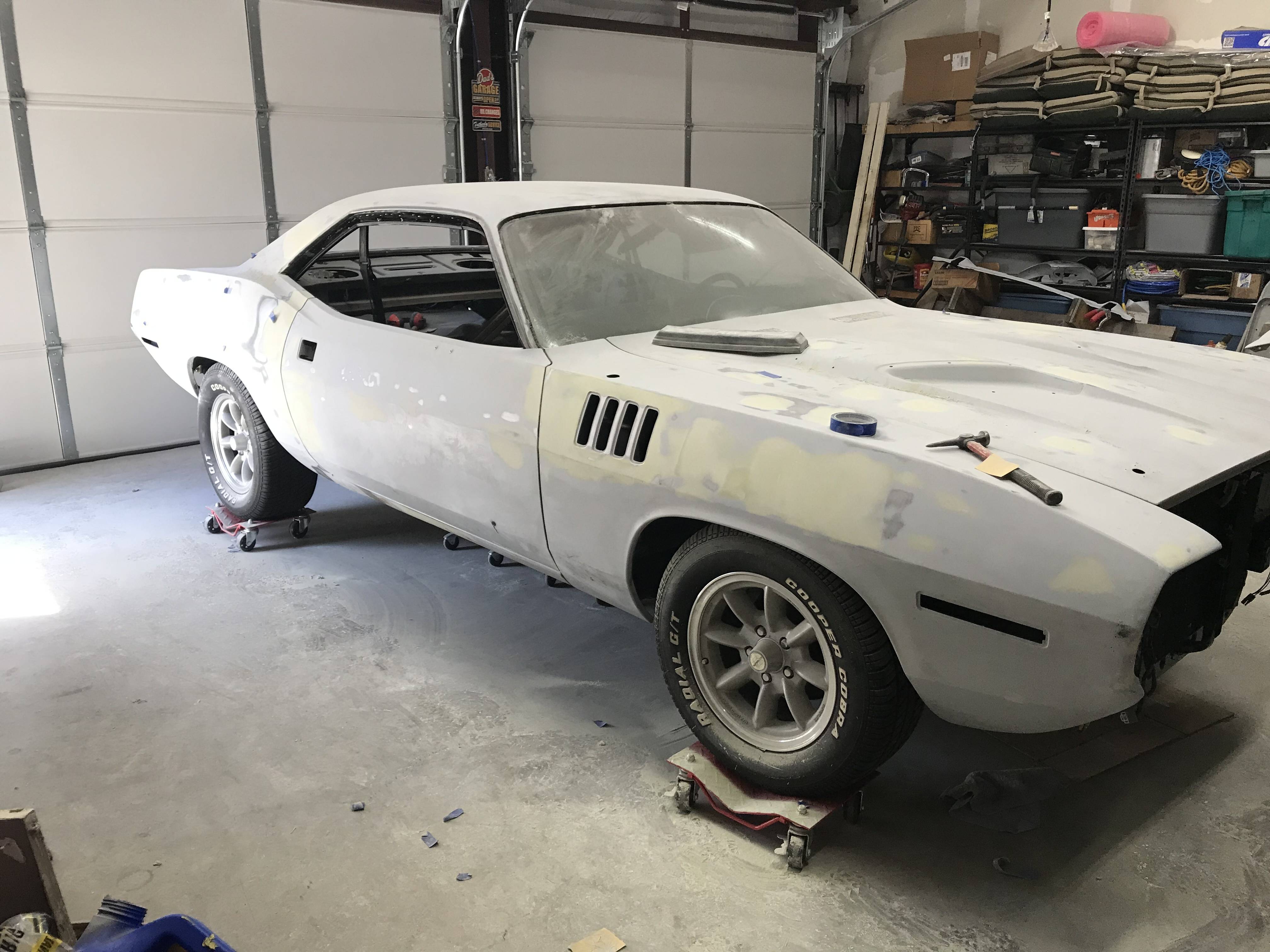

Obviously, you need to give the Challenger to me. Seriously, I have not been happy with my four wheel discs on my 71 Barracuda either. Same issues. I am working on painting it, so I have kicked the brake issues to a later date.
Hehe , its a really anyoing problem.. it should work better..
