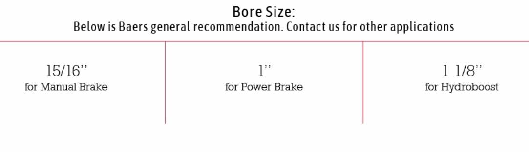

I to have seen this issue. And there may be some threads here about it. Seems that Wilwood recommended 15/16’s bore.
On my 73 cuda (original power disc) , I used Wilwood front disc/calipers, factory master cylinder and booster, rear drums. It will lock up all 4 tires when you want to.
I believe it to be a master cylinder issue as well.

okey but rightstuff and willwood Said 1” bore MC was enough, and some other guy here Said if i get bigger bore master cylinder this would reduce the line pressure and likely make the brakes worse.
I wish i kept drums back and only disc in front. Because now when it has 4 wheel discs, it really sucks to brake with. 😣

I had the same problem with a Right Stuff brake conversion kit. In my application a larger vacuum booster and a smaller bore master cylinder fixed everything. Remember, a smaller bore MC increases pressure at the wheels. This guy fixed all my problems..........ABS Power Brake, Inc.

Hmm okey, the booster is 8” now, did you change to 9” booster? I have 1 inch bore MC now, willwood sells 15/16 Bore MC. But its with pushrod. I need it without pushrod because the pushrood is coming out from my booster.

A bigger master cylinder bore moves more fluid as compared to a smaller bore, so the same amount of pedal travel will cause the slave cylinder (caliper piston) to travel further with the bigger bore master cylinder. However it is true that a larger caliper piston will result in less travel given the same amount of fluid movement from the master cylinder. Have you considered the size of the caliper pistons? Maybe mismatched to the master cylinder?

Willwood and rightstuff says 1” bore mc is enough. Someone with same problem tried go up in bore size, but with the same problem. Maybe try a smaller one , but i cant find a 15/16 bore MC without pushrod.
