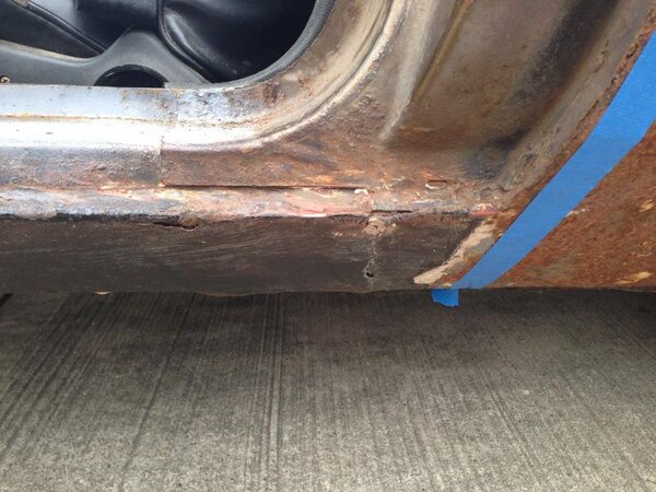

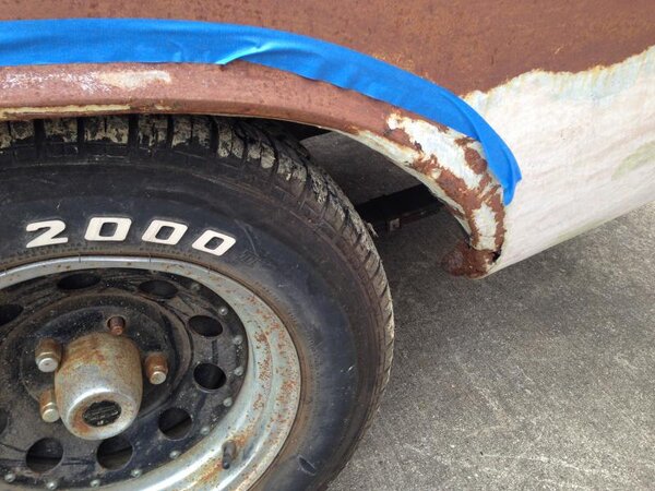

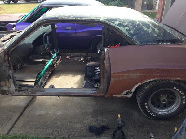

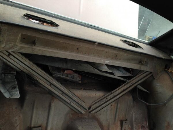

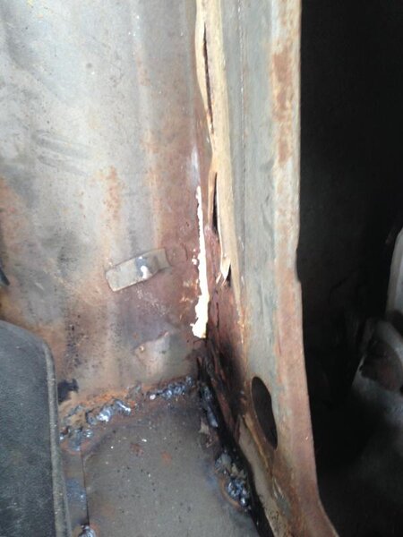

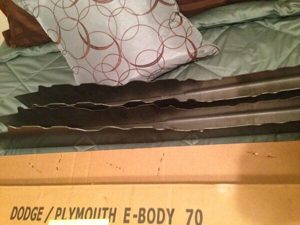

Recently bought a 73 challenger and its going to be a huge task to get it where I want. About half way done getting the new AMD replacement metal for it and getting ready to make my own frame jig or what I will call a frame jig. Just thought I would share a few photos of where I am starting. First time personally restoring a car but my dad has done five or six challengers just not this bad so that being said I would love to hear any advice anyone has. Thank you.

Looks like a great project, congrats! Did you already order your new metal? Check out some of my parts for sale ads. I may have something you need that AMD doesn't offer like rustfree door mount sections of the A-pillar with rustfree inner and outer rockers still attached. I also have a considerable amount of AMD metal that I no longer need among other things.

Buy a complete interior floor since it is all gone. You will save yourself a lot of effort doing it as one piece over doing several pieces.

sader, define restomod.
I have got frame rails, inner rockers, floor pan, seat supports, floor supports, inner cowl, inner fenders, about to order cowl and door hinge panels. My version of resto mod is updated interior and suspension. Engine i plan on building a beastly 340.

Parts I need are ralley dash, rallye fenders, trunk lid with spoiler support, and a 340 block. From amd I still need trunk pan, radiator support, rear frame rails, quarters and maybe a tail panel. Then us car tool bracing I already bought thier frame connectors to check their stuff out.

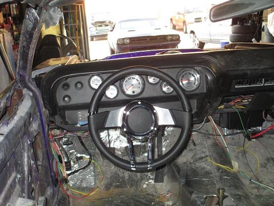

Then I would upgrade. I would run modern gauges, wiring, engine accessories, headlights, etc. You can do it expensively with a lot of bling or you can do it inexpensively without the bling. I have used American Auto Wire and their products have been good. Here is a pic of a Challenger dash I did around a year ago. Maybe it will give you some ideas. The car is a total restomod. Only the body is original Mopar. Everything else is modern.

Thank you for the info I will check it out. I was considering doing that with the dash, wiring, lights and all that. I just want classic body, 340, a killer posi rear end, and 4 speed tranny. The rest should be modern.

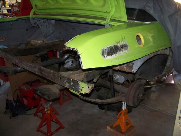

Sader,Looks interesting. Consider yourself lucky to have your Dads consult much less the amount of his skill. Here's my project, not as intense but never done it before. Tried joining the local club for assistance but you know how that goes, people like working and getting help on their own cars but doesn't seem to go that way when it's someone elses. Also not the type of person to go into a room and say "Hi, I'm new to your club but you wanna help me with my car." None the less its a chore but can't wait to get back on the road.100_2526.jpg100_2529.jpg100_2527.jpg100_2528.jpg
