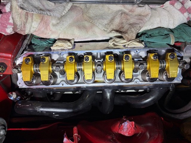

I have new Speedmaster heads and my old Crane Cams 64790-1 T Gold Race Roller Rockers 1.5 are a little too short so I thought the 0.100" longer 1.6 rockers would work.
I need suggestions for good valued 1.6 roller rockers.
What are offset & self aligning features of rockers?
