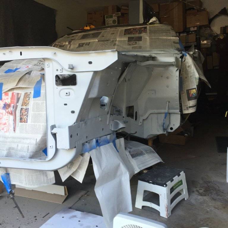

I am thinking of pulling the engine to clean it up and do new seals.
It hasn't been started in about 15 years and I would like to get it running again before I pull it.
Pulling it would make it easier to finish cleaning the lower firewall and frame rails.

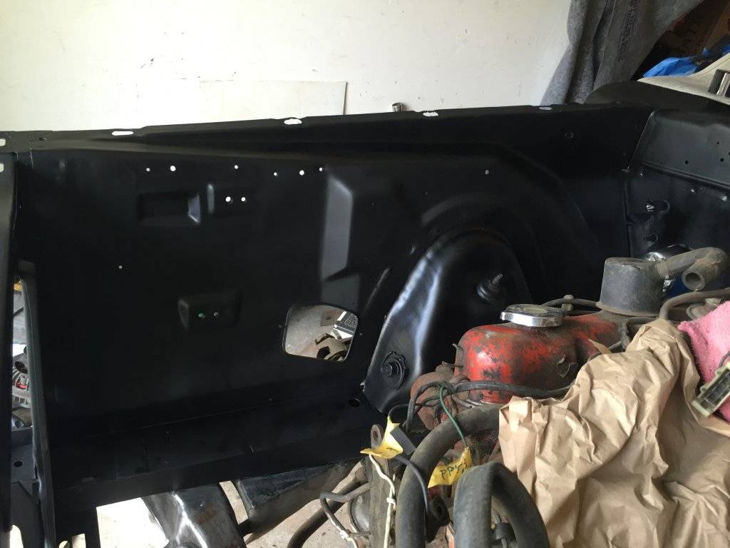

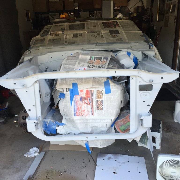

I really happy with the Eastwood Rust Encapsulator on bare metal, prior to epoxy. Engine compartment, and cowl was stripped, cleaned and rust proofed to a nice result.
Also used rust converter with an eye dropper into the hood hinge areas. This seeped in behind the sheet metal and should prevent any future problems with rust.

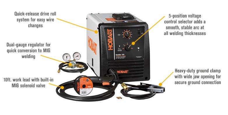

Finally pulled the trigger (no pun intended) on purchasing a Mig/Flux Core Welder
Should do what I need to do on patching the A66 Challenger vert sheetmetal.
Not the most powerful, but runs on 115 volts so I do not need to add a 240 outlet at this time
Purchased from Northern Tool for under $500 and it's made in the USA. (Yes I looked at Harbor Freight, wanted an American made unit.)
Got good reviews and I will see how it welds flux core vs MIG.
I have some practicing to do!
Hobart Handler 140 Flux-Core/MIG Welder — 115V, 140 Amp,
  • Amperage output: 25–140; 20% duty cycle @ 90 Amps, 19V
  • All new industrial cast aluminum drive system replaces the old drive system to add exceptional strength and durability for even more dependability
  • 5-position voltage control selector adds a smooth, stable arc at all welding thicknesses
  • The new and improved heavy-duty ground clamp is made from thicker material, offering improved contact points and a wider jaw opening
  • Built-in contactor and self-resetting thermal overload protection
  • Patented, exclusive 3-groove drive roll makes switching from one groove to another extremely easy, eliminating the frustration for users running small diameter (.023/.024./.025) carbon steel MIG wire for exhaust work and auto body applications
  • 3 groove roll handles 0.024 V-Smooth,\r\n0.030/0.035 V-Smooth and 0.030/0.035 V-Knurled wire
  • Convenient built-in storage area provides at-the-ready access to spare contact tips
  • Includes gun, built-in MIG gas solenoid valve, dual-gauge regulator, gas hose, 10ft. work lead, 8in. wire spool adapter and more

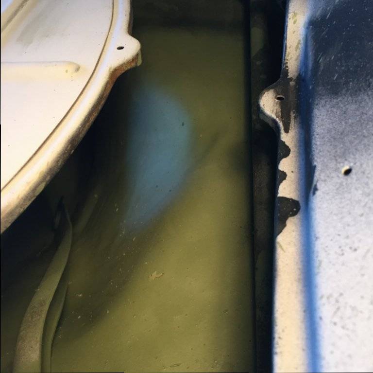

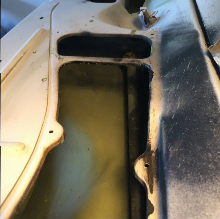

Cowl Rustproofing
Used Eastwood Internal Frame Coating inside the cowl area to rustproof the area.
Stuff has a spray nozzle that sprays a spread pattern. Looks like it worked well and covers/sprays places that are hard to reach. Wanted to make sure the raised vent in the cowl was covered.
Will need a 2nd coat to really rust proof the area, One ugly green color, but it is Full of Zinc.

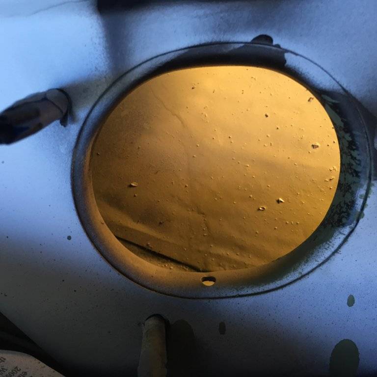

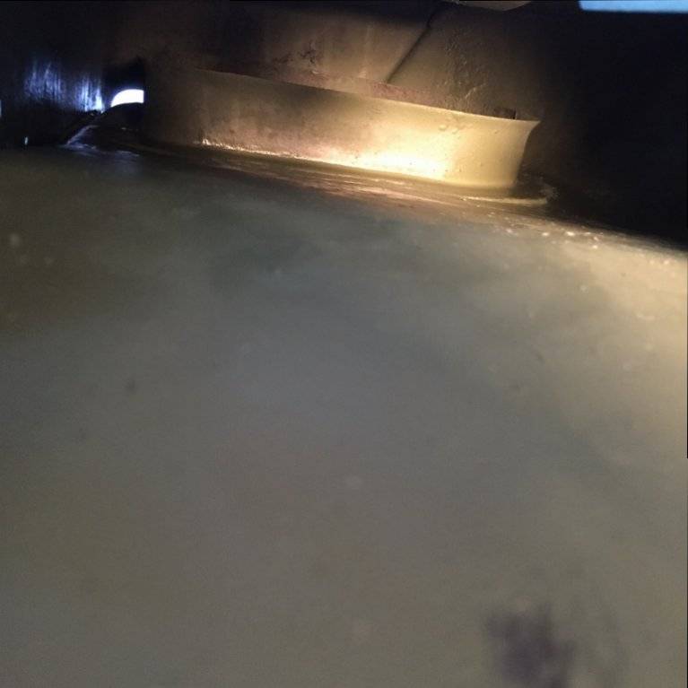

Cowl Rustproofing
