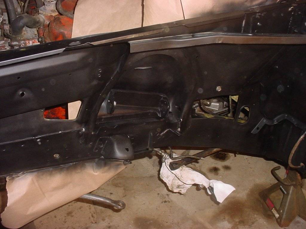

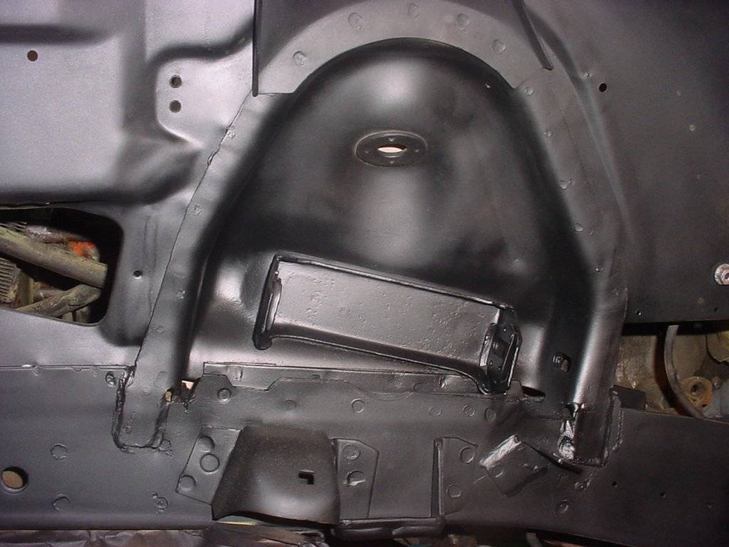

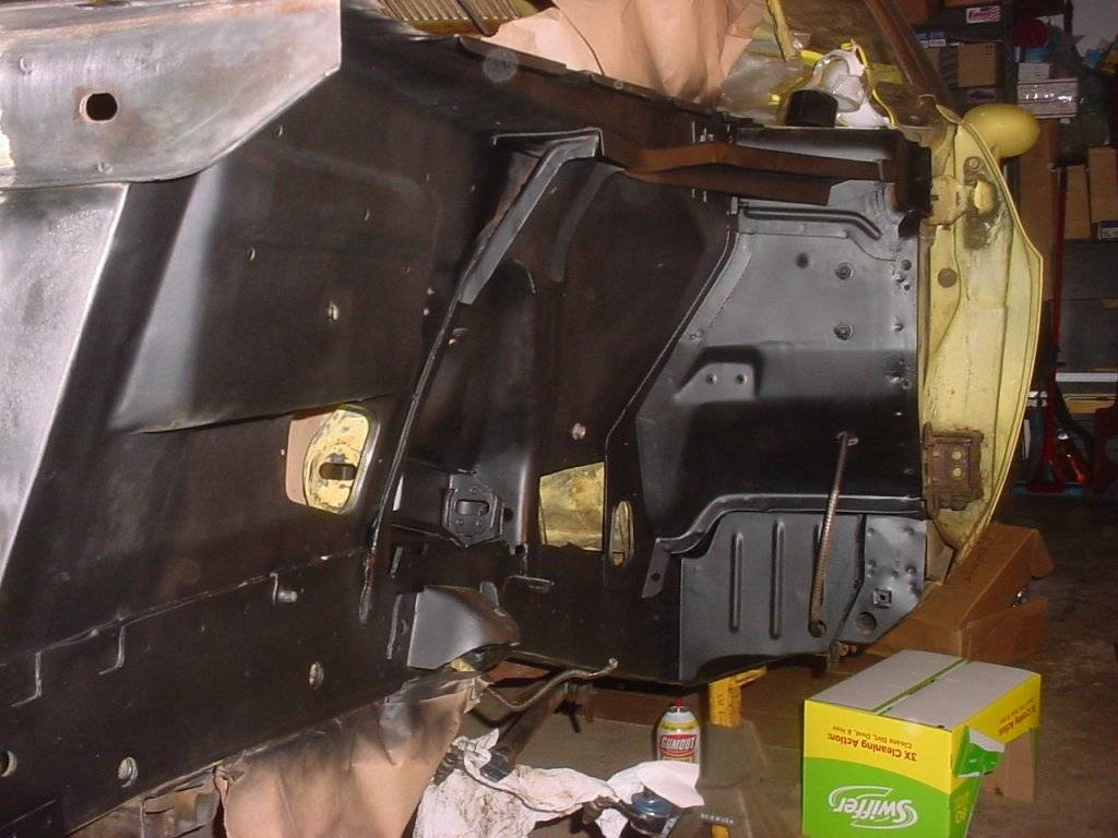

Eastwood Rust Encapsulator
Finished cleaning the sheet metal in the front wheel well, some minor pitting
80 grit to clean up and promote a good grip on the metal
Tried the Eastwood product, and will epoxy prime next
Product seems pretty good, dried hard with good adhesion.
Needs to be scuffed prior to primer
The epoxy should go on smooth.
Happy with the result.

DetMatt1
May 13, 2009
8,123
2,239
Metro Detroit
That looks great. I tried a bunch of different products when I was doing the serious metal work on my '68 Road Runner and the Eastwood encapsulator was one of the standouts both in rattlecan and by the quart.
340challconvert
Feb 13, 2011
5,434
2,917
Parsippany, NJ
Thank you. Very happy with the result of the Eastwood Rust Encapsulator

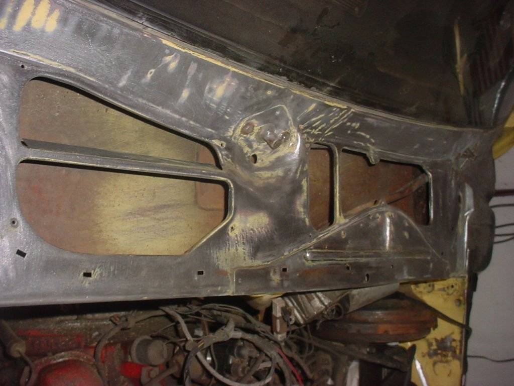

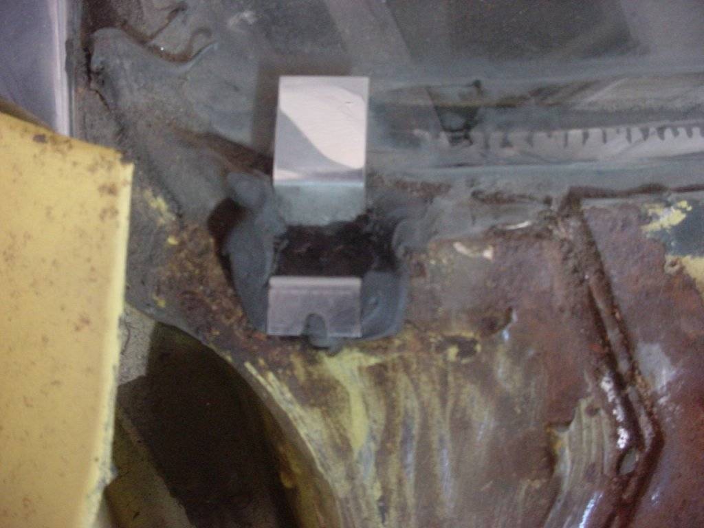

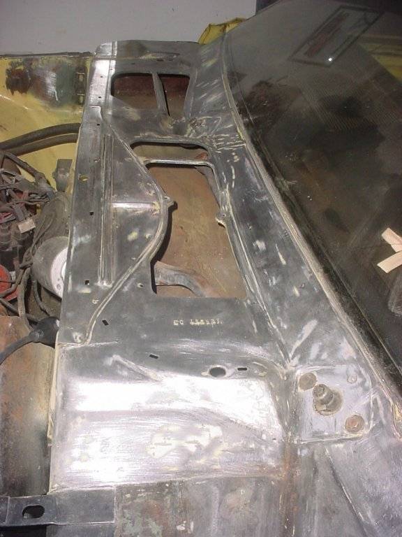

Removed the wide stainless molding at the base of the windshield to start cleaning up the cowl area
Luck again, some pitting, but no rust through. Oddly, the right side is a little more pitted. Will clean up and use the encapsulator again.
I noticed a rubber or plastic wedge at the rt side base of the windshield. I understand that the factory used these to install windshields to hold it in place.
Secondly, there was a chrome clip on the right side base, with the wedge part under the windshield. Again, was this to hold the window in place?
Original windshield, so these items are original factory.

That's classic. The stainless part is from a moulding piece. Looks like they ran out of the rubber wedges and used what was available. The idea was to get the car out so they could go home for the day. Seems it worked.

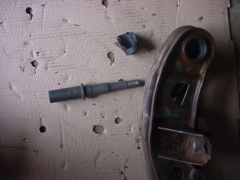

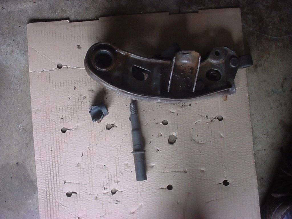

Lower Control Arms
Looked at the cost of a machine shop to press out and repress in the LCA bushing/spindle. Wanted $95 per side
Went to Harbor Freight (hate Chinese Junk) but bought a 12 ton press for a $110 dollars. About 1 1/2 hour to assemble
Worked pretty well in pressing out the spindle and inner shell, also bought a tool from American Muscle to remove the steel sleeve
Will see how well it works? Got this recommendation from another Mopar enthusiast.
"MOPAR Lower Control Arm Bushing Sleeve Remover A, B, E
TECHNICAL SPECS
  • THIS TOOL REMOVES THE STEEL BUSHING THAT IS LEFT BEHIND AFTER THE LOWER CONTROL ARM PIVOT IS REMOVED. THIS SLEEVE MUST BE REMOVED IF YOU ARE GOING TO REPLACE THE RUBBER BUSHINGS.
  • THIS TOOL NEEDS TO BEE USED IN CONJUCTION WITH #23491"
Overall the LCA and old spindle do not look too bad.
Purchased the Suspension kit from PST complete with the new spindle and bushing along with the stiffening plate.
Want to get the front end back together (been 3 months, work goes slow)

Nice work! I just did the upper control arm bushings and ball joints on my Imperial and the lowers are next so I'm glad you posted this. Provided they're the same which I think they are.
340challconvert
Feb 13, 2011
5,434
2,917
Parsippany, NJ

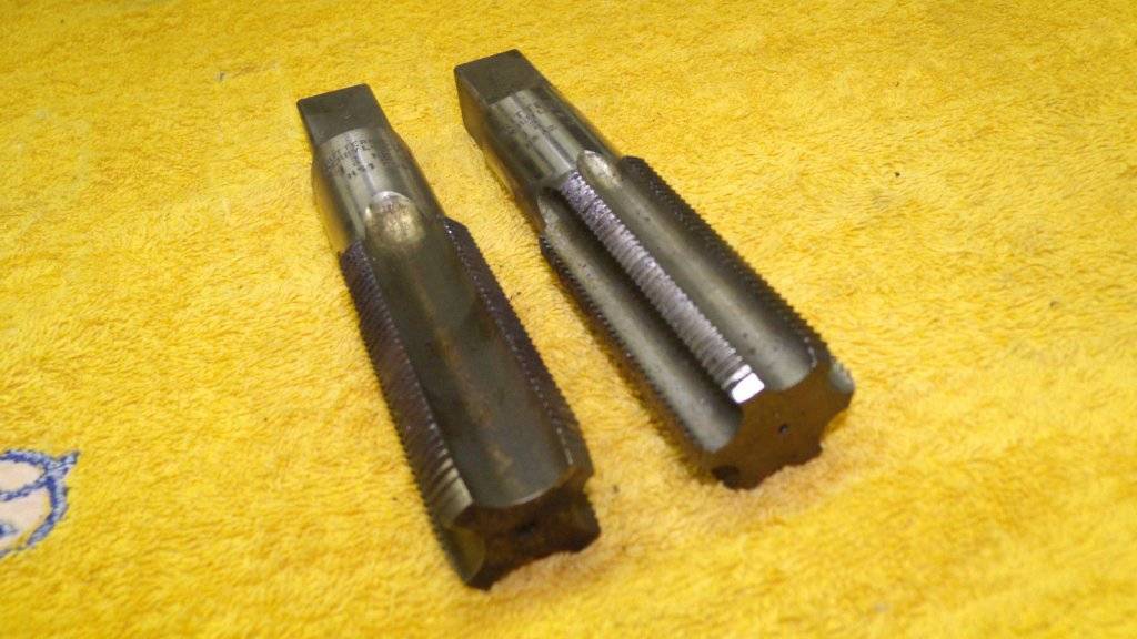

In my research, some mechanics use a 1-3/8 inch x 12 tpi Tap.
Got the idea from hemi71x
It is screwed into the outer metal shell and then pressed out with the press
If the American Muscle tool doesn't work well, this is an alternative way to get the sleeve out.
It was also suggested that it is easier to put the tap into a vice and screw the control arm into the tap.
Either way I want to remove it without damaging the LCA.
Of course there is always the rude and crude, but effective method for removing the Shell!

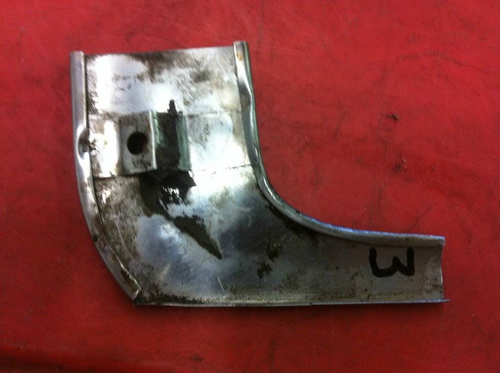

quapman
878
227

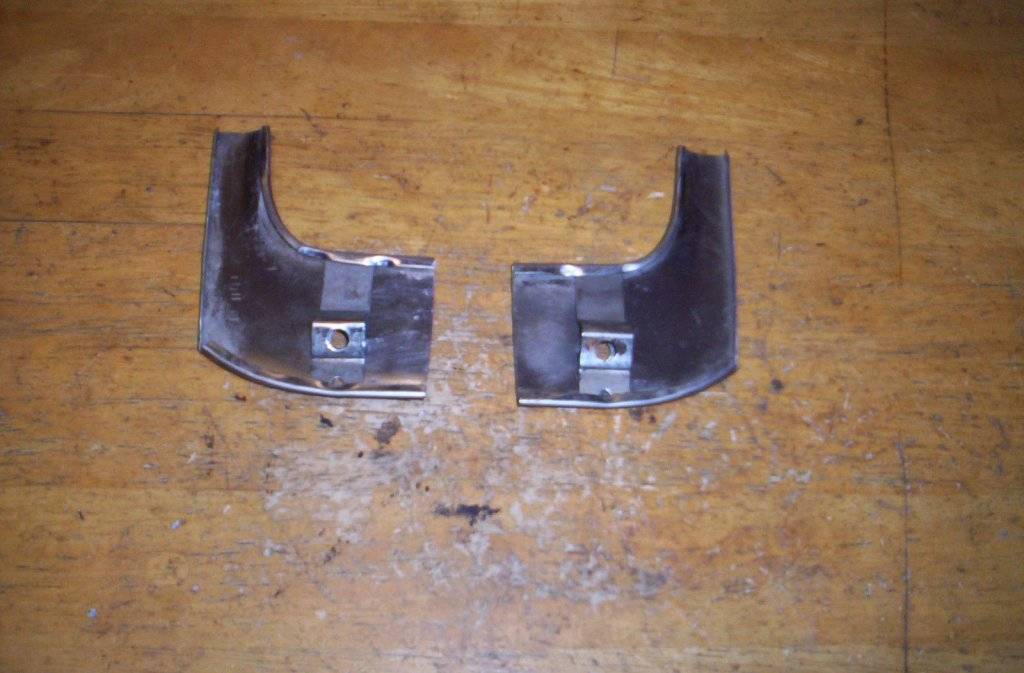

From a few days ago...that chrome clip was probably attached to the corner molding before you took the molding off. 40+ year old windshield goo tends to not let go easily. I doubt it was used to support the glass. The two stainless pieces are not welded (just crimped), so you see this once in a while when disassembling a car. I need pics, but have none (as usual...LOL).
340challconvert
Feb 13, 2011
5,434
2,917
Parsippany, NJ
quapman, thanks for your thoughts
The spacer piece was attached to the wide chrome cowl base with the "goop", on top of the rubber wedge holding the windshield in place
It was not physically attached to the wide chrome base molding, but had a good coat of black sealer holding it to the cowl.
Your pics are the chrome piece that connects to the wide chrome at the bottom and transitions to the thin windshield surround molding. There is also no hole drilled in the piece.
Did not seem to have any purpose, except may be to hold the windshield base chrome molding in a certain position?
The piece is chromed and bent to the contours of the bottom cowl angles
The picture above shows exactly how it was positioned under the molding
Has anyone else ever seen this piece when removing the lower cowl base chrome?
Windshield is original to the car and I'don't believe that the base chrome had ever been removed.
quapman
878
227
Did your original corner piece have a screw holding it on? Sorry, my OCD has me going on this one!
