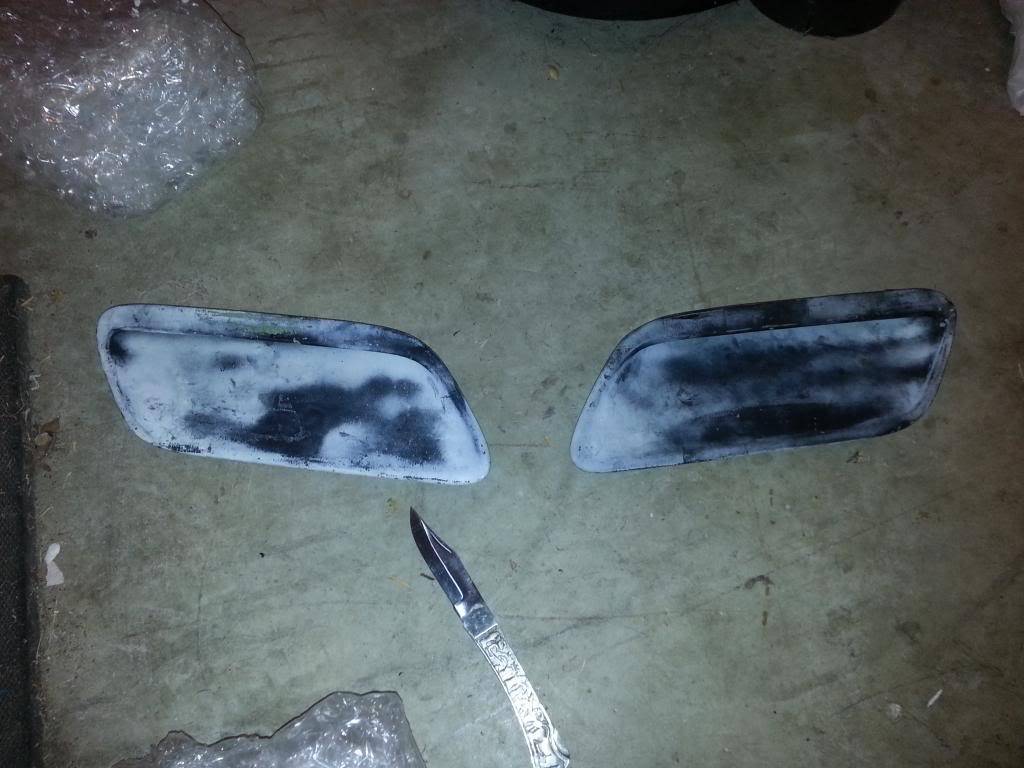

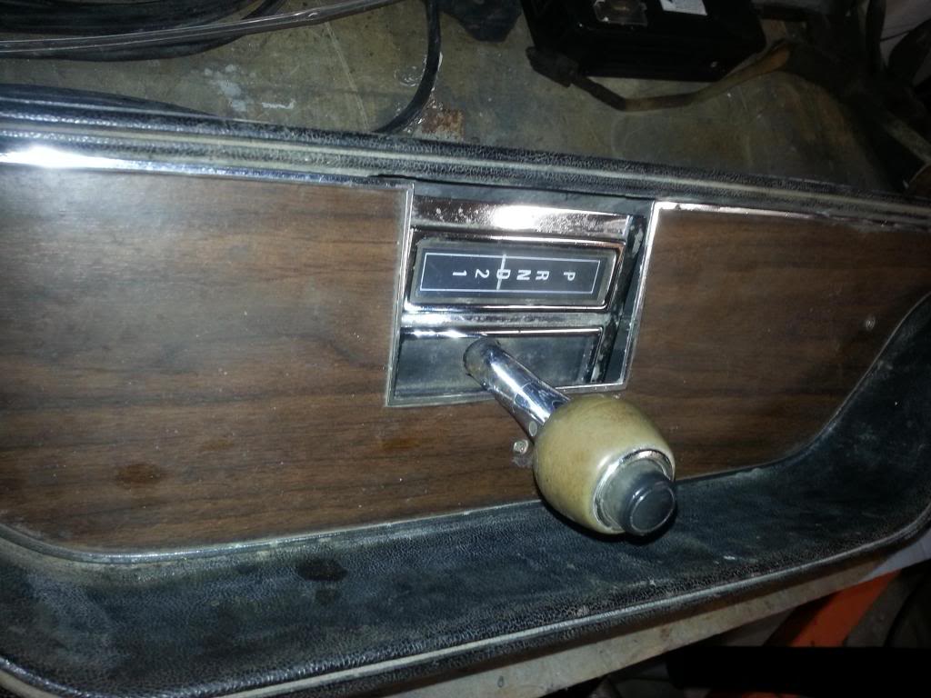

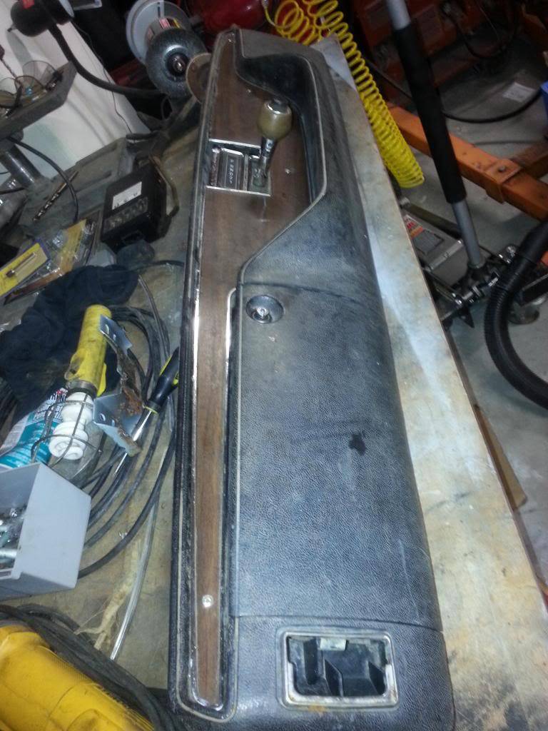

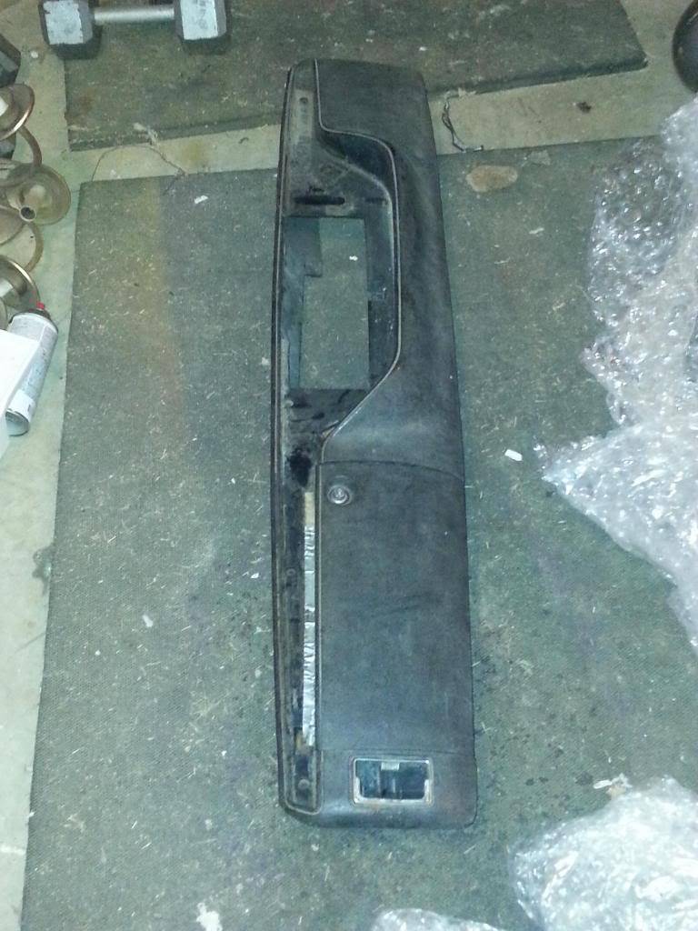

I was able to score a console and hood scoops for the Challenger! I plan on cleaning up the console and painting it green to match the rest of the interior when I get it. I plan to go through Eastwood anyone else use them? I like the fact I can get almost all the interior with one order!

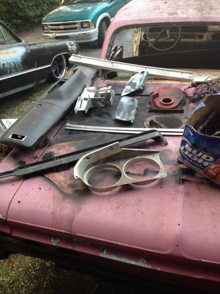

Here's the lot of parts I got from another military friend I didn't get a picture of it separate, but what part is the black piece behind the headlight bezel? It had been so long since he had the car he couldn't remember.

The long piece behind the headlamp bezel is the trim piece that runs along the bottom of the dash. The console will fit but it is for a 71-74 Challenger. 1970 is different. Instead of an ash tray in the rear of the console, it is a place for the seat belt buckles to rest in.

Looks like all those parts are sitting on an old Impala. Finally a useful purpose for all that mass of chev# metal. lol

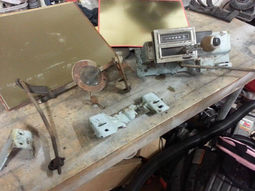

Here's the Shifter and linkages, I didn't take pictures of them blasted yet. I need to make some space in the garage!!

Hey guys looking to find out how to go about mounting my console brackets?? I guess I could mark the holes on a 2x4 and mount them to that then weld them in.... I still have to drill the hole for the linkage, luckily that's easy to spot!!
