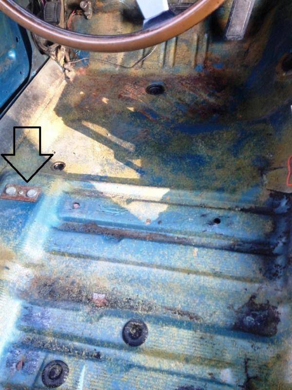

Dec 18, 2015 #1 J jimclo2002 Well-Known Member Joined Mar 11, 2014 Messages 71 Reaction score 0 Location atco,nj can someone help with this question Just about finished with the install of the floor. Please see photo... what is this for under driver seat? What does it hold?

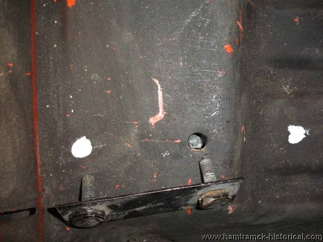

Dec 18, 2015 #2 340challconvert Well-Known Member Joined Feb 13, 2011 Messages 5,199 Reaction score 2,745 Location Parsippany, NJ Six way seat bracket I think that is a bracket for the support brace that goes under the floor for the six way drivers seat tracks.

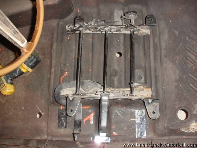

Dec 18, 2015 #3 340challconvert Well-Known Member Joined Feb 13, 2011 Messages 5,199 Reaction score 2,745 Location Parsippany, NJ 2nd pic

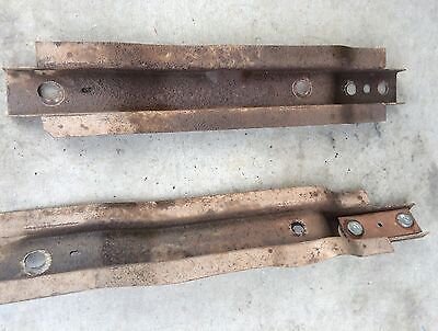

Dec 18, 2015 #4 challenger6pak Well-Known Member Joined Feb 27, 2011 Messages 4,037 Reaction score 897 These are the braces.
