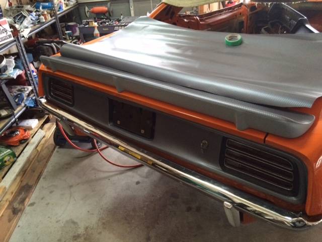

OK, made a little progress today. 470 is moving along, need to send off to 440 Source for some parts, bead blast the Torker II, size and order the push rods from Manton, make plug wires and get my flywheel and install my clutch and transmission. Easy-peazy, friends came by last night and partially wrapped in the AAR spoiler and fixed a couple other small items. Ordering some mat black in stripping and then blend the AAR with the 3M carbon fiber wrap. Should look pretty slick. Here are some photos.

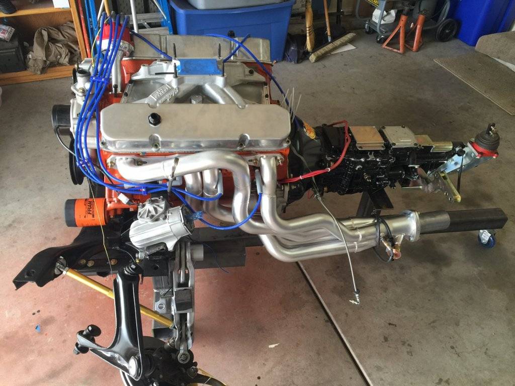

More progress - Got the TKO all bolted up, Wilwoods on, plug wires completed and a lot of the little stuff. need to order lifters on Monday, Jegs parts run also. Bought a Denso kit from 440 Source, should be here for next weekends events. Need to finish running fuel lines and system, check some brake lines and I believe I can slide err under there.
Next is dash - just need to do it.
Cazbah362
Feb 3, 2012
218
28

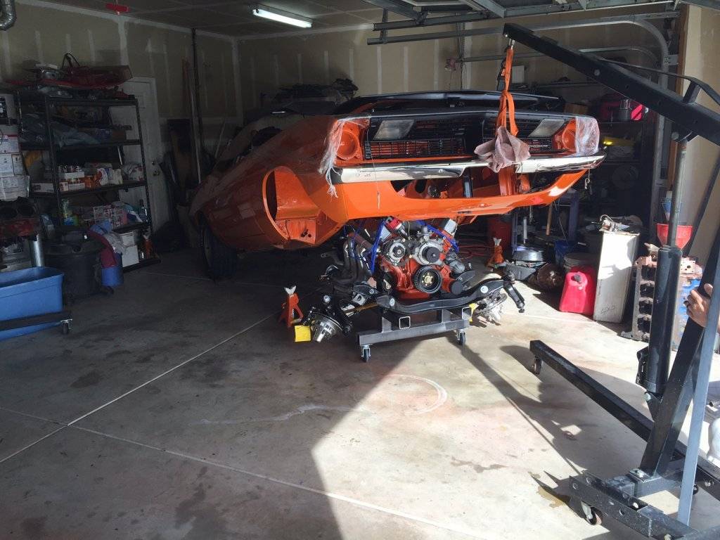

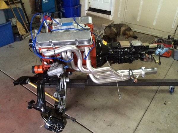

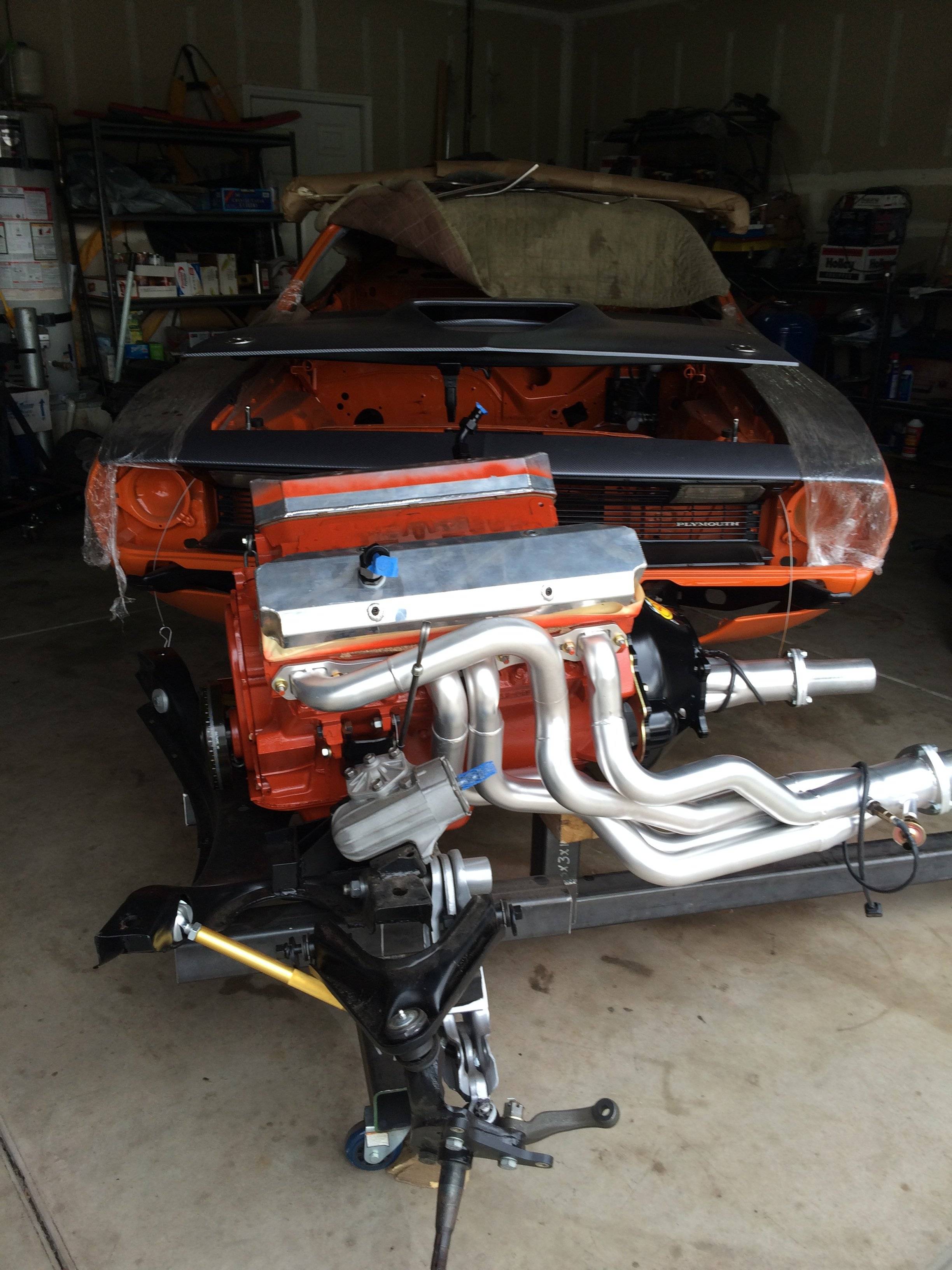

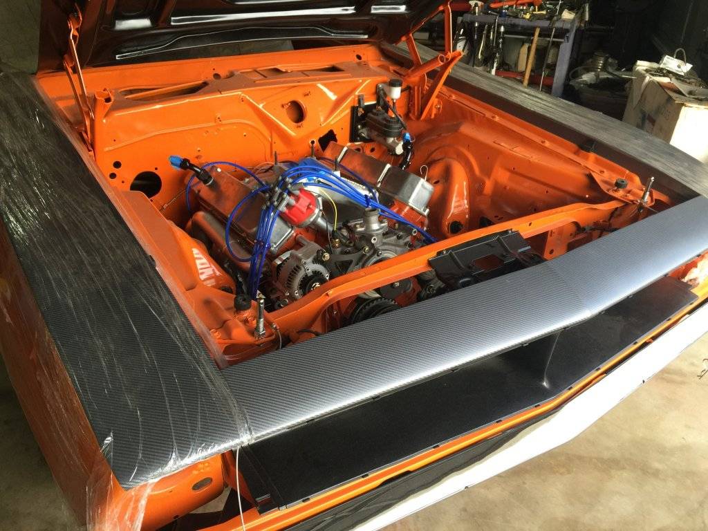

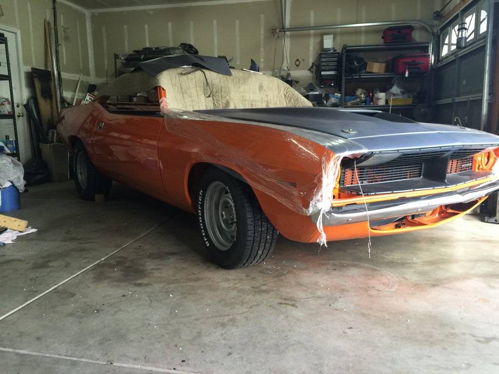

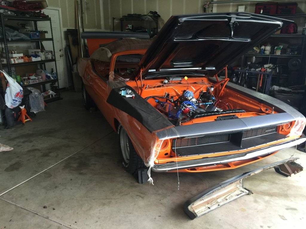

Well made a little bit of progress on the Cuda. Went to MATS last week, not overly impressed, but did grab a few things. Progress has been slow, lots of work, travel and family. Well progress is we slid the engine and transmission under the car, pretty straightforward with an engine cradle. The TKO lined up perfectly in the factory 4 speed hole, thanks Silver Sport. I have hit a bit of a wall, thoughts of selling or trading are hitting my brain, so....
Here are some pictures

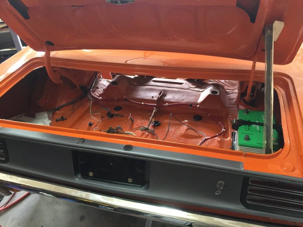

Completed a few more things this weekend, seems we are moving along. Ran power to the starter relay, fuel pump and ignition system. Tested all these out and they work as advertised. Also ran all the fuel lines and tested them, love the smell of fuel in the garage! Had to fix a leak or two, but fuel to the bowls, so this is done. Pulled the dash pad from the frame, remove the VIN and preped it for shipping to Just-Dashes. Also, installed temp and oil pressure gauges, they will go into a custom dash frame.
So here is the plan for next weekend: purchase oil, prime, charge battery, set/check all the timing for pre-fire and - BOOM, fire her up. Since the dash will be off and away, I will work on the gauge cluster, dash frame and steering column.
What I did learn was not wire tie things together until the end. Wasted lots of them, but helped shape and find better "wiring routes" for many of the systems. Also, when something is hot, usually means a ground is needed somewhere. Here are some photos

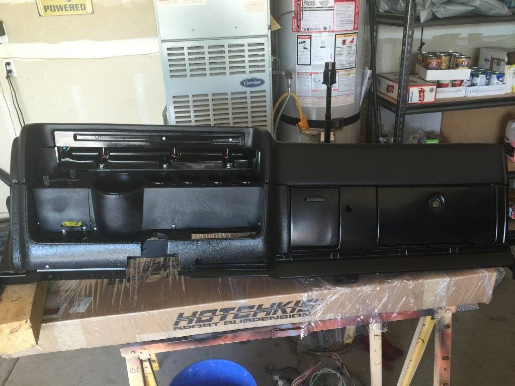

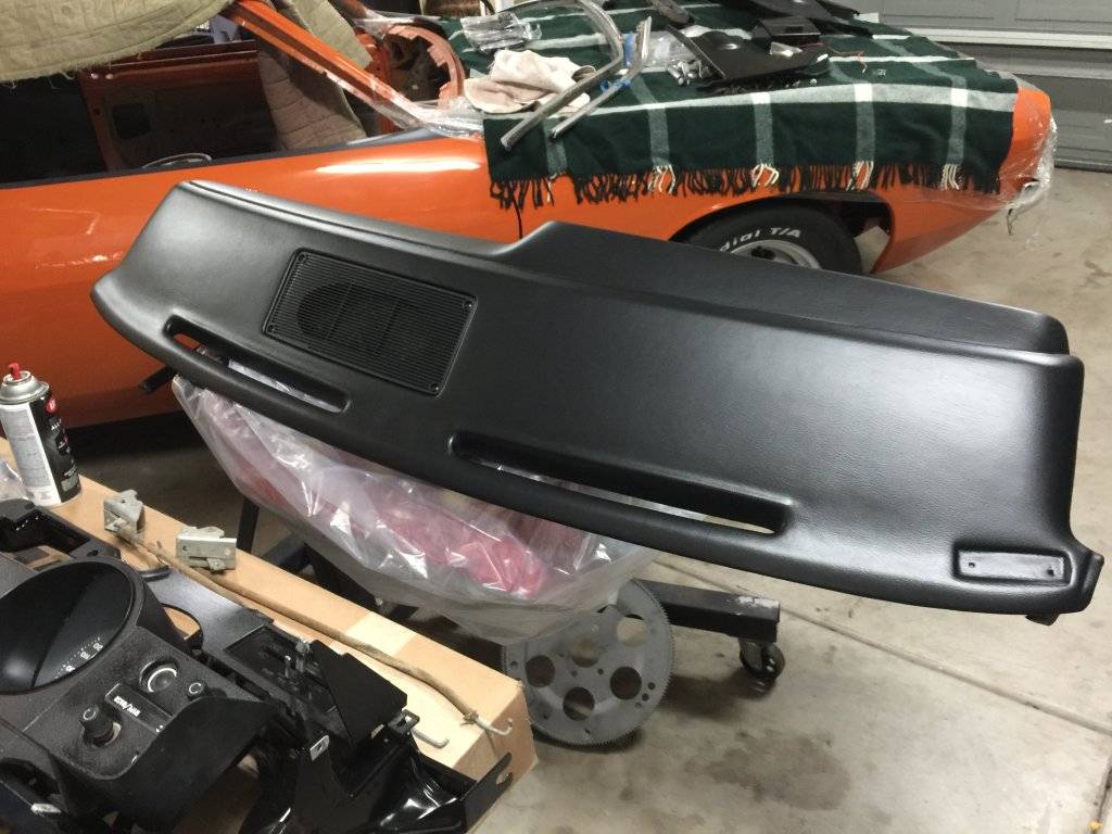

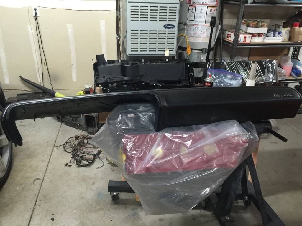

Received the dash pad back from Just Dashes - Wow, nice work - expensive, but again very nice work. I had the frame, box and ashtray powder coated as well. Will start assembling this week or next..

Well, I have bled all the brakes and clutch. While doing this, I noted the master kept leaking around one of the fittings. Come to find out the aluminum had a small crack and was never going to seal. Purchased a new Wilwood master, installed and now no issues.
Also, I spoke of using dual fuel regulators. Real issue was a kinked return line. With the high pressure pump, it was literately popping regulators. After a little research, I found a small kink right next to the pickup/return line. After fixing that, adding more -8's and better aligning the fuel lines, down to one regulator at about 7.5 lbs. Much better.
Put on full 3" TTI exhaust with an H pipe, very nice
I spoke of the Denso alternator - now that is a cool system. Prior to installation, I was just charging the battery. Once I put the alternator on, it immediately started charging the system. Note, I have very rudimentary wiring at this time, so pretty cool it worked right away.

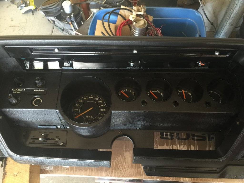

As for wiring, like I said dash has returned. I sent the dash off in mid May and it returned August, that was a four month delay I did not anticipate, and $1,500 total (shipping, chrome "Barracuda" and new speaker screen). Also, during this time I had all the dash part powder coated and ordered a solid state gauge regulator. I was going to use new Autometer gauges, but old ones are perfect and well I am a cheap @$$. No, just trying to stay on budget and drive it, these can be done later along with fuel injection.
So with the new dash et-al, I will be using the factory wiring harness. Before installing, I am going through, checking and testing. Noticed some age, cracks and some "hill-billy" splicing which will be corrected, nothing bad, just age and experience. This dash is the next large focus.
