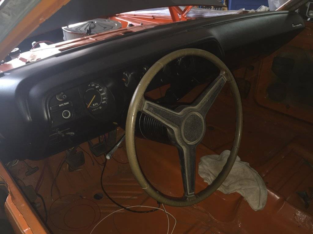

Made a little progress this weekend by installing the dash system, heater box and steering column. All bolted up with no issues, now just need to take the time to finalize some small details. Wiring needs to be finished, Autometer gauges installed inside, and engine harness installed. Looking forward to driving this beast, just need to find a seat, adjust the valves and we are off.

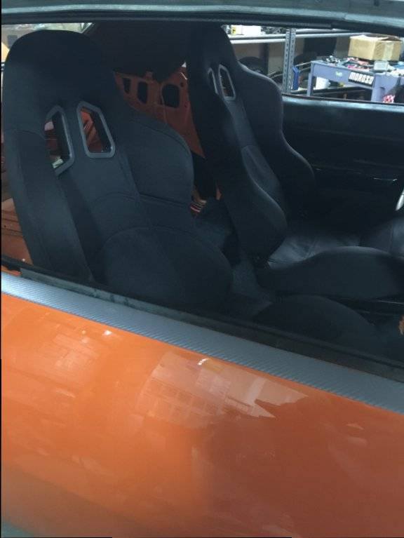

Well I said I was going with racing seats - here are some budget ones installed.... I found them on CL with brackets, sliders, frames and seats. I had to chop, cut, and rebuild the frames, but made it happen. I am happy I bought budget for this test, they ride a bit high. I did lower the frame (a lot) when I rebuilt them. Can't imagine keeping the "recommended height". One pro/con is the sliders - with them height would be perfect.

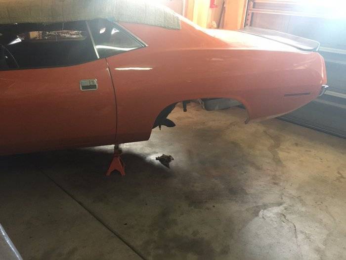

Well made the first drive during Thanksgiving Day! Made it around the block and idled fine in the driveway. Still a lot of work to do. Also installed the headlamps and the 1/4 glass, and identified some other shortcomings. Discovered the little 741 also has a Sure-Grip with possible 391 - unexpected. So here is a video:

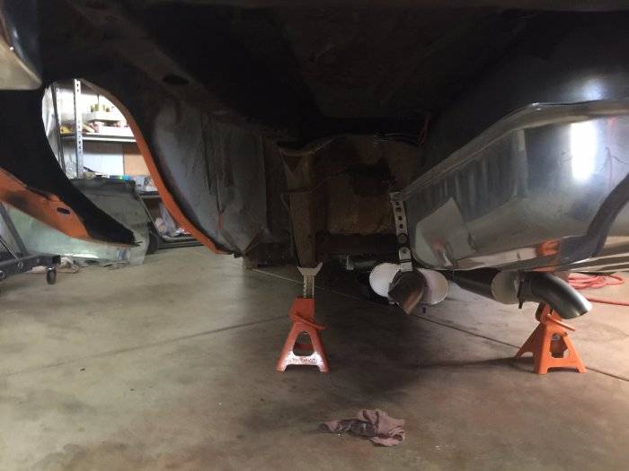

Started correcting issues on my list so started focusing on the cars rear-end along with some of the issues I has having. This week I removed the older rear-end awaiting parts such as leaf-spring kit from ESPO, front shackle kit from AR Engineering, a new Dakota Digital (DD) rally dash.
With this progress, I can add the dual exhaust hanger from TTI for the driver side. I was going to weld it in but, found out through another thread that it bolts in. Fix the fused shock which is hard to get with a rear-end in the way, better align the rear bumper and detail the under half area a bit more.
DD will help with correcting some of the wire gremlins such as gas gauge, volt meter, dome light and tach. Also will look nice, or should.

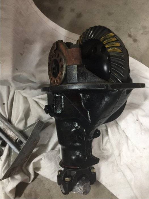

Right now 489 is rebuilt with spool and 410's, axles have new green bearings, and banjo is awaiting a wash and paint job. Will update the punch list once these little projects are completed.

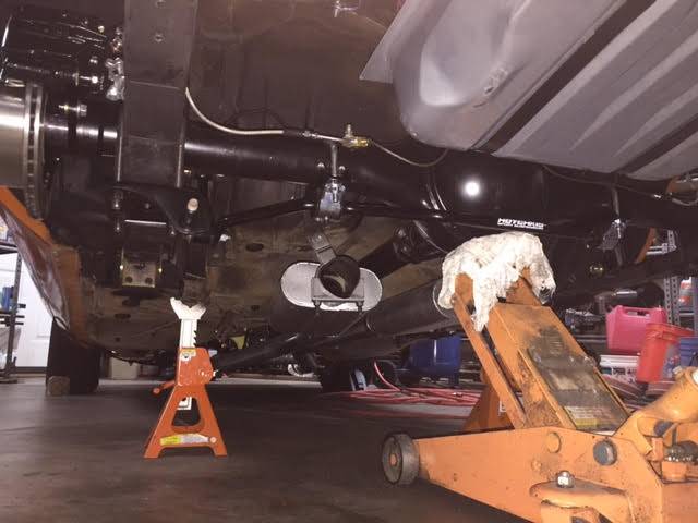

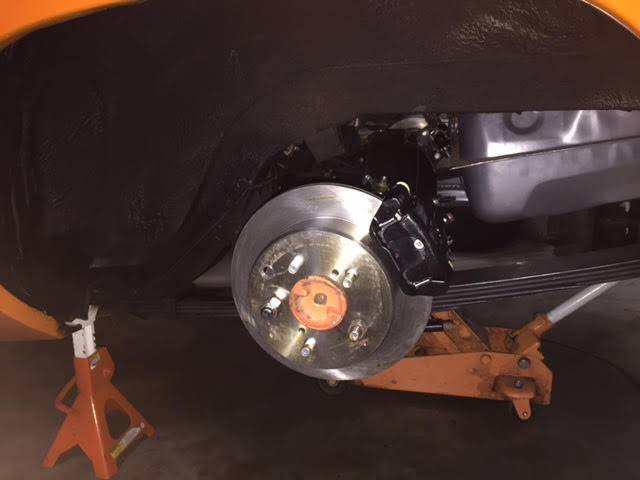

Made a little progress over the last week. Most of my energy has been focused on getting the rear-end pulled, rebuilt and back in. Pretty much only thing which is original now is the banjo and axles. The 741 was swapped for a 489 with 4:10's, spool, crush sleeve eliminator, and a 1350 yoke. For brakes I went with Dr. Diff's smaller disc kit, awaiting the e-brake cables time of this post. Leaf springs I purchased through ESPO, replaced all the shackles and hangers. Front hanger supports I beefed up with AR Engineering's heavy duty with backing plates. The axles received new green bearings and disc studs, nothing to great, just nice to have. Everything I could have powder coated satin black was done, really turned out nice. The nice upgrade I did was add the Hotchkis sway bar. Since everything was out, it was much easier to weld in the required brackets and set it all up. This weekend I ordered Calverts 9 way adjustable shocks. These, along with the E-brake cables should be here next weekend. This will allow me to fix novice double-flare brake lines, weld in tangs for the disc conversion and bleed the brakes.

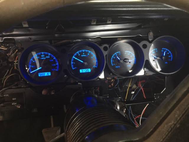

While I wait on parts, I installed Rob Yules head light relay kit. Kit went in pretty easy, no issues but it make me realize my front marker light/drive light wiring is frail, broken and needing to be replaced. This will another project, and probably after I get it road worthy before spring. However, it did lead me into doing a partial amp meter bypass and head me into starting my Dakota Digital (DD) install.
Since I had the dash out, I started running all the sensors and related wiring for the DD install. Right now I gave the TKO's VSS, oil, fuel, and temp sensors wires run to the general location for the control box. Finding a nice easy access place for the box is my concern, this is a "general" location for the time being. Tomorrow brings another day. What I need to do is pay for a Rallye Gauge bezel, which I already have with a complete Rallye Gauge system on hold from a friend.

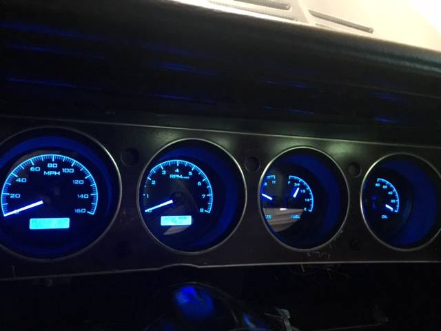

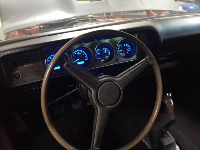

So got going on things today and have the installed the e-brakes, bled the brakes and worked on the dash install - oh and shoveled a lot of snow. I have finished wiring in all the senders for the DD dash and bolted it in. Did a quick test fire with it and got all the gauges excluding the speedometer working, speedo needs to be out driving to configure. Here is a quick photo, very impressed with the DD, easy setup.
Also, yesterday installed the Calverts shocks and set them in 5. Now we need the snow to go away so we can drive, check and finish things. And I need to stop procrastinating on seals and the door glass (no fun).

quapman
878
227
That DD dash is the bomb! and it's cheaper than if you bought new stock type rallye gauges or had them rebuilt. Really liking this car!

Cazbah362
Feb 3, 2012
218
28

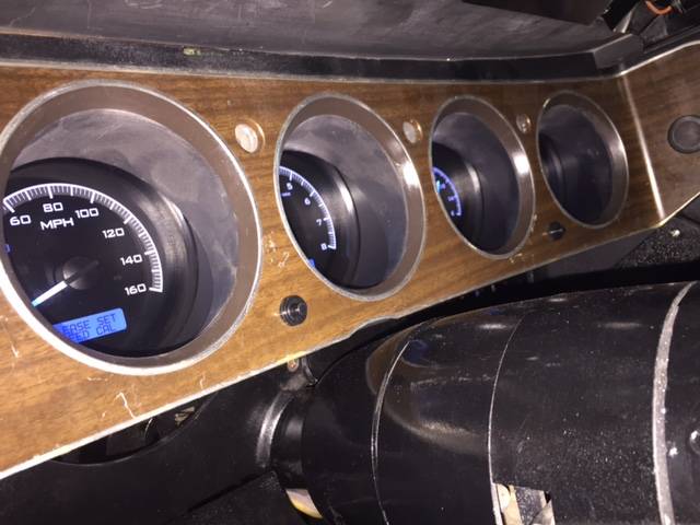

Well work on things this weekend, still procrastinating on the door glass. But got the door seals installed, rear end buttoned up and the dash finalized. My friend came through with the dash, nothing perfect but it was nice enough to install, but not perfect enough I needed to worry about drilling the setting's switches into them - Can you see them????
quapman
878
227
That's pretty damn nice. I see they put the buttons where the 70/71 reset knobs would be. How do you adjust the brightness of the gauge lights?
