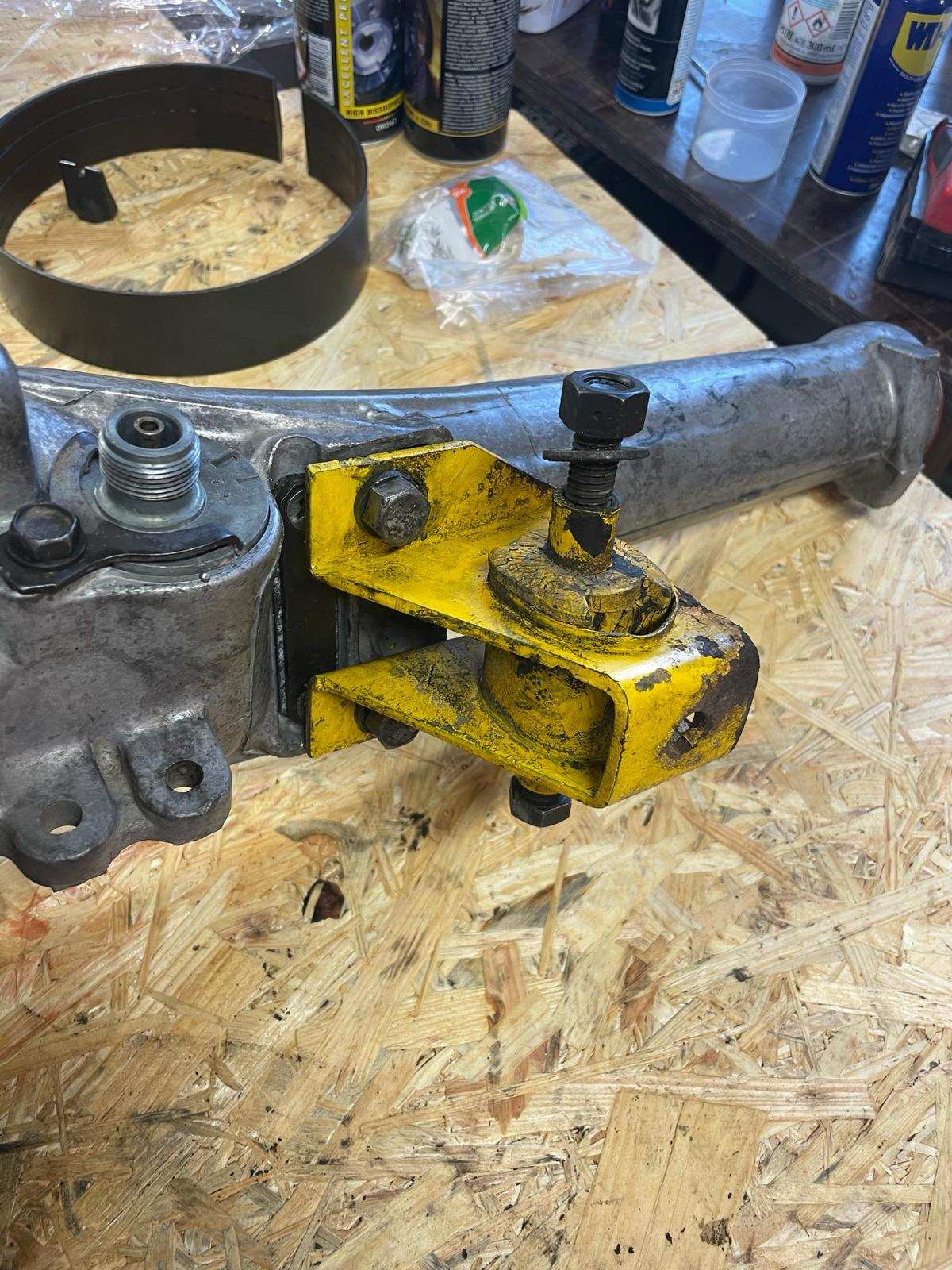

I am currently changing wear parts on the gearbox, as well as all seals.
Is this yellow transmission mount correct for this car?
And where can I get a new one? :)
Or was the yellow one for hemi and 440-6?
And I also need thicker snap rings for the first and rear clutch...
Where would it make sense to buy?
I need one 0,088" and one 0,106" snap ring.
