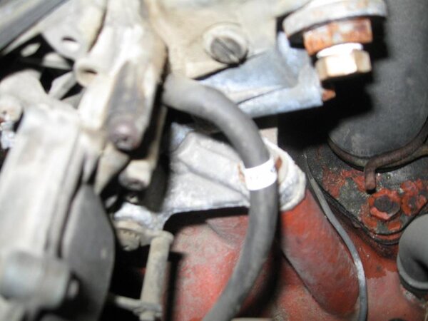

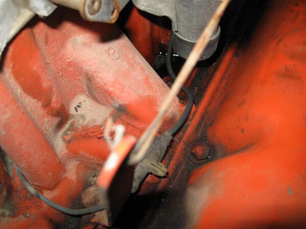

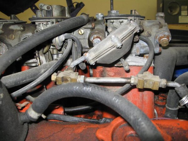

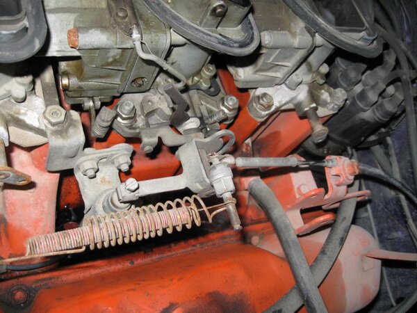

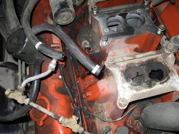

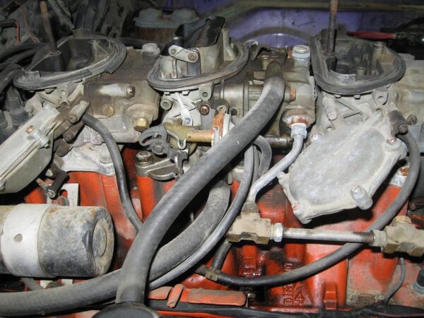

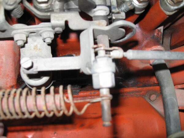

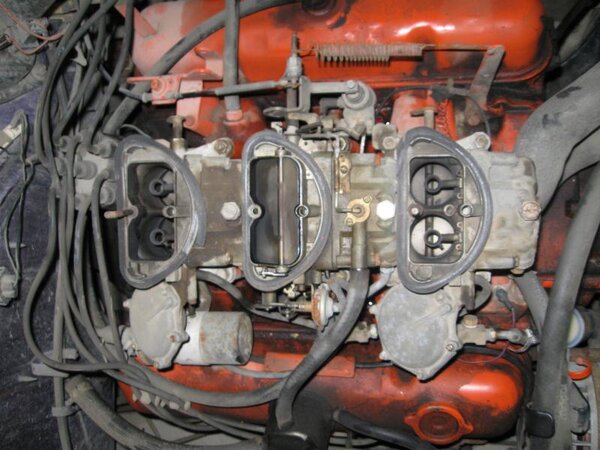

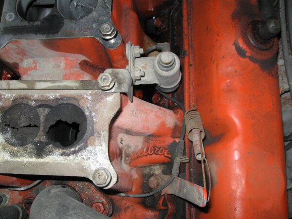

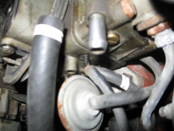

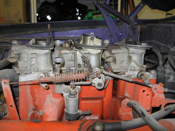

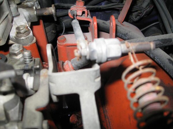

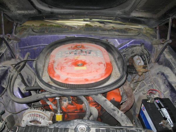

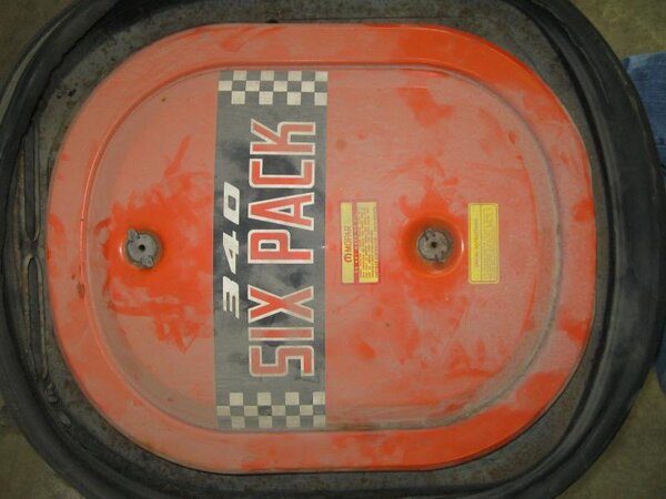

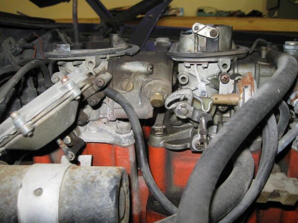

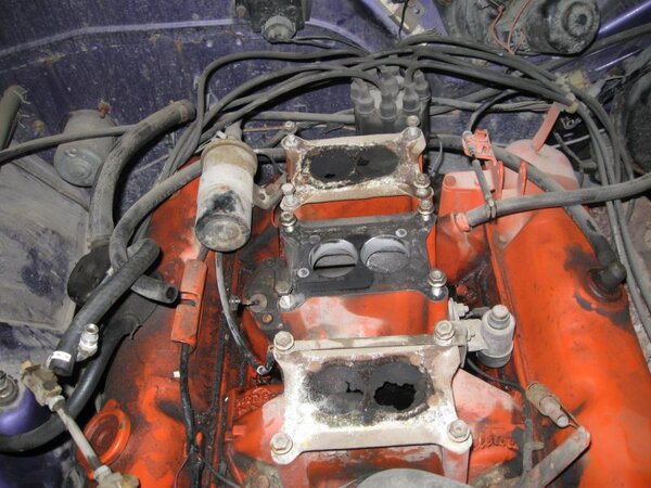

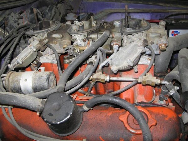

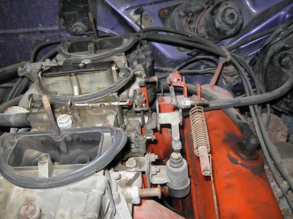

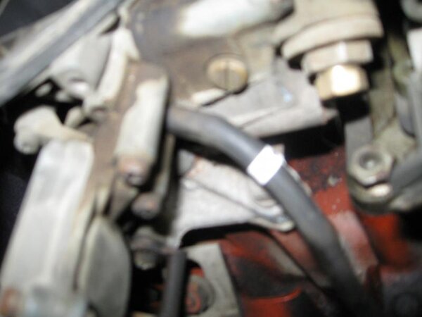

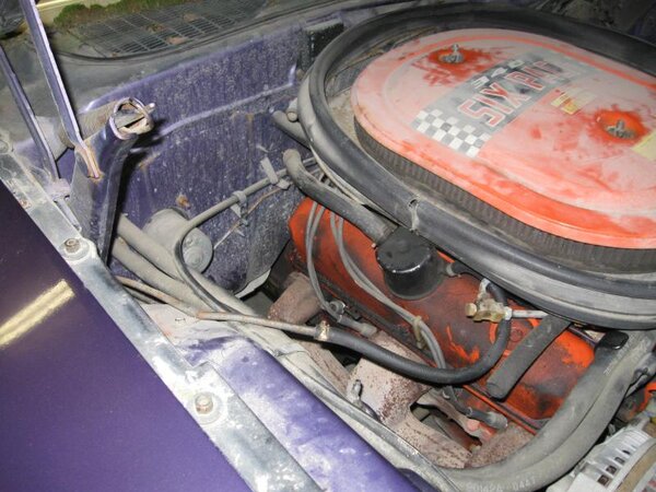

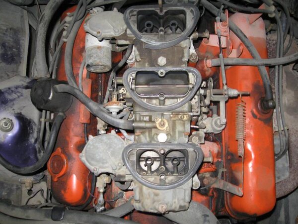

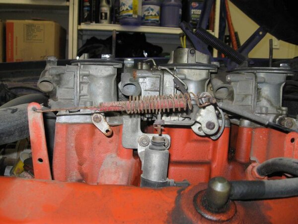

Well to start this off, I will back up a bit. The six pack setup was in much need of repair. The outboard carbs were disconnected when I got the car. The carbs leaked fuel, and had lots of carbon build up. I sent the carbs off to Eric at Vintage Muscle Car Parts. Super cool guy, and I've seen his restoration work, and WOW is all I can say. Looking foreword to seeing mine in a few weeks. Here's the Pics!! IMG_0047.jpgIMG_0041.jpgIMG_0040.jpgIMG_0037.jpgIMG_0036.jpgIMG_0018.jpgIMG_0016.jpgIMG_0015.jpgIMG_0014.jpgIMG_0013.jpgIMG_0012.jpgIMG_0011.jpgIMG_0009.jpgIMG_0008.jpgIMG_0007.jpgIMG_0006.jpgIMG_0003.jpgIMG_0002.jpgIMG_0001.jpgIMG_0010.jpgIMG_0005.jpgIMG_0004.jpg
Im wanting to send it off, but due to living in Alaska, its difficult to get the car there. Its to big of a risk to move the car in the winter. I wont be able to commit the money for the restoration until spring next year. So since at that point I would be put on a waiting list. I was quoted a year wait, then 30 or so months to have restoration completed. So In the mean time Iam going to get the car ready for summer. My plan is to make the car mechanically sound so i can drive it while Im waiting on the list. Lucky for me, I know a guy that has restored a few of these cars, ( one of his was a Pink Challenger, 1 of 5) and hes giving me a lot of incite on my car. In fact he is the person who bought my car and brought it from California to Alaska and used the car as trading material for another challenger he did. My car is so clean, with most all original parts, minus the paint job, that I think I can get most of the car done. Im starting with mechanical, Rebuilding the 4 speed, rebuilding the 340 T/A six pack engine, brakes, and a few cosmetic items. So I guess what Im saying is Im just going to keep on keepin on, and enjoy this chapter in my life, learn a lot cool stuff, and with the help of you guys, I hope to drive this car this summer and cross the restoration bridge when it comes. I know that I dont want to hurt the 340 in the car, so I will rebuild it, and keep it on the stand until the restoration comes into play. I think im going to build up a 408 stroker, and keep the original in tact. I would hate to have something happen to a numbers matching block, since it is a T/A block also.

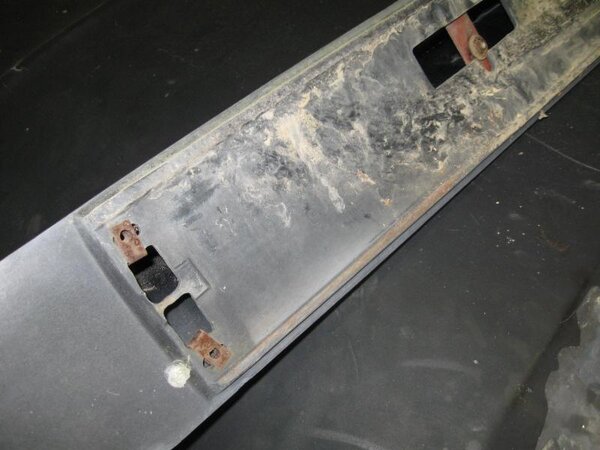

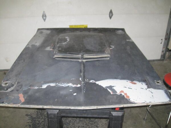

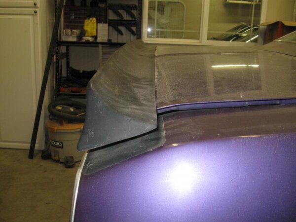

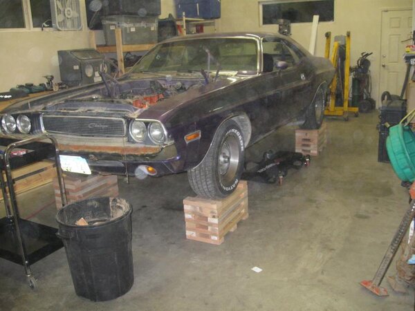

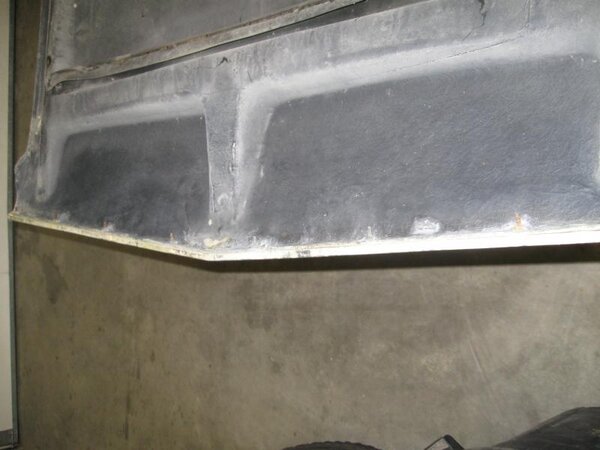

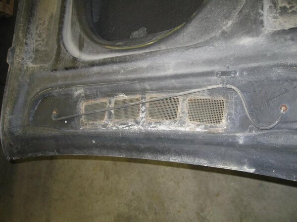

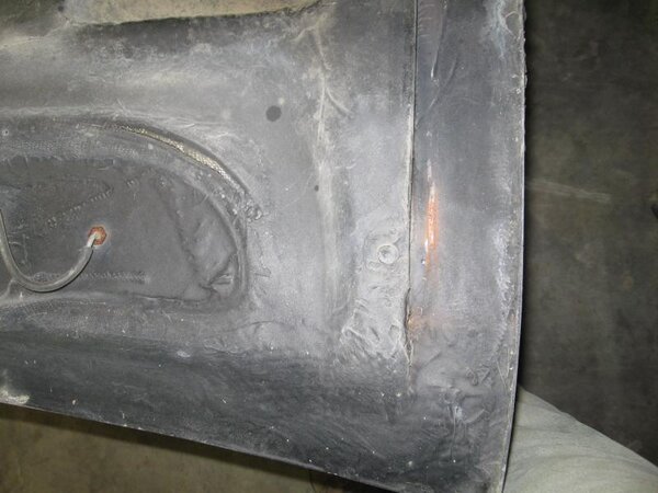

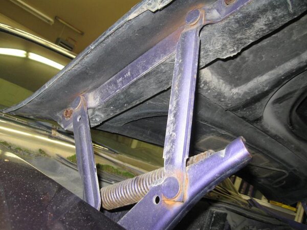

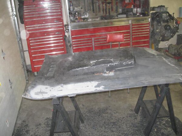

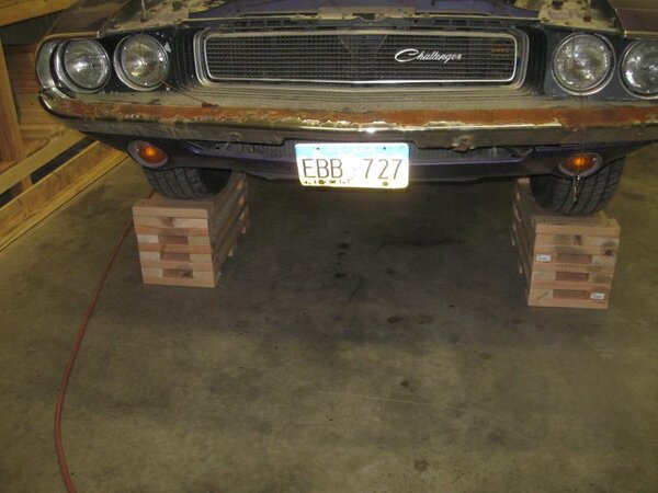

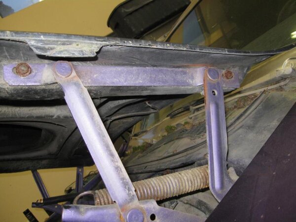

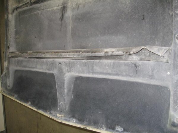

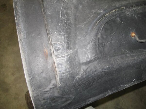

Well here's some pics of tonight progress. Not to much, since the transmission needs some TLC, I didn't want to use my jack stands, due to height, and may need them for something else, I built up some cradle stands. They are easy to make, and hold a ton of weight. They are 12" wide by 24" long. So far they are great. I pulled the hood off, and started stripping the paint. I'm about 90% done with that, I will finish up tomorrow. Well that was it for the IMG_0051.jpgIMG_0050.jpgIMG_0049.jpgIMG_0048.jpgIMG_0052.jpgIMG_0053.jpgIMG_0054.jpgIMG_0063.jpgIMG_0062.jpgIMG_0061.jpgIMG_0060.jpgIMG_0059.jpgIMG_0058.jpgIMG_0057.jpgIMG_0056.jpgIMG_0055.jpgIMG_0064.jpgIMG_0051.jpgIMG_0063.jpgIMG_0062.jpgIMG_0061.jpgIMG_0060.jpgIMG_0059.jpgIMG_0058.jpgIMG_0057.jpgIMG_0056.jpgIMG_0055.jpgIMG_0054.jpgIMG_0053.jpgIMG_0052.jpgIMG_0048.jpgIMG_0049.jpgIMG_0050.jpgIMG_0064.jpgdays post, now here's the pics!!

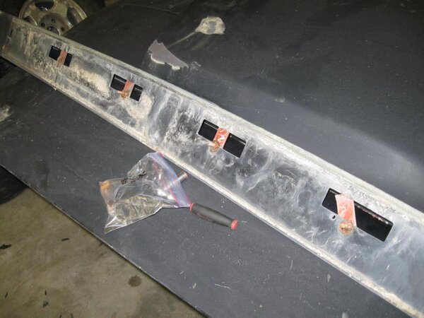

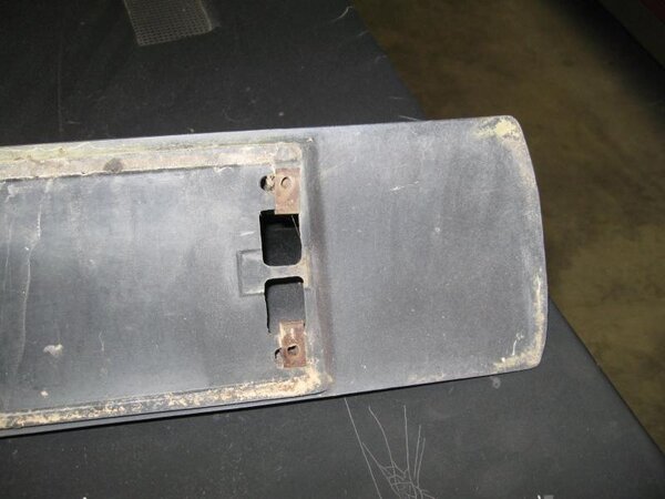

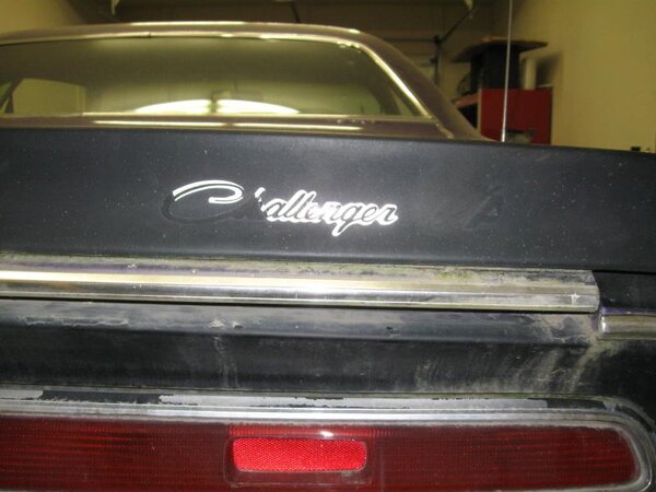

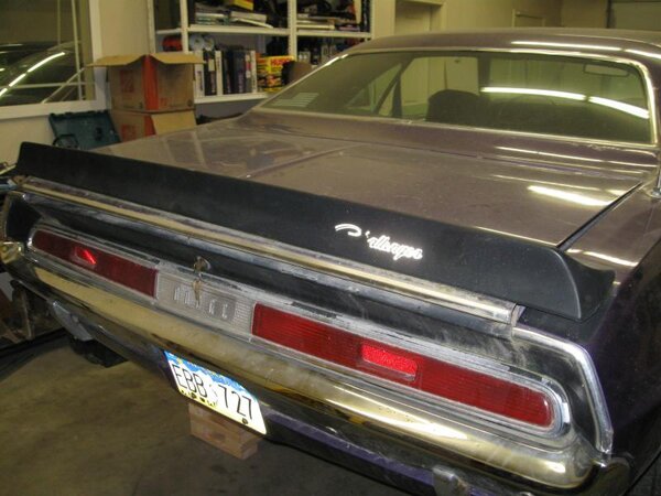

Nice, make sure to get plenty of photos. You'll want a shot of the blackout on the decklid under the spoiler and how it extends to the taillight panel. This is a detail that is often missed on T/As during restoration.
For sure. I will take that pic when we do the body work. Im trying to build up the courage to sand and spread filler on the hood, was wanting to shoot primer and paint, but I really dont think a rare hood like that is something to practice on. We will see though. As far as hood color, i found the paint I want to use from Eastwood. The bummer part is that I cant get it shipped because it would freeze before it got here. I love living in Alaska, but sometimes its a pain.
I've restored a couple of T/As. They are my favorite. I've owned 5 of them starting in 1979. Just like any fiberglass part, you want to be careful about sanding through the jell coat. Just sand off the top coat. The original paint was called organisol black. A rough textured finish. It was originally laquer paint. It is a difficult paint to spray because of the texture. If you don't get the pressure and the approcah just right you'll get "stripes". I would just clean up the hood, prime it, and have someone in the bodywork trade apply the paint for you. Then, look at the results in the sun or good light to see if you are happy with it.
Well, all I did was scrape the old paint off the hood. I took the hood and rear spoiler to my buddies body shop. He's been doing paint and body for 45 years or so. Figured I would be better off with him doing the filling and painting. We are going with a urathane, with a flatting agent added.
i think you will be satisfied with that choice! lacquer does not age well and is not available at any of the jobbers i deal with. and with 45 years at bodywork he knows what he is doing
todays materials are far better than what came on these cars when they were new. when this man started out acrylic enamel and acrylic lacquer was the big thing. and clear coats were unheard of accept in acrylic lacquer
