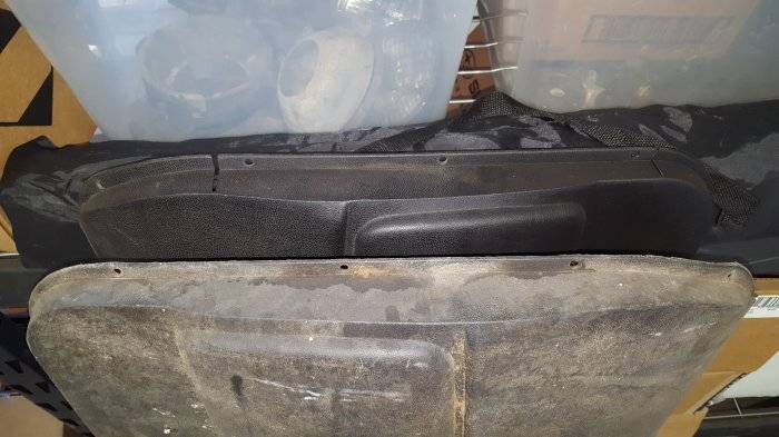

1970 is one year only. The difference is that there are 2 slots cut at the top and bottom of each end (4 total) to allow for fit around the upper and lower curves of the door structure (see photo showing the 1970 panel with slots vs. a 1971-4 panel without.) You can easily replicate the slots by carefully cutting them in at the right locations which should help them fit properly. Other than the slots, the rest of the door panel is identical cosmetically. Hope this helps...
