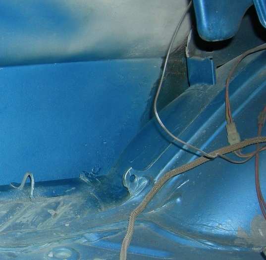

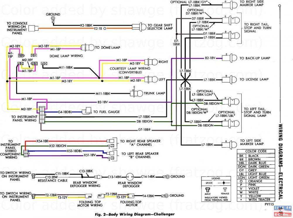

This car came with a light package which includes a steering column
mounted light for the ignition key, ashtray light and trunk light. I
found part of the rear harness for the trunk light, but I don't know
if it's all there or where the switch mounts in the trunk. I cannot
find the switch either.
Can someone help me with some pictures of this setup. Possibly of
what the switch looks like, where it mounts in the trunk and a pic or
two of the complete trunk light wiring harness that plugs into the
body harness.
Many thanks if you can help!
