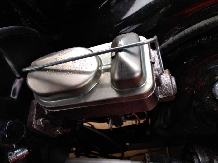

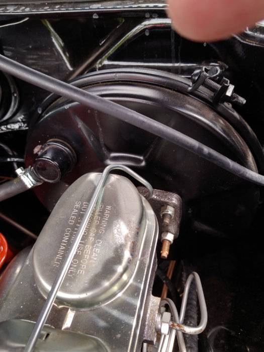

Do you have a bolt on master cover? Like to see a pic of master and booster w brake valve under.

I will print off the link sent by paharamia and check out the Ramman on YouTube. I have taken some pictures and will try and see if there are any numbers on the master

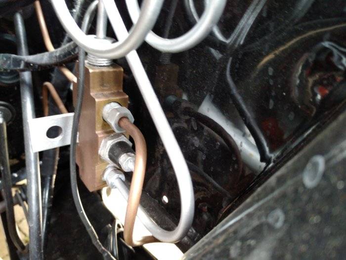

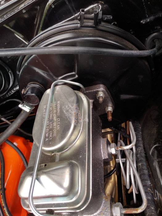

Looks like the correct booster
and master. The brake valve may be wrong. It should two separate blocks. Maybe I am nissing it in the pics?
Yes, I looked at mine. That silver bracket in your pic holds another block. Look at my thread customer service.

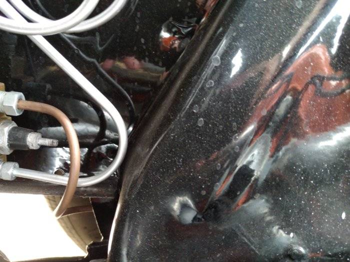

It does look like the factory 1971 booster w a replacement master cylinder.
There should be a proportioning valve and a distribution block under the master cylinder. Also, is that a flared copper brake line in your picture? Copper expands at a different rate then steel when stepping on the brake. If it is, not good; metal is much softer then the steel brake lines normally used and should be changed.

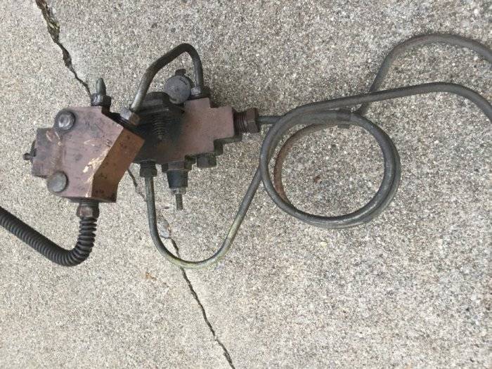

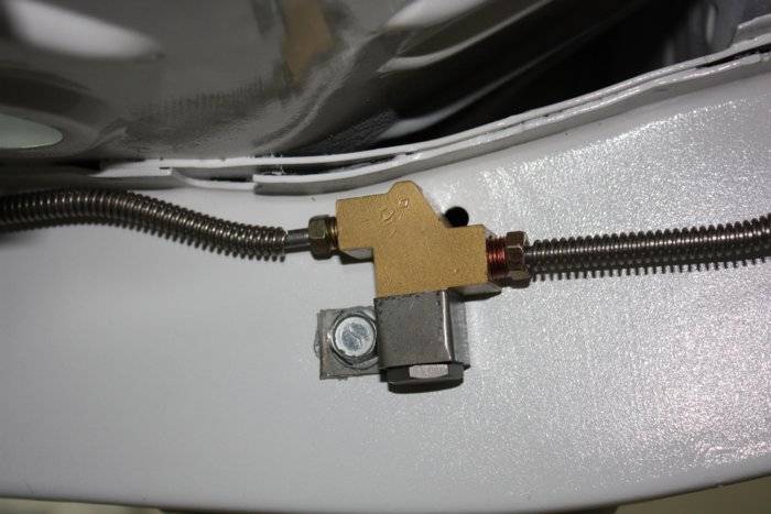

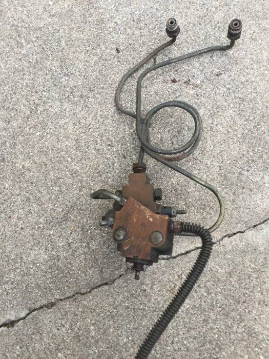

I attached pics of the original brake valving on my 70 A66 disc brake Challenger and the brake junction valve under the driver's side rail. I have the two piece brake line from front to back axle. (Some e bodies had a one piece)
