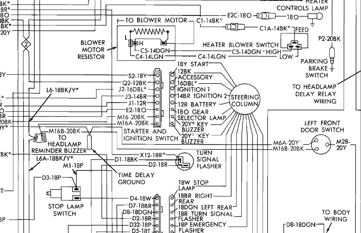

Would anyone have a pdf of the dash schematic? I need just a close up of the two flat connector interfaces that go to the steering column that shows the wire gauges on the dash harness side, particularly;
S2 Start
Q2 Accessory
J2A Ignition
J3 Ignition
J1 Battery
Thanks in advance! Needs to be 1971.
Thanks! Confirms that a the wires are the same gauge as the 70. I used a 72 harness since they upsized some...probably for good reason.

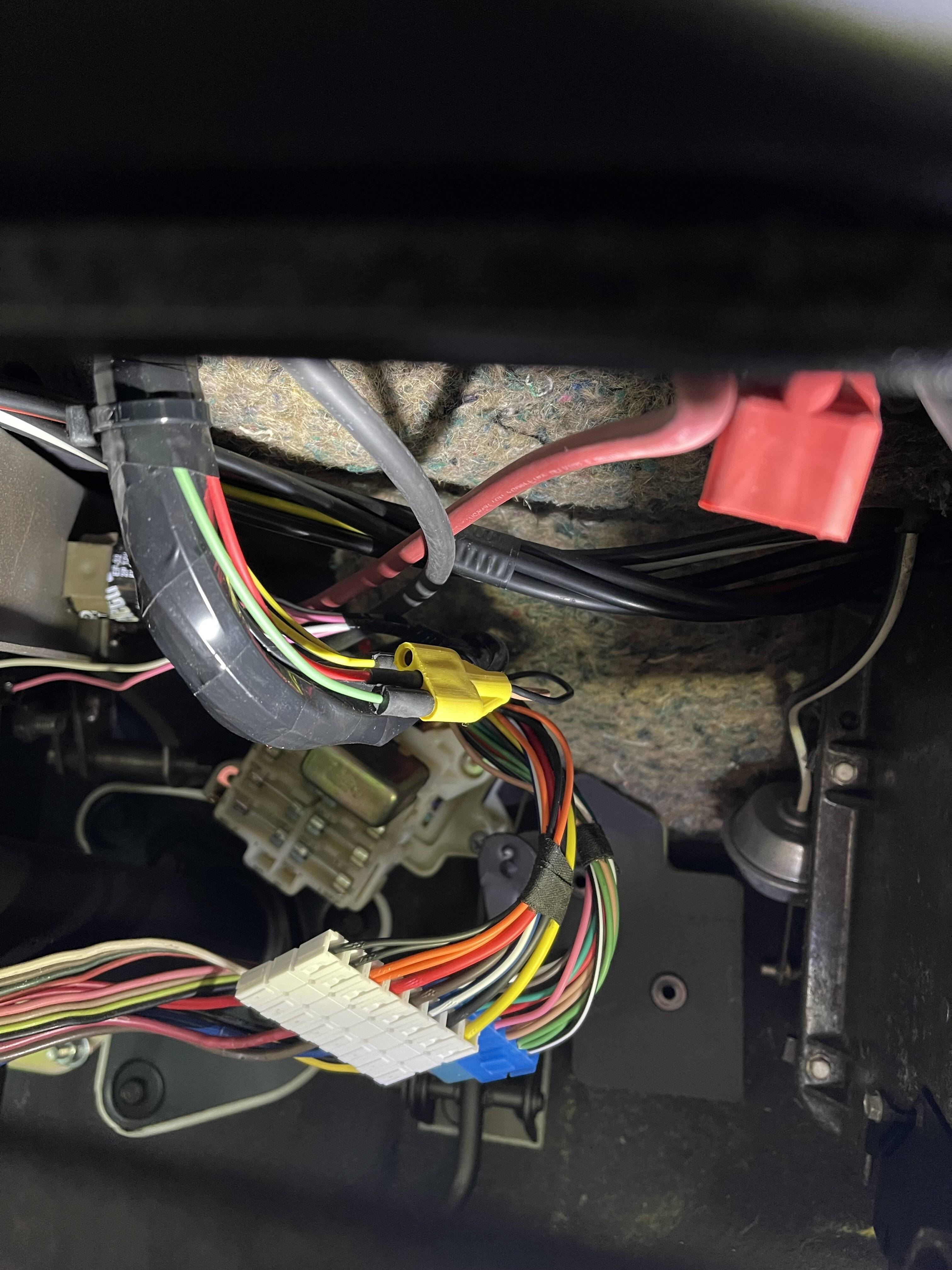

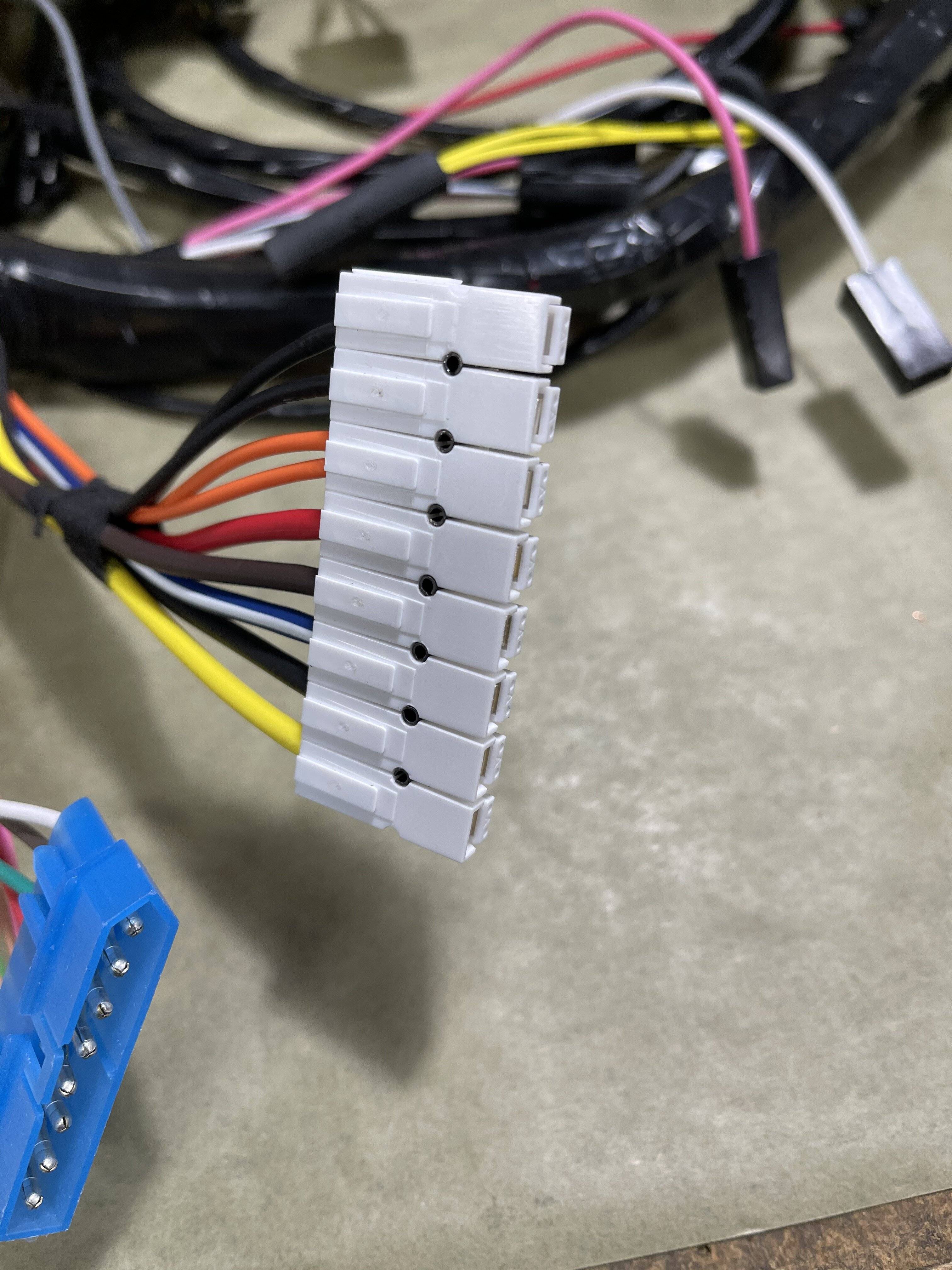

Yea, all ignition related dash harness wiring went to 12 gauge by ’72, I’ve seen some later replacement switches where a couple runs were 10 gauge on the switch side. Funny, they never really addressed the real weak spot, the Molex terminations that are way current under-rated for that application. Many Molex heat related terminal failures at that connection since day one. I replace the ignition switch Molex with Anderson PowerPoles on my builds.
Agree. Nice upgrade.

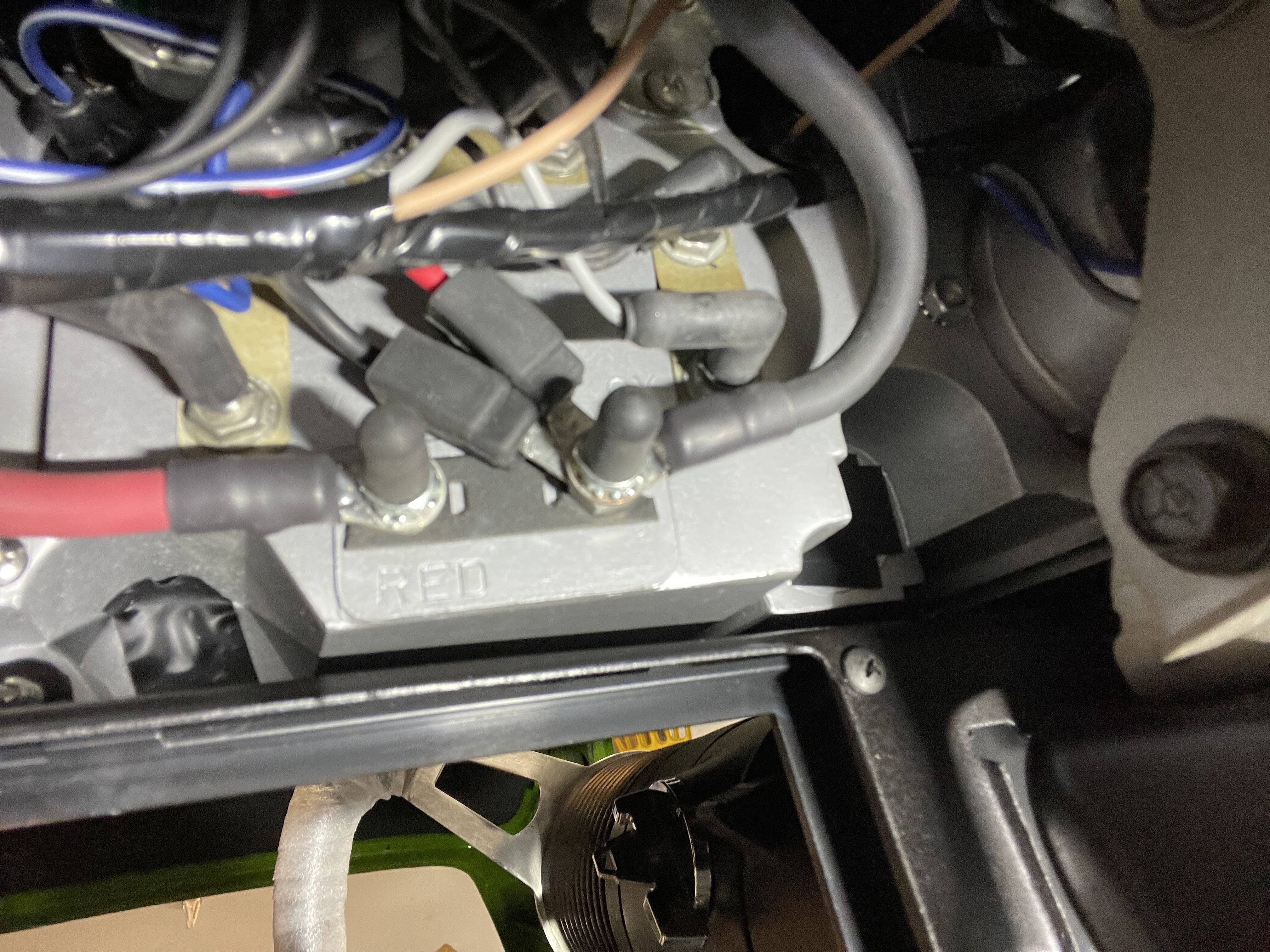

I like the 71 B body schematic that shows the firewall connector bypass harness for bigger alternators. I might consider that.
By all means, by-pass the bulkhead connection for the charging system wiring. In the second shot above you can see the 8-gauge (red & black) charging system bypass wiring. I will un-wrap a new M&H engine harness and replace the 12ga alternator output wire with an 8ga, routed directly the ammeter via a added firewall grommet. Yes, on b-body fleet production with 65 amp alts, the factory did the same thing.
Thanks again. Will prob do something similar thru one of the factory grommet locations.
