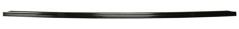

Chryco is correct, but 70 Challengers only had a metal filler panel that screws in below the tail light panel. 71 Challengers tail lite cover panel flaired out, deleting the need for the filler.
I ordered one for my 70 from AMD $59.99
Part number 975-2570
Bumper Fillers | AMD 975-2570

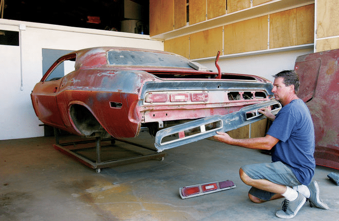

Does anyone have a picture of this filler panel mounted and/or dimensions to mount it?
The reason I ask, my '71 Challenger was rear-ended in '72. Minor damage, dented the bumper, trunk lid. I had the local dealer repair it (big mistake). Fast forward to now, the car was disassembled and media blasted for restoration. There are no tell-tale signs that there ever was the filler panel mounted there. I don't doubt that the dealer was too lazy to replace or reinstall it, but there are no apparent holes that have been filled in or other evidence that one ever lived there.
To add more confusion, I have read a debate on a related forum that '71s may not have had this filler panel since the bottom of the tail-light panel flares rearward toward the bumper........????

Info; Thanks to challenger6pak
The 71 does not have the rear filler panel, so no holes. That is 70 only. The rear tail light housing in 71 flared at the bottom to form a bumper filler.
