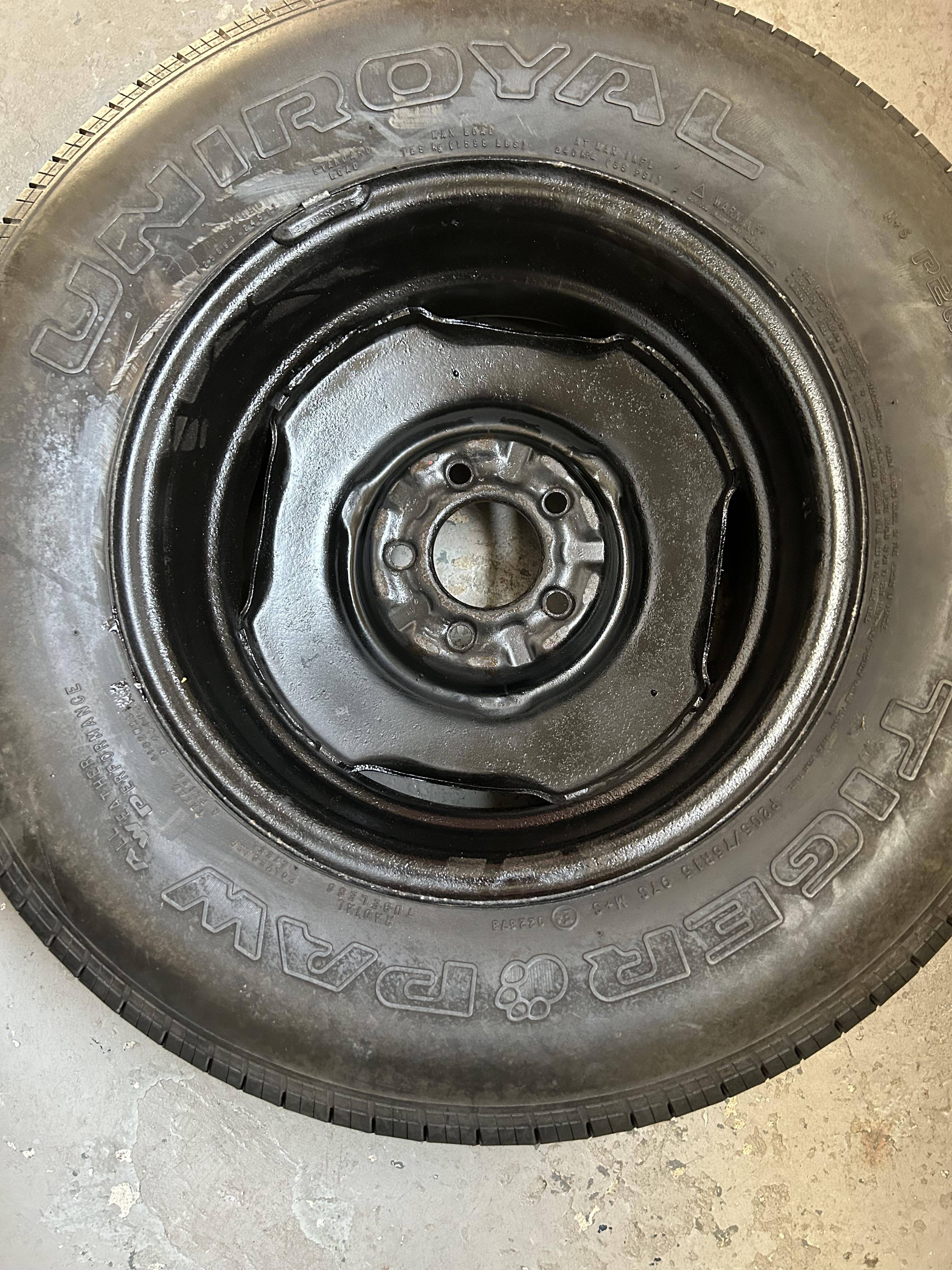

Hi I have these 15" steel wheels on my '73 now i know the factory shipped with 14''; i am looking for a replacement steel rim , looks like they are 7'' wide or 7 1/4'' and the back spacing is 4'' or 4 1/8'' my question is where can i find a part number on this rim to confirm the sizes, and who sells new or used ones thanks.

There are often numbers stamped along the inside of the rim, and can only been seen once the tire removed. These may show a date code, rim size and Chrysler symbol. That said, we can still measure the dimensions of the wheel, etc, from the outside. Even when you can find the stamped numbers, they don't always indicate an actual Chrysler part number. That said, there are often numbers on the outside on either side of the valve stem opening.

Hi if anyone can confirm the back spacing of 4'' or 4 1/8'' on these rims please let me know. Thanks moparleo i did ck tonys parts a little pricey for my use

back spacing from 4 " to 4.5" will work just fine ..there are other venders that sell mopar steel wheels cheaper but don;t have the part number just google it
