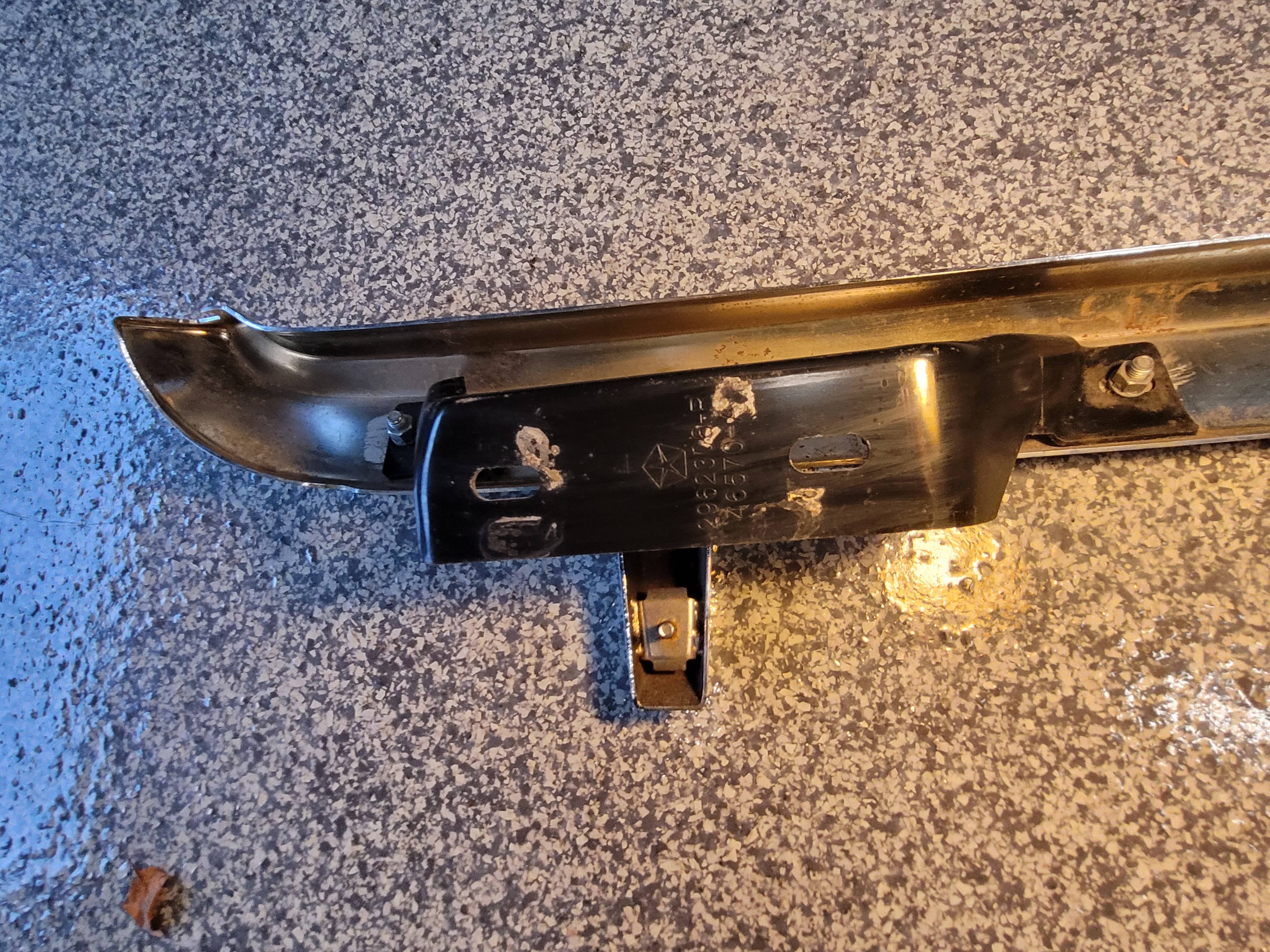

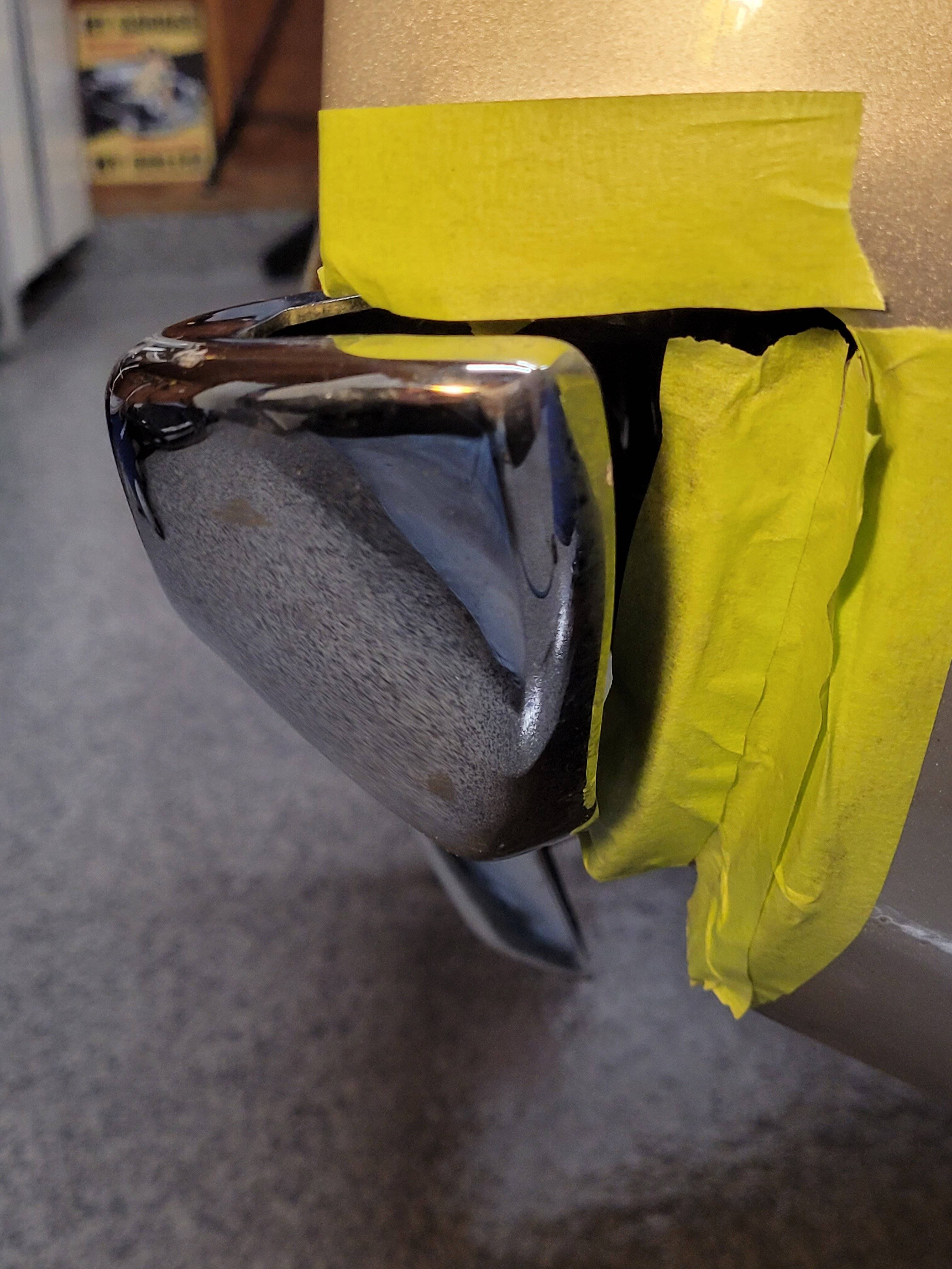

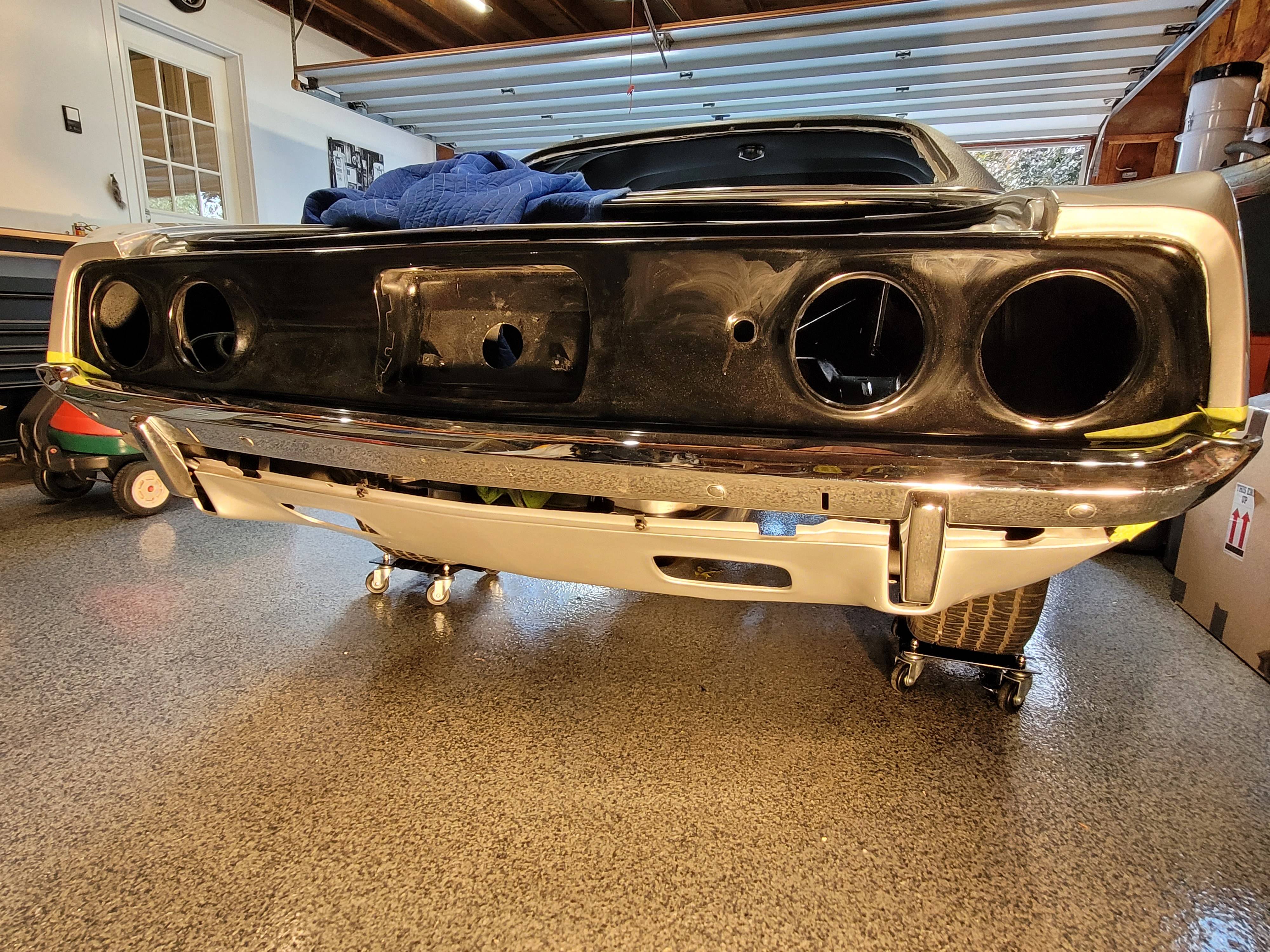

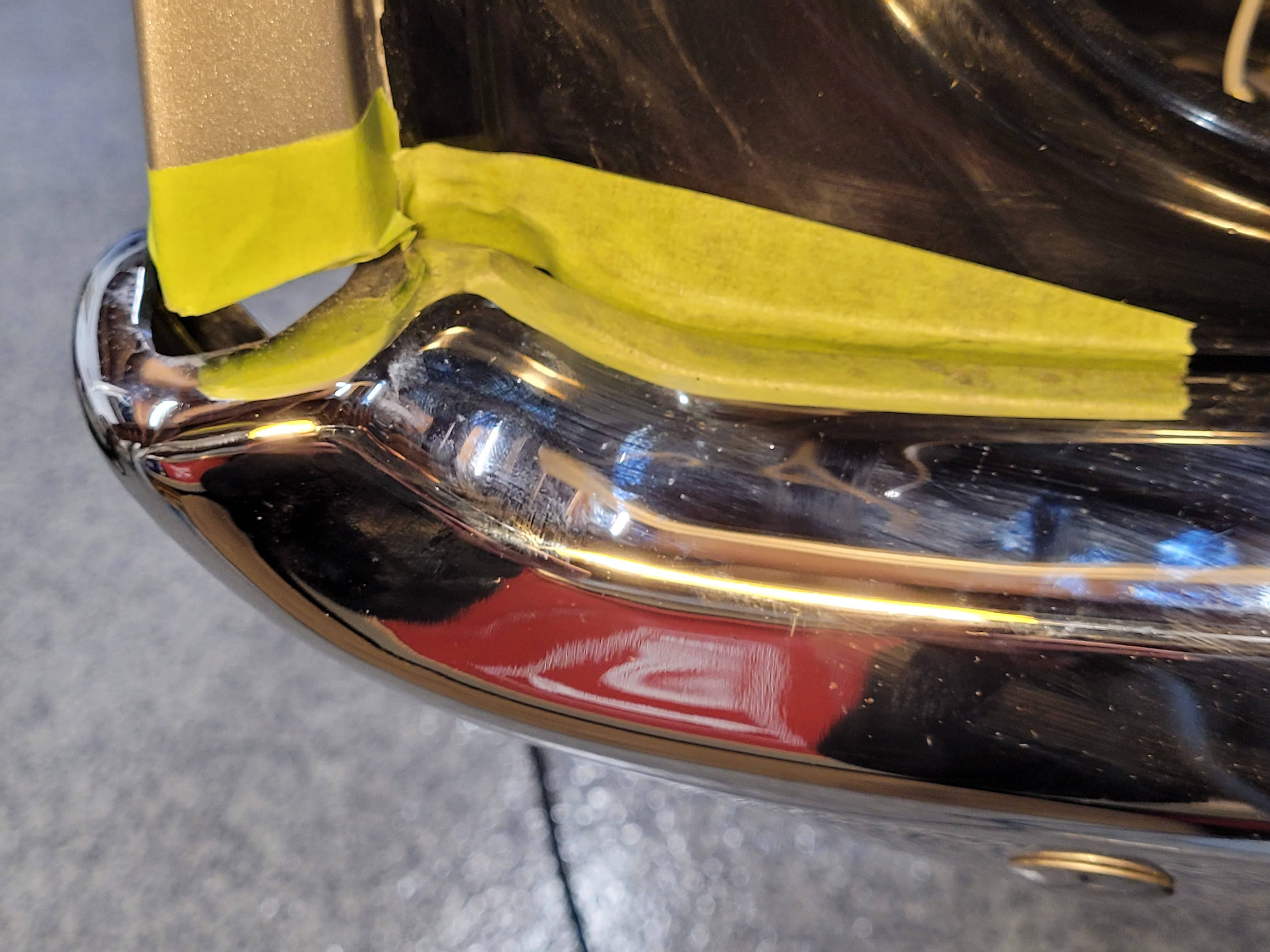

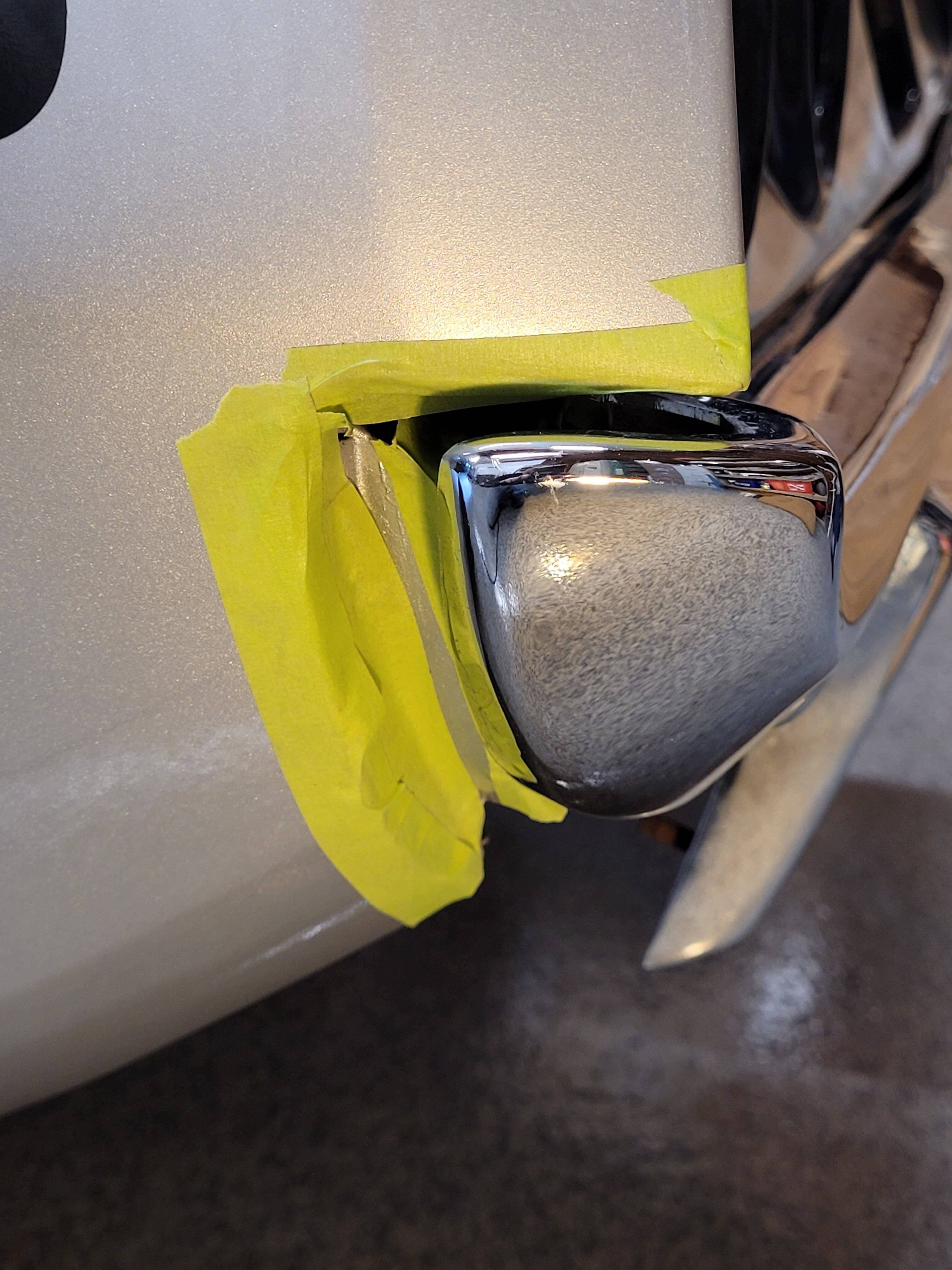

I bought a '71-'72 Rear Bumper with Jack Slots and '70-'72 Rear Bumper Brackets. As you can see by my pictures, the Bumper won't get any closer to the body and I have large gaps. It sits higher than it should and there's a lot of space between the Bumper and Rear Valance as a result.

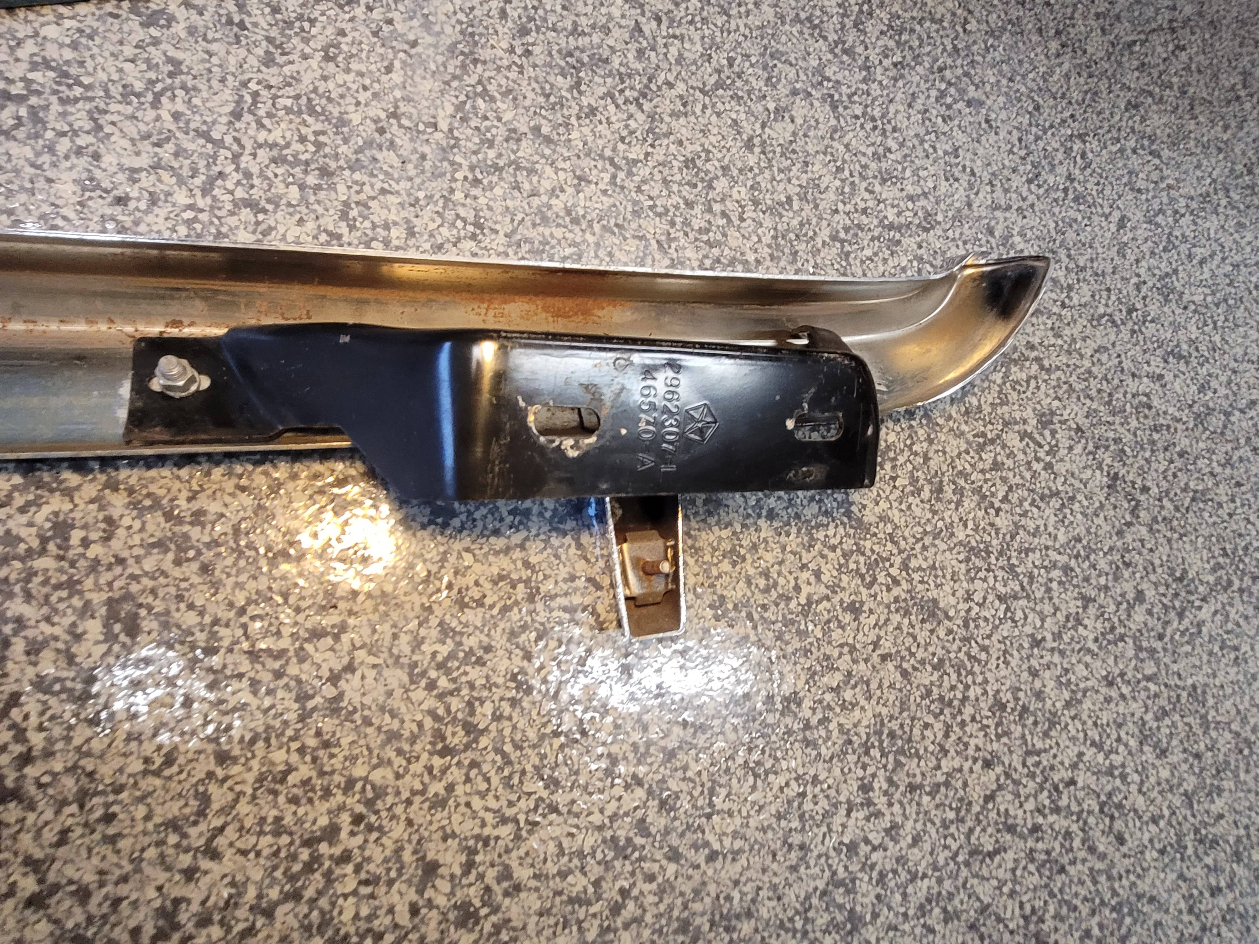

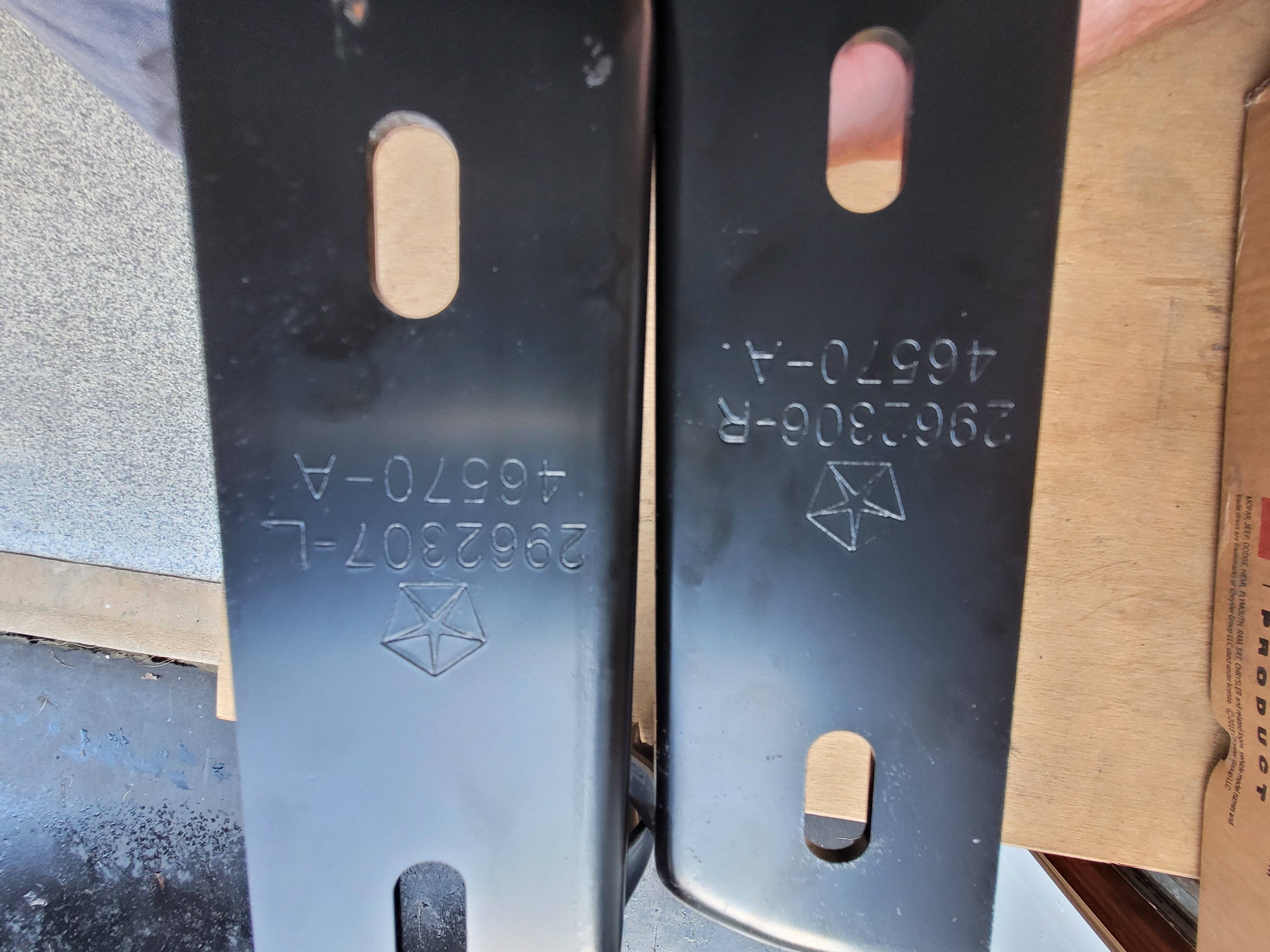

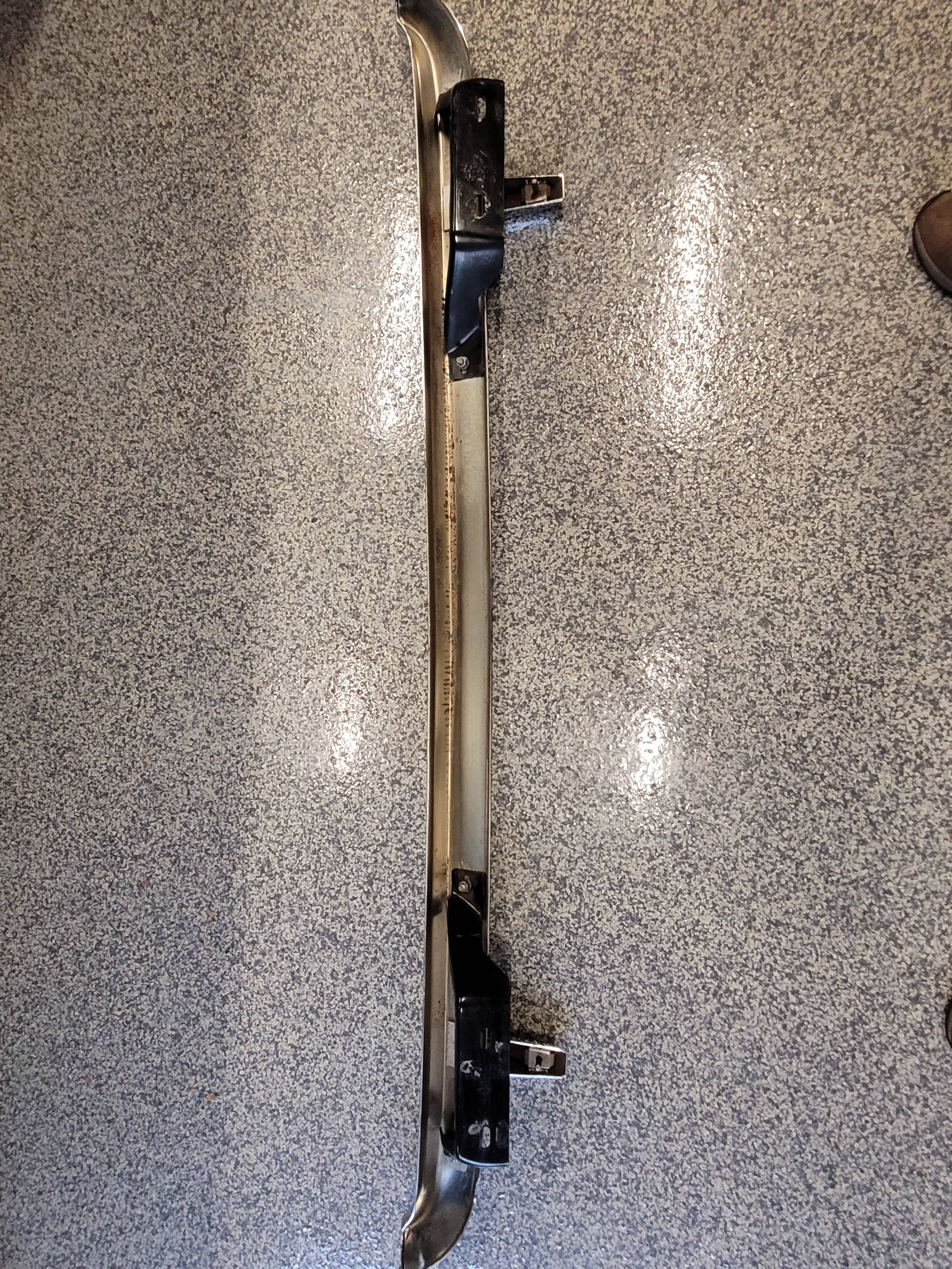

The Rear Bumper Brackets I purchased from AMD are PN 970-1570-S and are stamped with the Mopar PN 2962306R and 307L. According to "moparman31" microfiche research info, these may be the incorrect Brackets (Challenger) and should actually be PN 2768604R and 605L Brackets (Cuda). I've checked the '72 Car parts Catalog however and it states they should be PN 2962306R and 307L like I have for the "B" model car?
AMD was also not able to confirm the cross reference of their PN 970-1570-S Brackets with the Mopar PN 2962306R?

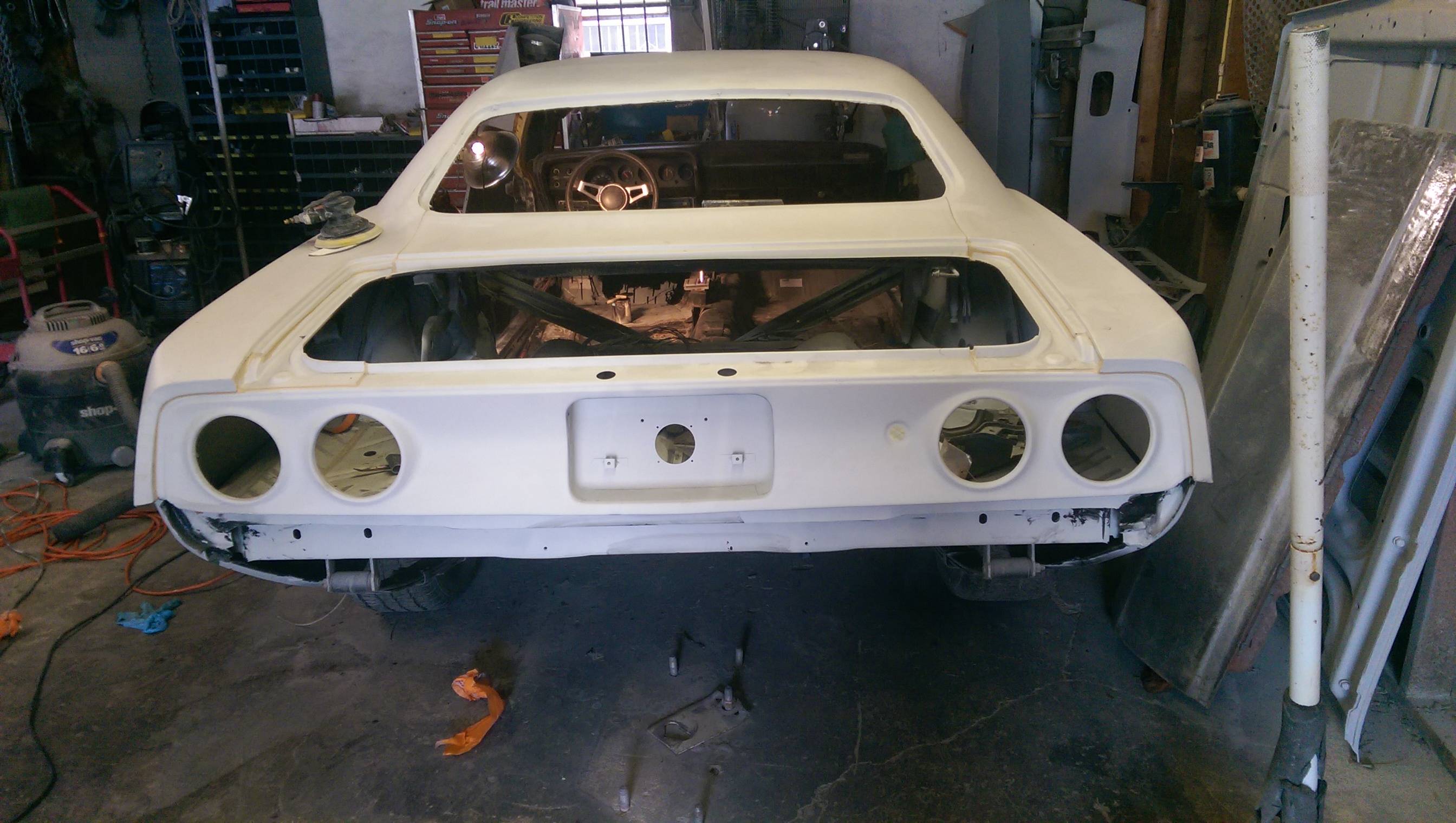

The car did have a fair amount of body work done at a shop, with a lot of my own help, which included new Rear Quarters and a Tail Panel, but I don't recall replacing the Rear Crossmember and it appears to be welded correctly to the end of the rear frame rails.
Does anyone have any ideas on what the issue might be?
