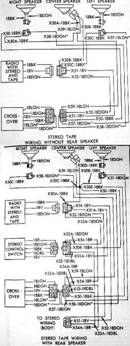

I'm still uncertain of how the wiring is supposed to go. The previous owner has cut a lot of the wires. Does anyone have a schematic or wiring diagram for one of these harnesses? Thanks
340challconvert
Feb 13, 2011
5,456
2,928
Parsippany, NJ
Hope this helps!
nakabrd
Jul 11, 2013
74
4
Thanks paharamia. This does help. It shows me that I have a harness that's supposed to go back to a rear speaker. Those connections have been cut and removed. Now I need to find a rear speaker switch and attempt to rewire things. Thanks again.
