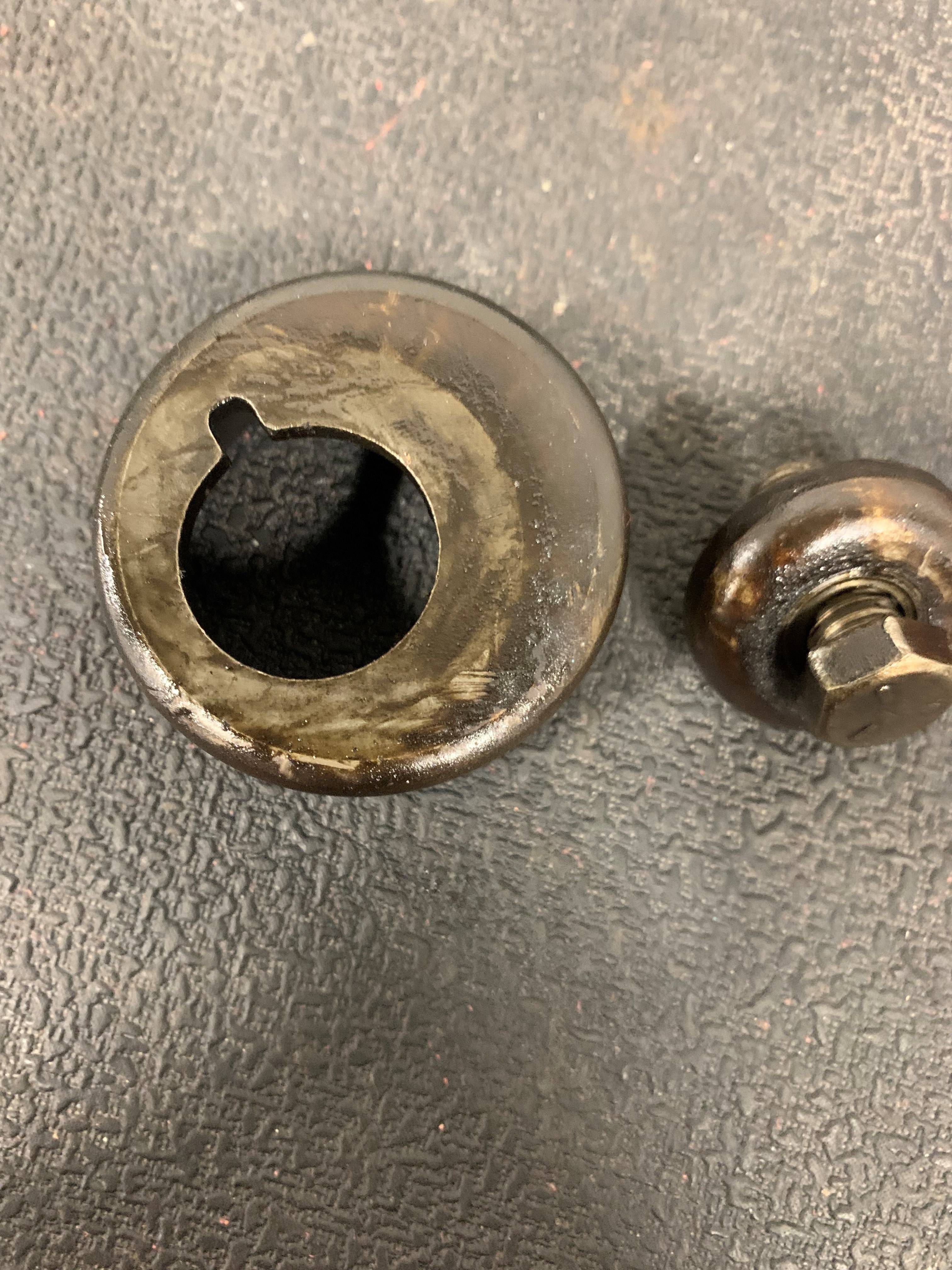

Just checking to make sure this is normal; I have done a few Cam swaps in my life and the cam bolt is typically centered in the engine block. My 318 has this cam bolt flange which is clearly off-center, is this normal?

Standard on all carberator Mopar LA small block engines. Without this eccentric, the manual fuel pump won't work.
Make sure the woodruff key is installed properly and gets a good bite on the eccentrics' slot. If the eccentric slips off the groove, you will be stuck . No fuel.
You should have a Factory Service Manual. It will illustrate these things and give you all the torque specs.
