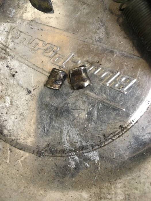

Ok guys thanks for all the input. I waited too long to pull the trigger on the 340.
I pulled the 318 and found out that the pieces of metal where valve spring keepers and that the plastic cam timing gear was cracked and had a bunch of missing teeth. They were all Over the bottom of the pan and in the oil pickup screen.

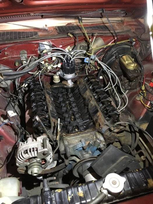

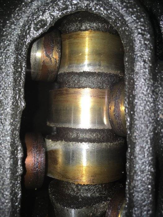

The 318 was tore down and cleaned up, everything looked good. New cam bearings and summit 6901 cam and high volume oil pump and new pickup. Cleaned the stock heads up and lapped the valves. Got a performer intake and might put the holley 750 back on or go edlebrock 600. Gunna throw headers on it to. Are jegs brand headers any good for the e body? Either those or Doug’s.
