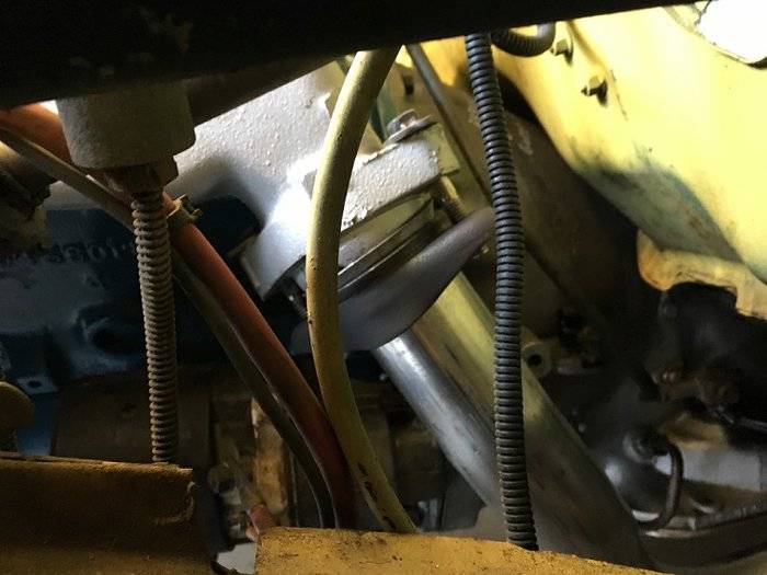

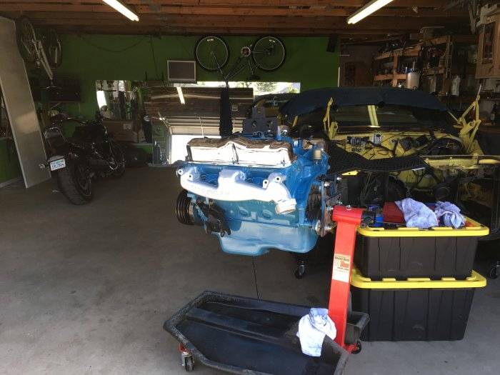

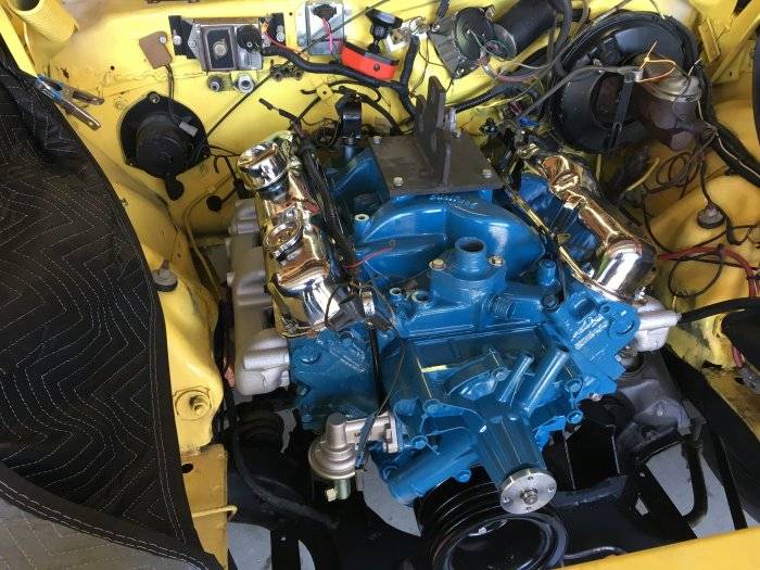

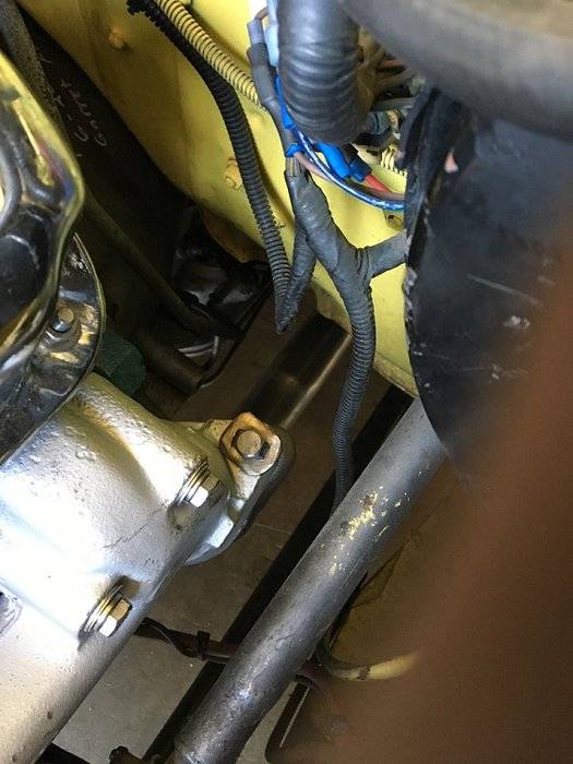

little update and pictures for OP or anyone else looking at these manifolds. The Jeep Grand Cherokee fit like a champ, using a small Wix filter and NO right angle adapter. I could probably fit a full size 1qt filter and I'll give it a go when I change the break in oil in another couple of hundred miles. The drivers side Dakota manifold I had to machine about 3/16 of an inch off the manifold to engine mounting face and would/should have done a 1/4 inch. With the gasket it was just barely touching the power steering gear box. So back off it came and touched the interference area with a sander, problem solved. Took the car over to a local muffler shop to have new head pipes bent and installed to my existing exhaust. All in all it worked out great and I highly recommend this route to headers for us old guys and street cars

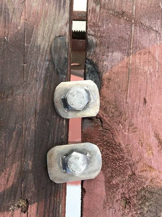

. Also added some flat stock to the exhaust head pipe bolts as an anti-rotation device so you don't have to fight putting a wrench on the bolt head, just use a socket and long extension from under the car, works out great.
