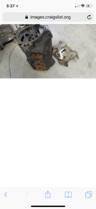

If later in the future I wanted to build a big block and put it in my 70 Challenger. Would this be a good route to go?
Some people are telling me yes, and some are saying no because the block might could have a potential problem I’m not aware about.

You just need to take it to an engine builder/machine shop and have it evaluated as a core. If it’s standard bore it most certainly be worth having it sonic tested. It looks like it doesn’t have main caps?

IMO no . while the block may be Ok why build a small big block ? With a stroker kit you can get 430 ci with a streetable build using the 383 block .
The 400 block is stronger & A 440 block can get you 512 ci in a street build .
A stock 383 vs the 340 , the 340 is almost always faster , they have almost the same stroke , but the 340 has a lighter block & internals so all thing being equal 340s will out run a 383 so why pay the weight penalty to go slower ?

Got it totally makes sense! Thank you for input and knowledge. I will definitely pass on this and stick to getting a 340 in the near future.
