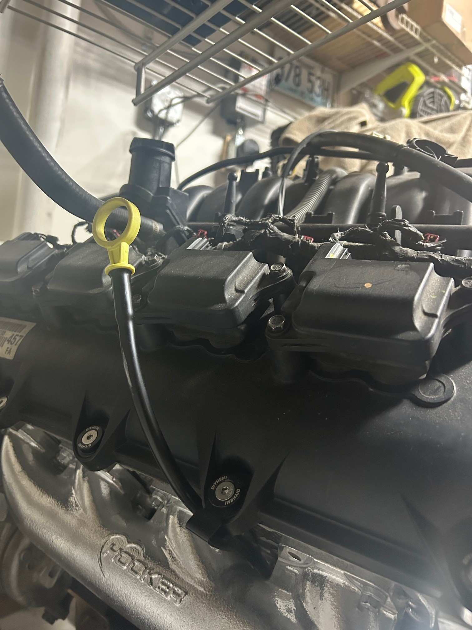

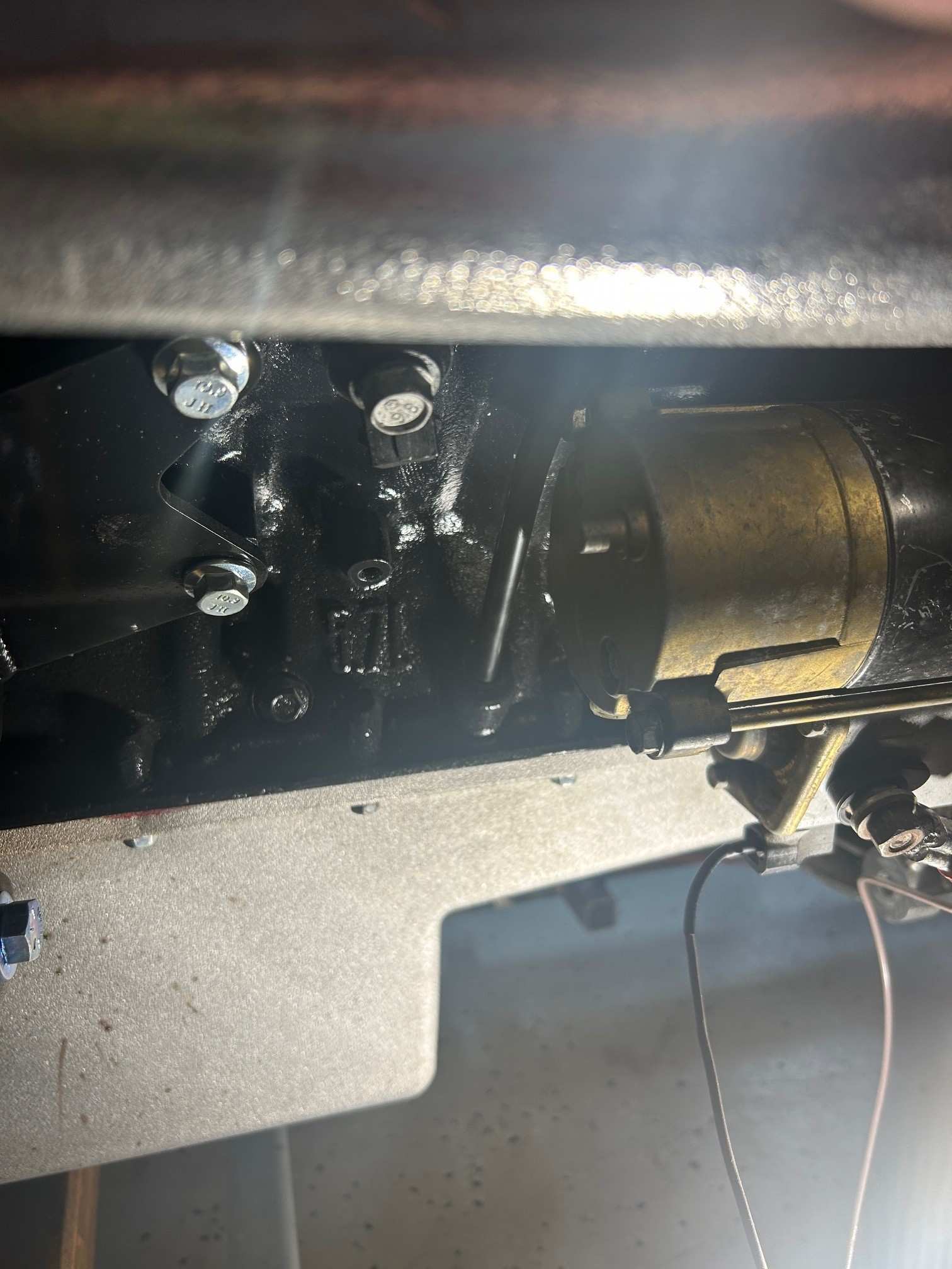

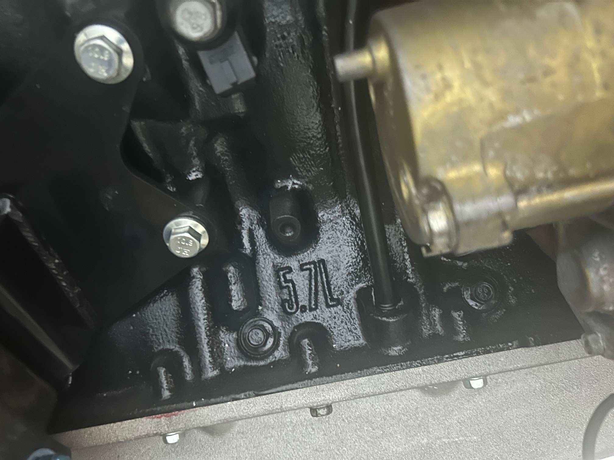

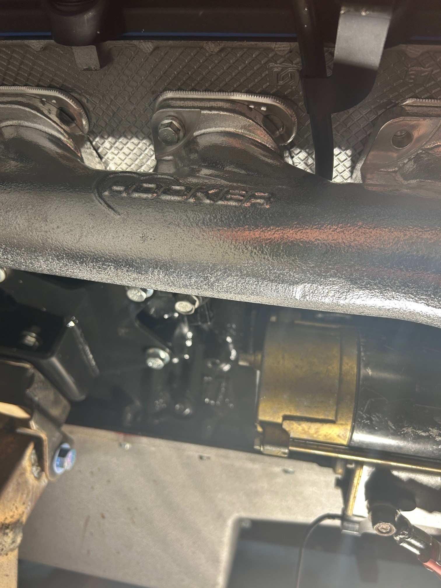

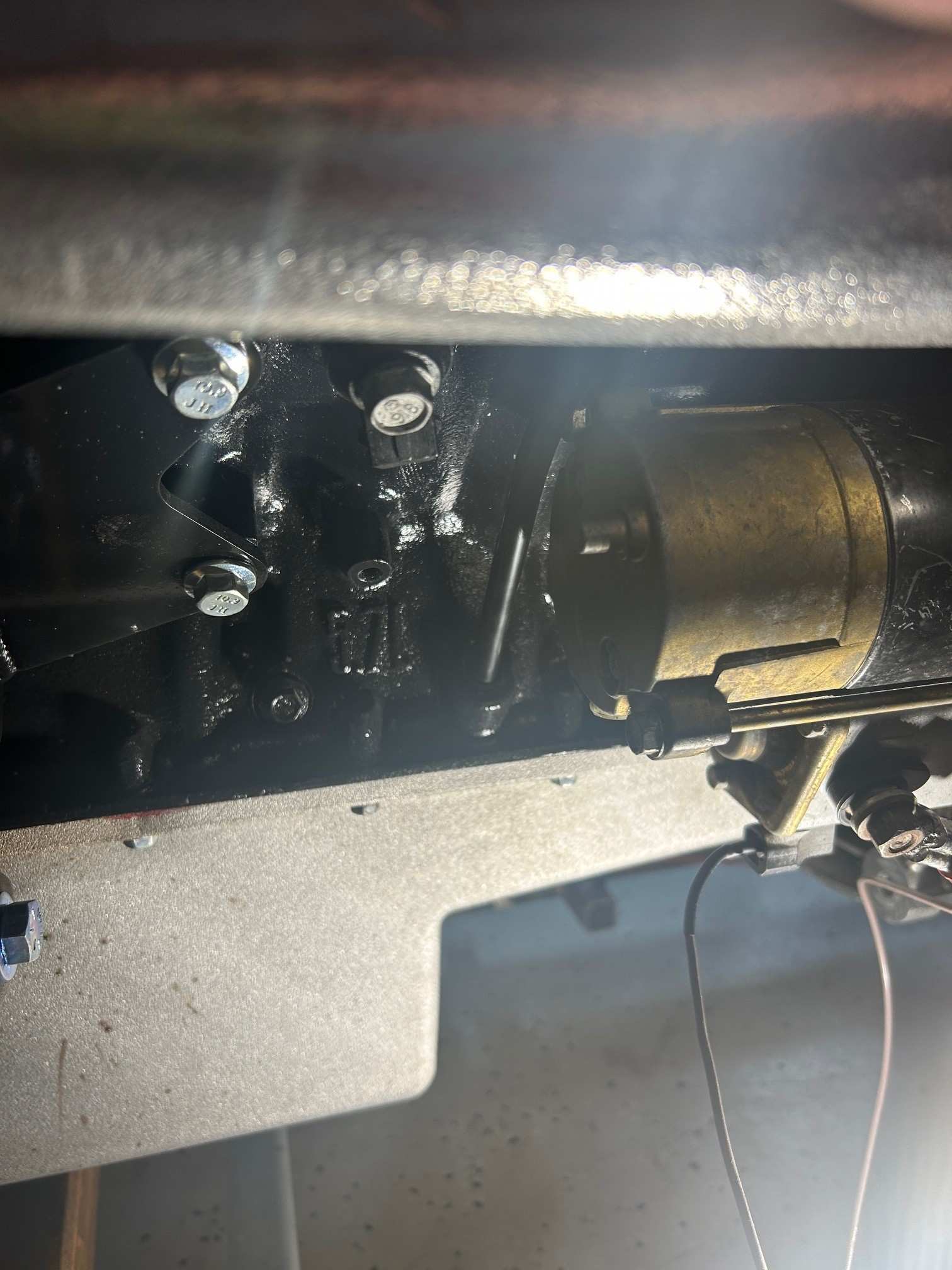

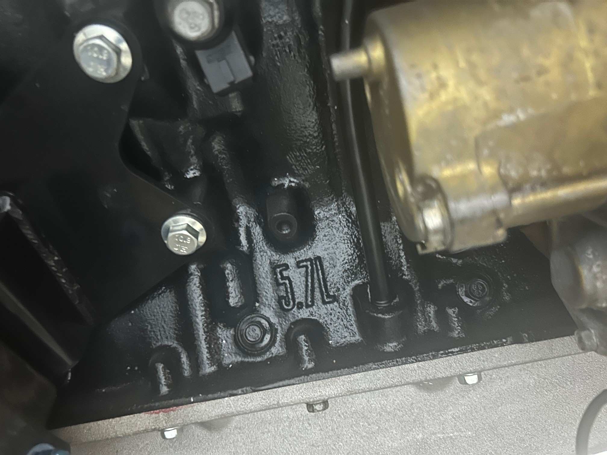

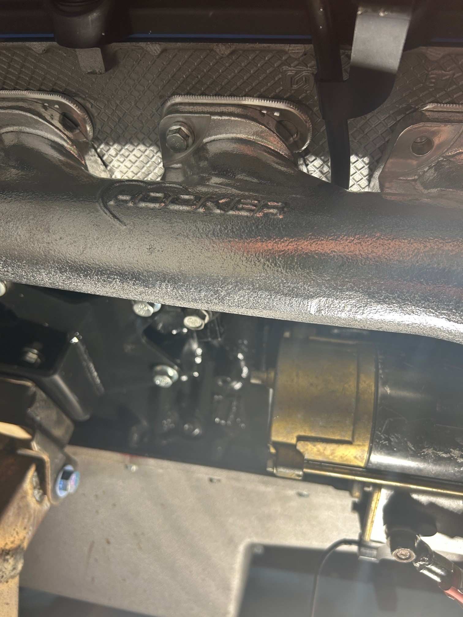

I've got the Holley blackheart cast manifolds with ceramic coating. the dipstick barely clears the back of the longer starter, but it snakes almost directly up from the block. It attaches to the valve cover. I did have to do a little adjusting, but overall, I'm happy with the fitment. I apologize for the lack of a wide shot of the installation, the engine is mounted on an engine stand and I'm too lazy to drag all the cars out and pull it out from the corner. hope you can see what you need to see. if not, let me know and i'll take some additional shots.

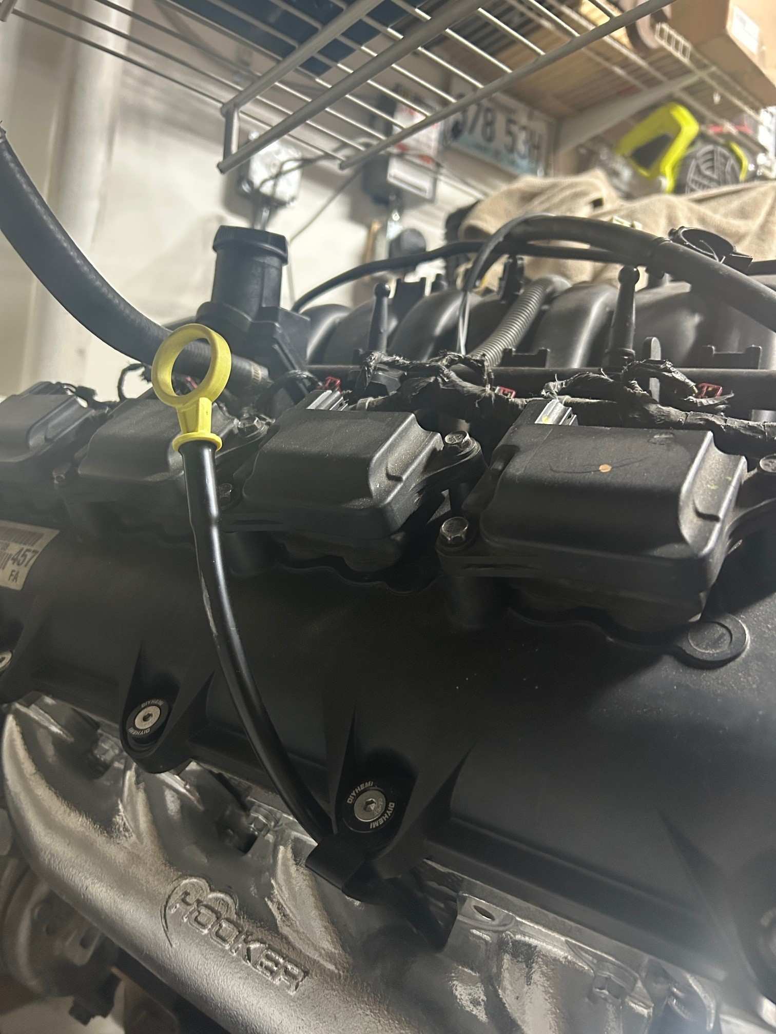

I have used a few. Second picture with yellow handle is the Holley one. First picture is one from JEGS. Link below. View attachment 133118https://www.jegs.com/i/JEGS/555/616...MIw_rmgcO8igMVUTrUAR2d7im_EAQYCCABEgKfW_D_BwE

Appreciate the pics, I have TTI shortie headers.
I'm trying to visualize the routing, looks to be close to block with a slight s-curve, right to left.
The pics are super helpful. I bought the same Blackheart manifolds for mine. Thank you for sharing.
