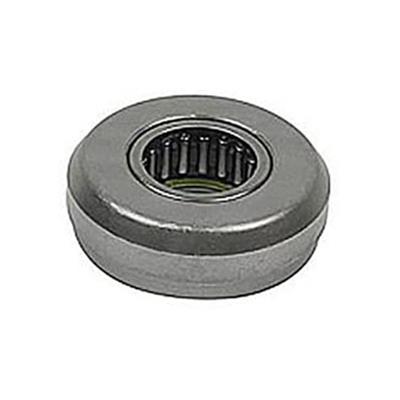

Did you use stock cross member for trans? Or Holley? Did you have to shorten the imput shaft? Did you use remote filter? Thanks again Harry

Yes stock trans crossmember , didn't shorten the input shaft , used a Dakota roller brg & remote oil filter system
Great I didn't want to shorten the shaft. I have lakewood bellhousing with shims so should be good will look up dakota bearing. Thanks again
