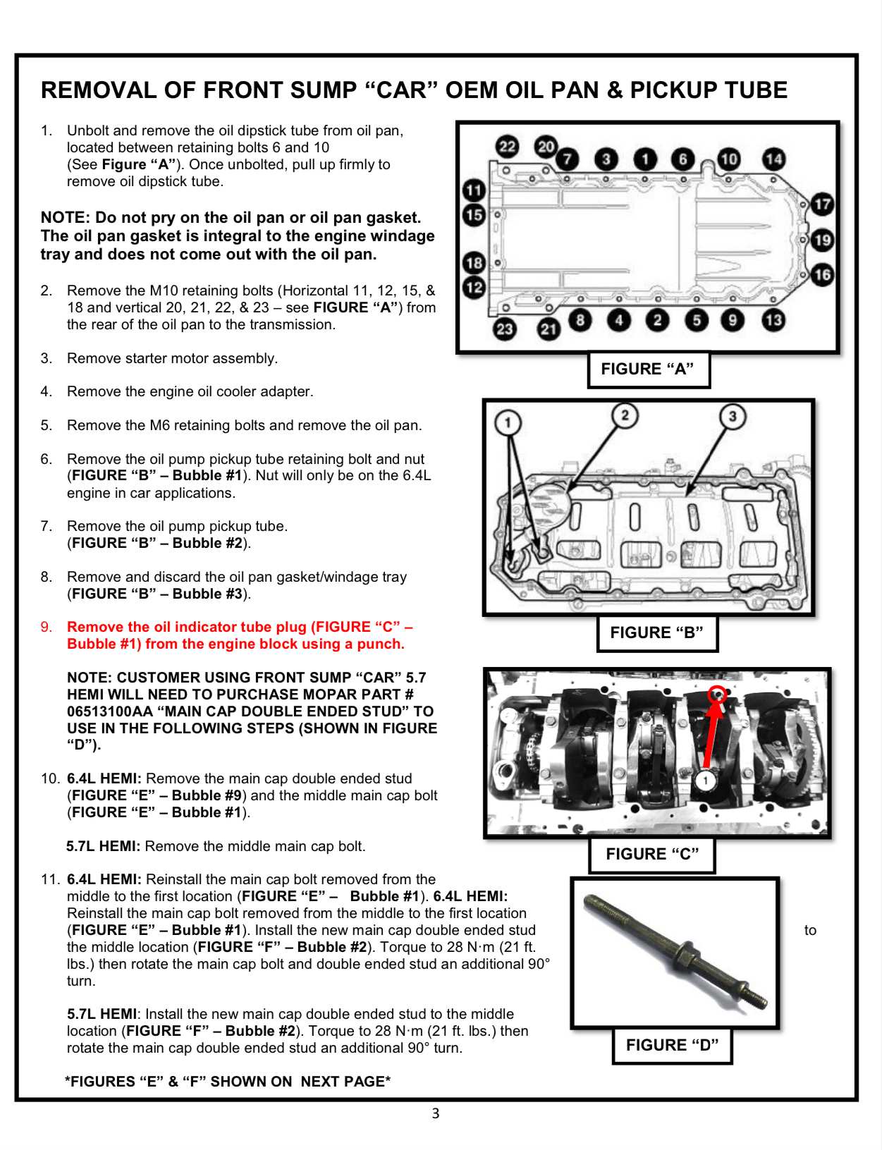

Check out the instructions for the oil pan on the Holley website, if your oil pan didn’t come with them. Here is the page showing what you need to do.

LOL thank you both for the replies, and actually maybe I'm asking the wrong question: how can I find the right hole (LOL) in the block? I tried doing some research and can't find any reference to where there's a block-off or plug that I can remove and install a dipstick - or purchase (an unknown) fitting to facilitate a dipstick install.
Again, help from those who have "been there and done that" is greatly appreciated.
The picture I added above specifically shows the hole. It’s even circled in red. The only two things in red are saying how to remove the plug and an arrow pointing to where it is. Do you not see it?
OMG well there's "seeing it" and there's "understanding what you are looking at".
What threw me was the term "oil indicator tube plug". So basically there a plug that needs to be punched out, and that's where the new dipstick goes. Got it.
Thank you for helping me understand.

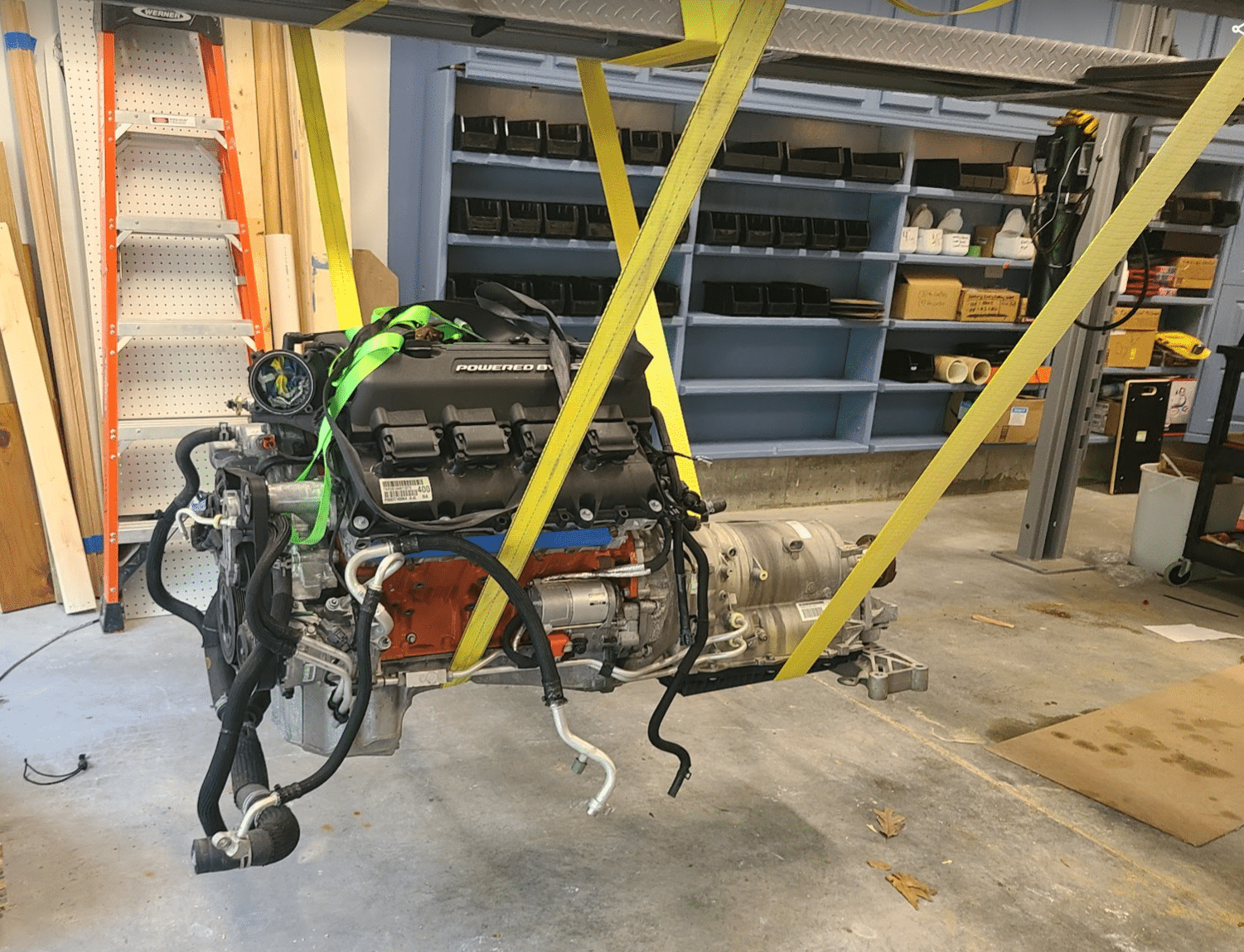

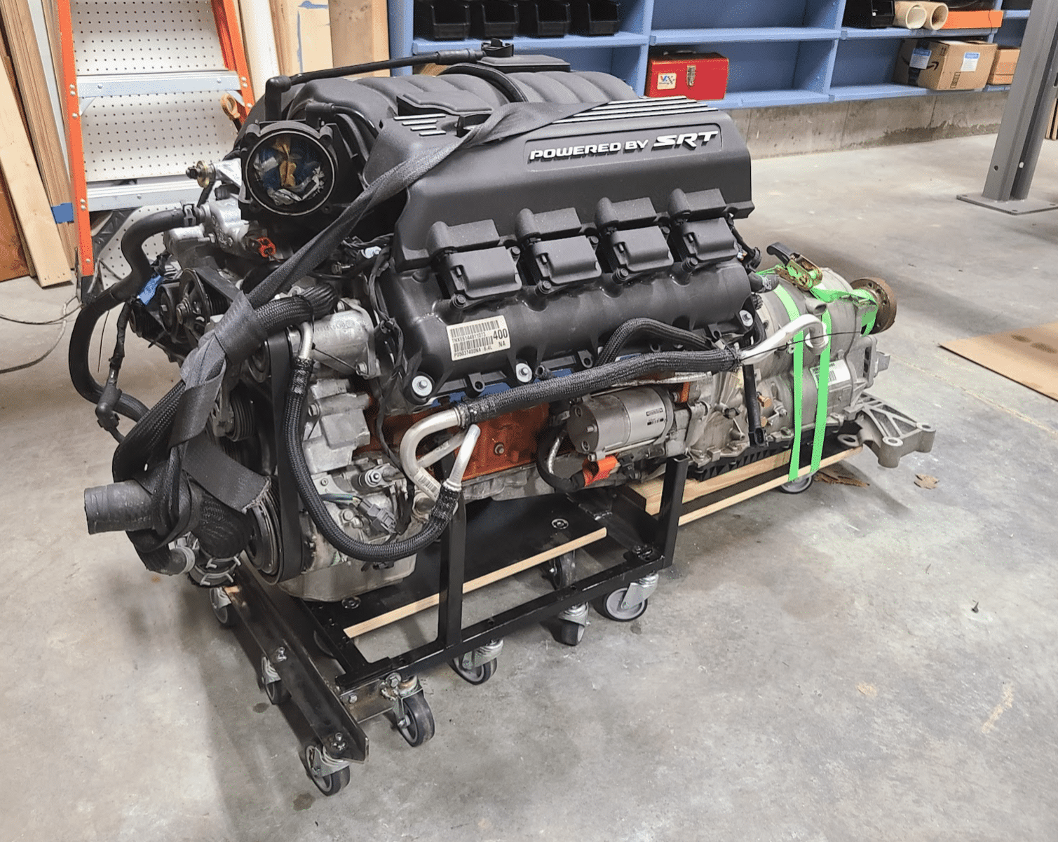

Related question for folks watching this thread: has anyone done the oil pan R&R with the transmission on their engine and the engine upright vs upside down on an engine stand? I thought about maybe trying to angle it over to one side or the other before making the switch, but not sure it's worth the effort it would take to do that. Maybe just bite the bullet and work upside down?
Many times. It’s obviously not as easy and I do have this engine dolly that is in the link below:

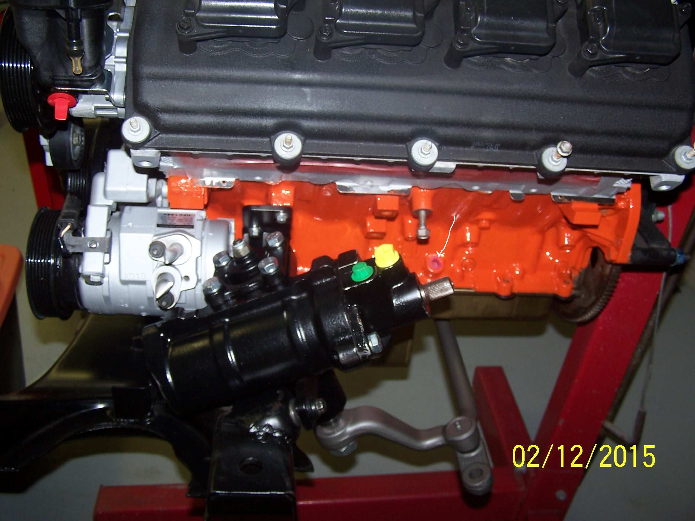

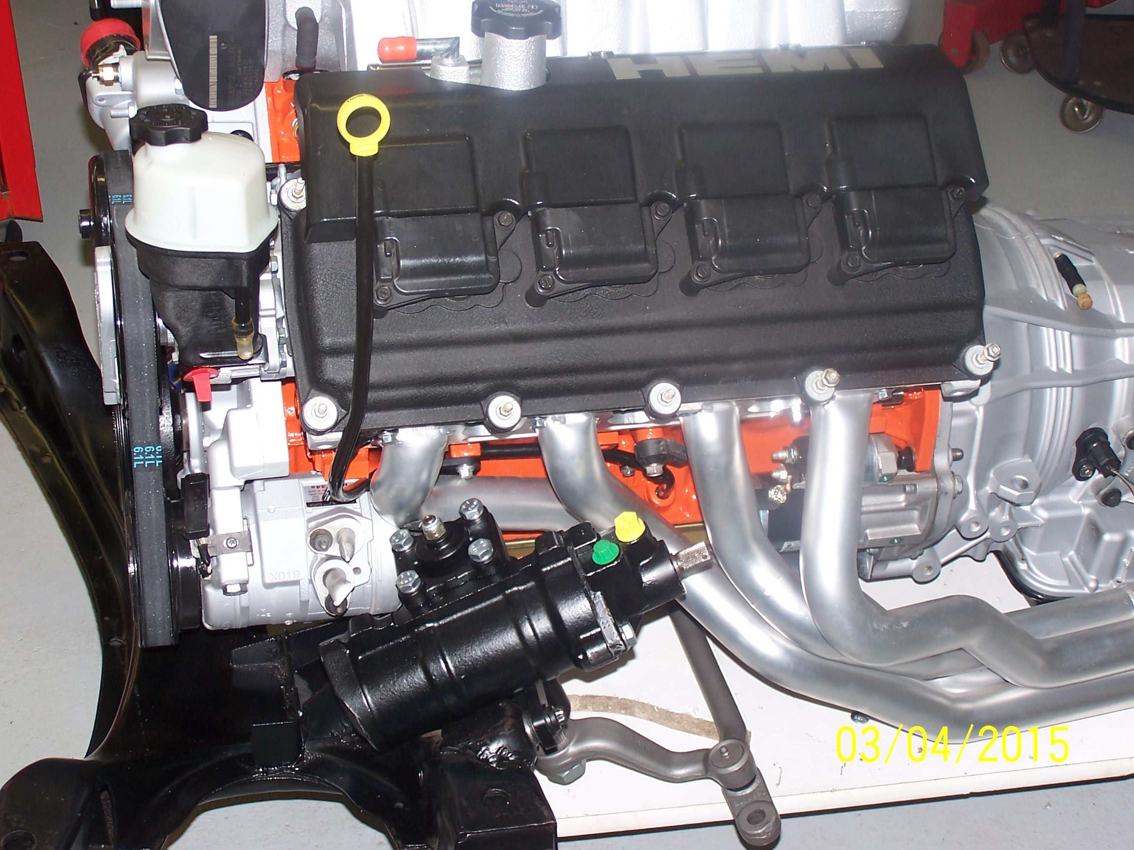

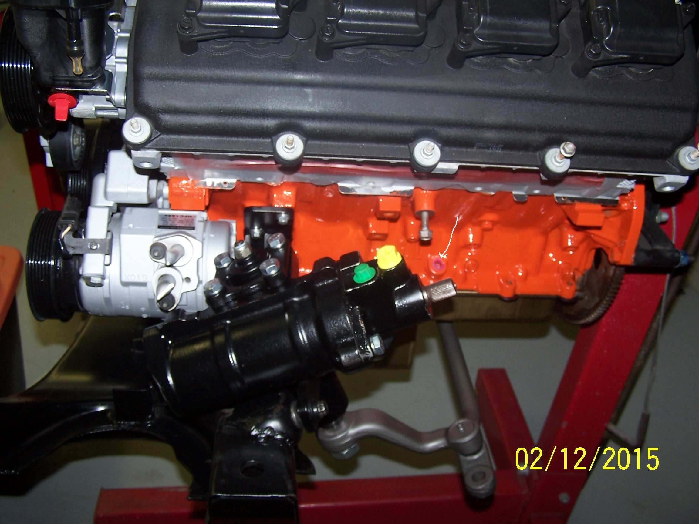

Here is a pic of my 6.1. I punched out the metal plug when I had the pan off and put in the blue plastic plug for when I installed the dip stick. Also a pic of the Bouchillon dip stick. IMO, I think I could have done a better job at locating that dip stick than what Bouchillon did. I would have saved a bunch of bends and brought it up between the 3 & 5 tubes and attached it to the knock sensor bolt. Or even the valve cover bolt right there.
Hemi Gen 3 Engine Stand (5.7, 6.1, 6.2, & 6.4)
Are you going to be using the HP-70?
Yes I am planning to use the HP-70, why do you ask? Is that what you have done?
Right now it's sitting in the engine cradle below, but I thought about using my 4 post lift or an engine hoist to lay it over a bit
Awesome thank you so much - the pics are super helpful! I was thinking about using a flexible dipstick setup, does that tube setup work well for you?
sixpactogo
Mar 4, 2017
432
180
Eau Claire, Wisconsin
I would say it works but not well. the dip stick is spliced in the middle because of it's length. Then with all the bends to go around, it is cumbersome at best. Luckily, I don't have to deal with it often. I have thought about trying a different design but have not felt the need as of yet. Now, looking at my picture, it seems like it would have been an easy project with the engine out. It would have been simple for Bouchillon but they dropped the ball on a few other things that I called them on. That is why my calls don't get beyond their office girl. That is okay though cuz I don't need them anymore. Good luck with your build. I wish I would have had your options back in 2014.
ok that's helpful info and I am going to look at other options. That looks like a lot of bends for sure. Thank you for the helpful advice, back in 2014 you were one of the "pioneers" LOL!
