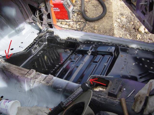

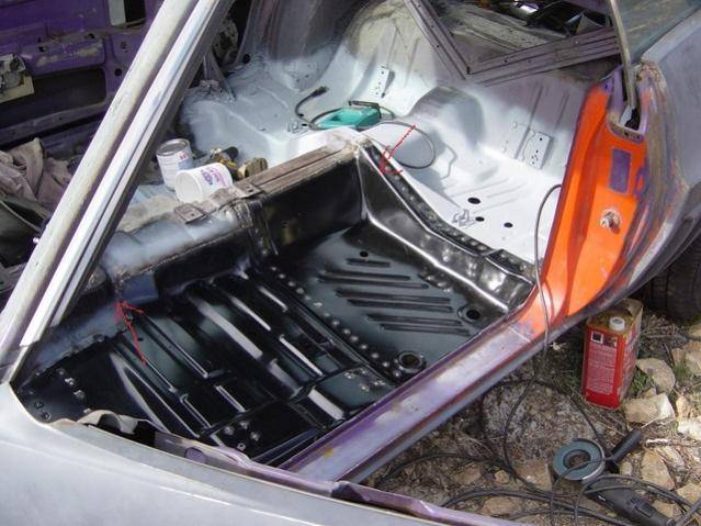

My original 4 spd Challenger is 31 & 3/4 inches b/t the red arrows. If you are working on a Cuda it will be different. One has a two inch longer wheelbase and I believe an extra inch is in the rear footwell.

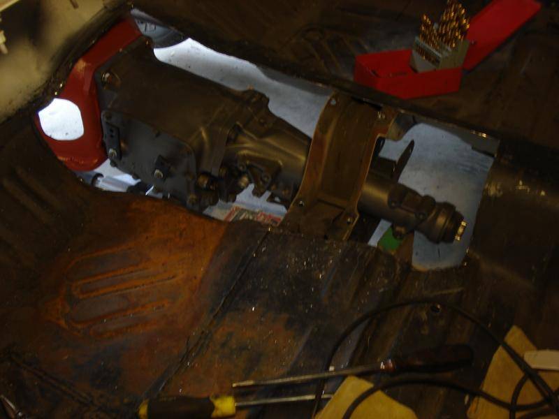

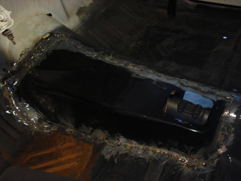

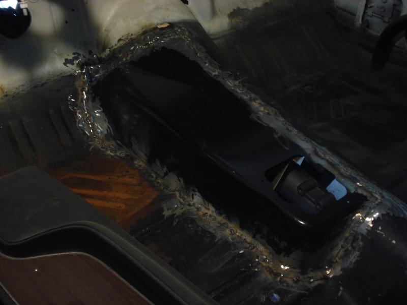

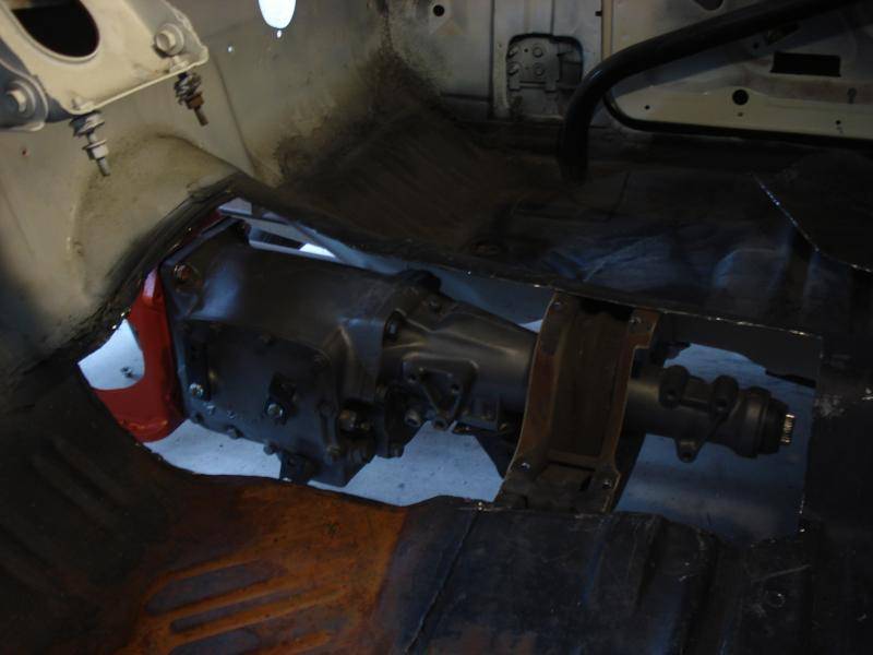

DSC02436.jpgDSC02437.jpgDSC02438.jpgWell got the 4 speed hump in. I think it came out pretty good for a first timer. Thanks guys for your input.
