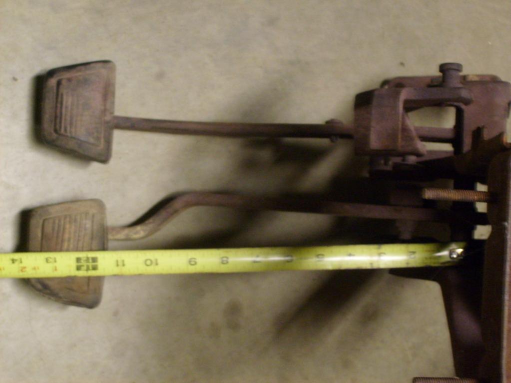

These pedals are 1.5 inches longer than my 71 e body automatic pedal.Does anyone have any idea what they fit.I am guessing 71 b body. They look just like 70-71 ebody except the length difference.Any help appreciated.
Thanks Tom

Thanks it is a fun car. So what was the deal with the pedals? Would be nice to know for reference.
crowbait
Dec 14, 2010
brookville pa
Aparrently stick pedals are an inch and a half longer than an automatic pedal
