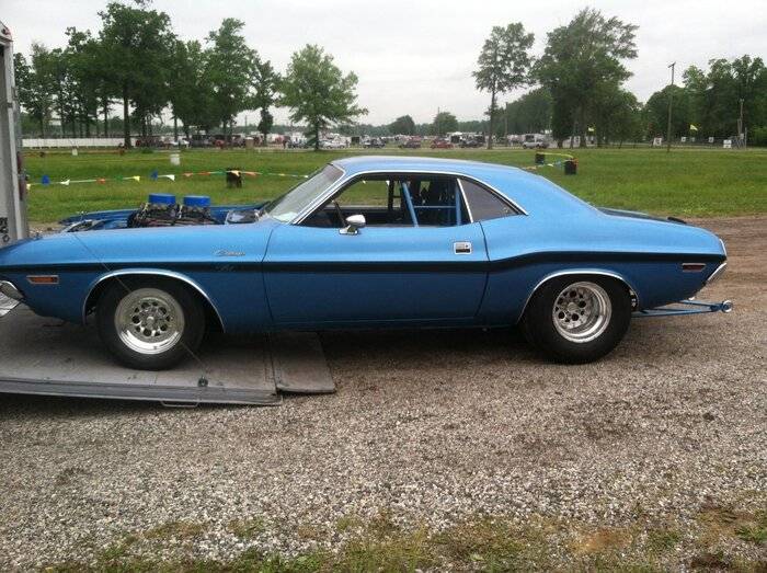

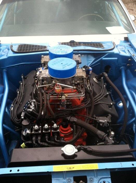

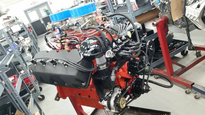

Built my Hemi from scratch with good used/reconditioned and new race parts. I have around $17,500.00 into it, but far from stock. It makes more than double the horsepower of a crate Hemi and triple on the Spray.

528". Long block is all new parts. Iron Mega block was purchased long before they were made of unobtainum. Tunnel ram and carbs were used. I rebuilt the carbs. 10.5:1 pump gas street driven cruiser/strip car. Luckily, I am able to do all the machining and assembly myself which saves money. W.D. pricing or better with all the racing vendors helps also.
