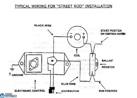

I see that you don't have a stock ignition. The brown wire is for starting and applying full voltage to coil when in the start position.on top right of diagram. The blue wire is for when the switch is in run position at a reduced voltage going through the resistor. on the bottom right of diagram. check for voltage and resistor may be bad. Starts but won't keep running. If that's the problem? You may have to look at the wiring instruction for that distributor.

There might be fuel problems and electrical. The distributor more than likely has has to be connected to the blue wire that is the run circuit. Or both brown and blue? look at the install install instruction.

There might be fuel problems and electrical. The distributor more than likely has has to be connecter to the blue wire that is the run circuit. look at the install install instruction.
Its hooked up as directed in the instructions to the ignition wire. The ballast resistor is bypassed. Im not thinking its an electrical issue. Ill double check everything though.

Are both brown and blue hooked up? There is a split second from when you let off the start to run there is now power to ignition. with out the ballast resistor connection it will die. I understand It's an HEI .
