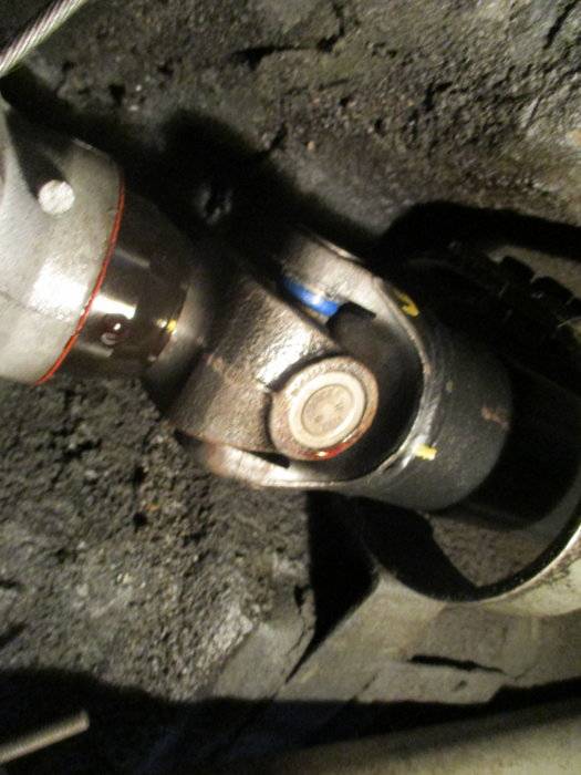

    That looks like the one with the boot. As I recall, the boot was called a "dust boot". Some transmission builders I dealt with would only use this seals, others would use either the booted or non-booted type. Most overhaul gasket & seal kits came with the non-booted type.
