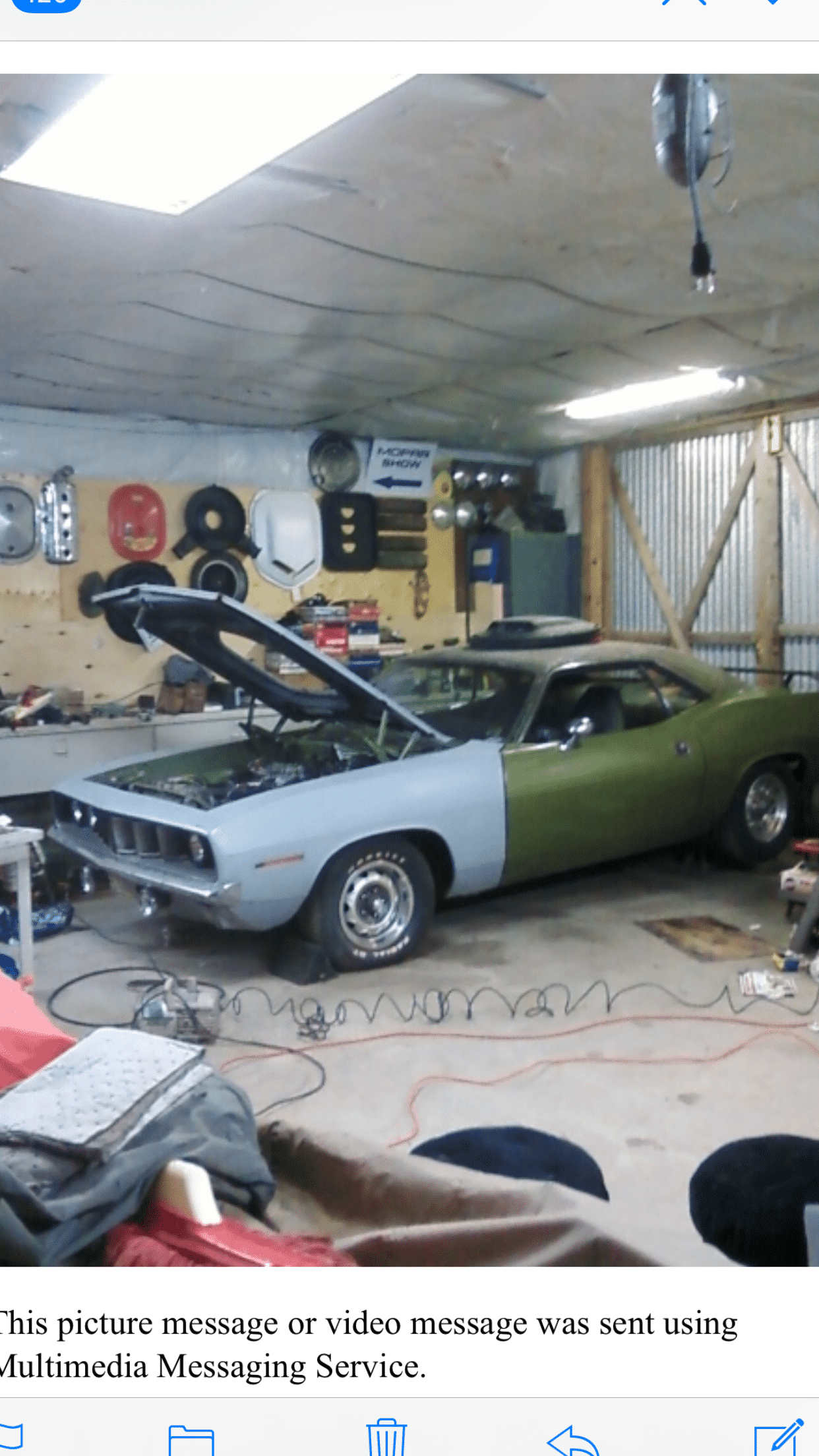

I swapped out a job from a guy who works at a dodge dealership so now I got this complete 6.1 ready to bolt in,is is worth the trouble to take out the 340 from my 71 e body and install the Hemi or just sell it
I got the car in 82 and it had 42k miles on it , I was going to start getting it painted but other things came up and now it’s been setting like that for 10 yrs now retired so I’m going to finish it

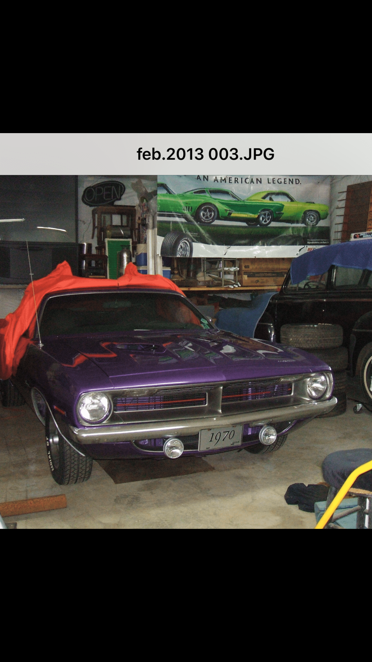

It’s not that bad .. You will have to decide what trans your going to use as that makes a difference on how much work is going to be involved .. I’ve done this swap in my e body and i did a detailed swap on the Hemi Swap section here. You don’t need a custom radiator as it’s one you can buy from Champion cooling. Your most expensive item is going to be the harness. If you have any questions feel free to hit
