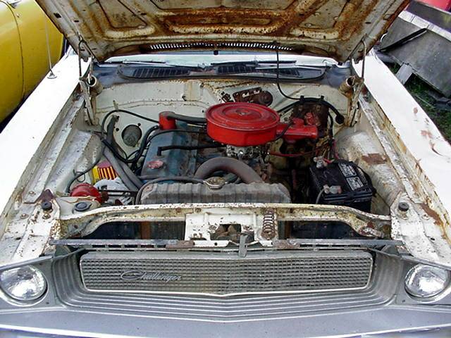

Hey folks,
are there any visual differences between the BARE engine compartment of a /6 1970 challenger and a 440 1970 challenger.

Other than the size of the radiator opening, small vs big, I think they are the same

Take another look at the radiator yoke opening, it is the larger one for a big block. So maybe originally a big block car, need the fender tag to know for sure.

I’m guessing all the rad core supports were the same and you could have had a 22” rad in big block cars, probably standard.

Yes Lee, that and the body vin are the only things that can save us now!

Don’t forget the K member, the engine supports and insulators are positioned differently in the V8 and Slant6 engine bay.

the single exhaust hanger will be on the wrong side on the floor & trunk pans
Fine point,
If a shell is missing the fender tag and the k-member all together, which side the hanger is on could be the determining factor!? Wow
