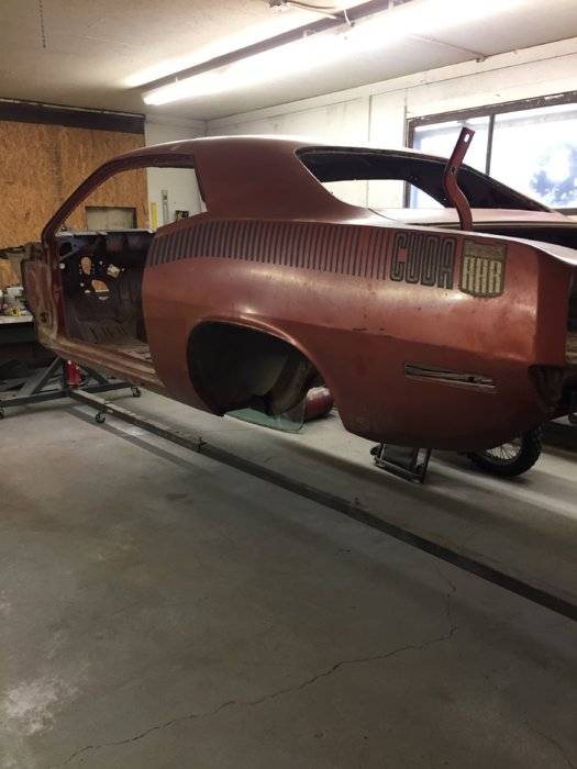

Had the right rocker area pulled and they pulled the front end back over. Rear pass floor area had a wrinkle. Gone now. Floorpans are solid. Frame guy said she is good from firewall back now. I will replace the rails in front and aprons and radiator support, cowl top has damage and has typical small rust through at base of winshield so gets a cowl top. Hood hinge sliced the cowl top.

Save the cowl top and radiator support they have the Vin numbers on them. The upper radiator support looks like it can be removed at the spot welds and straightened out then welded back on the car to keep the original Vin numbers.
I would try to keep as much of the original metal as possible. Post more pictures of the radiator support when you remove the fenders and grille support

Thanks, I'm going to have it media blasted. I'm 64 and have done a lot of rotisserie restorations. Lots of badly rusted ones. This one has typical rust. I know to save all the numbers I can. Since it has original paint, I figured I would have the floors and jambs blasted and sand the rest to metal. Lots of work ahead but I feel better about just blasting the hard to get areas. I'm in kind of central Ks. South of Hays about 20 mi. I appreciate all the info , Like I said it's a learning experience for me as far as what is correct on this car. At least it was totally original when wrecked. So I know what is there is correct. Again thanks and keep looking you'll find one.

Got the windshield out today and doors off. No surprises other than cowl rusted through in one spot. Needs cowl anyway.

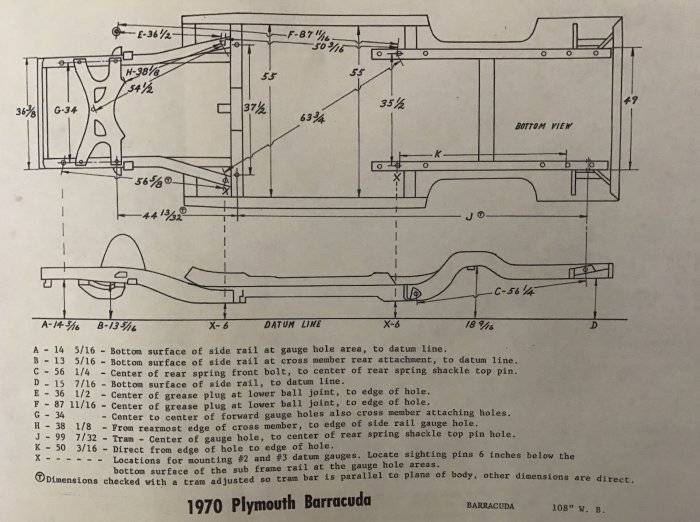

Is this what everyone is using for frame dimensions for a 70 cuda? Oops didn't upload.

Is that dimension D correct from Datum line to bottom of rear frame rail?

Moparlee, Because I get the correct measurement at station 1. Correct at 2,3,4 , then at the rear, (D) I get 18 on the rear. Unless I'm goofy. Where the drawing shows the rear leaf spring perch mount is way forward of where these are. These are close to the rear panel. At the rear of the rail where it attaches to the rear panel I get 18. The drawing shows the rails straight, horizontally and vertically. These are curved horizontally and angled rear to front. Now I know it doesn't matter what the drawing looks like as long as the measurements coincide with the positions of the measurements on the drawing. But according to the drawing the rear measurementis taken between the rear perch mount and the end of the rail. That's where I took it. Also took it at the rear of the rail. Same. And both sides are the same. I could understand it if it was a half inch off....but?
