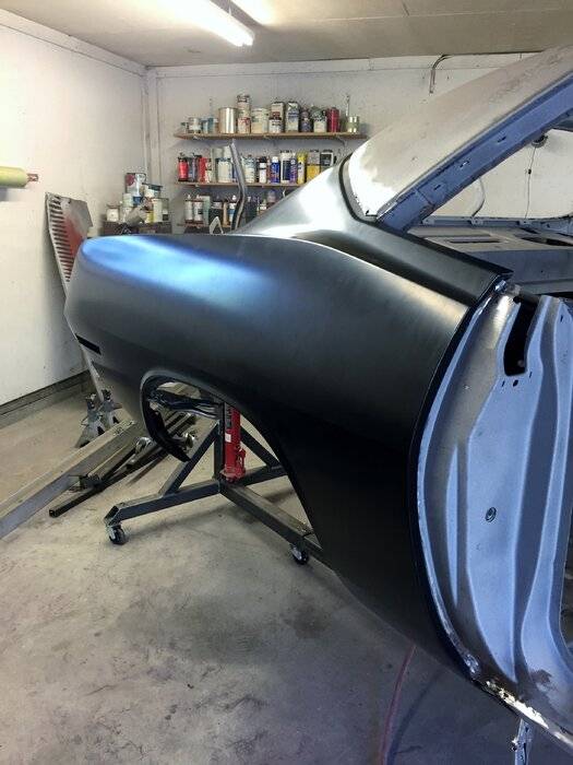

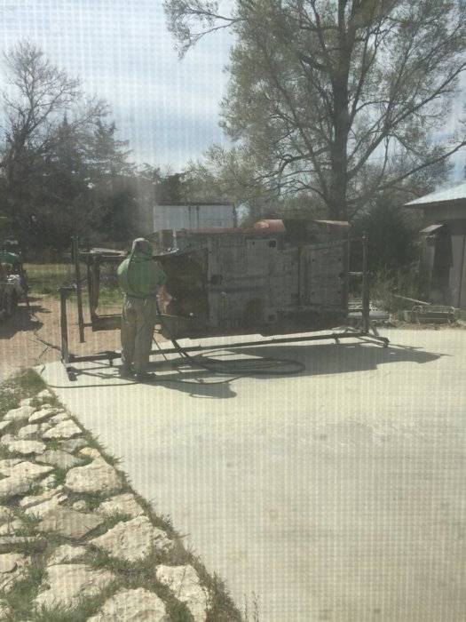

Got it blasted and sheetmetal ordered.
Sweet, love the burnt orange. Mine originally was white guts black top fk5 but they painted it blue in the 80s probably. So I just have traces of the original paint left
Yes the FK5 is a great color I think. Can't wait to see this one in paint. Getting ready to do some metal work on it. Been helping a friend in his shop a little so running around like a nut.

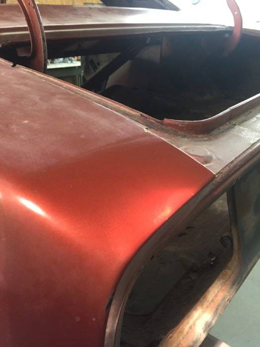

This story starts years ago. My buddy bought a 70 Burnt orange AAR Cuda , 4spd car from someone in the early 70's. On his way home one night in 75 he encountered a bridge, I mean really encountered it! Evidently ice was the culprit. All he remembered was hitting the bridge and waking up in the passenger seat. He had gone from the front seat to the drivers rear seat and ended up in the front passenger seat! He was unconscious. had a cut on his calf from the ashtray and his bell rung bad. Lucky to have survived. He brought the totaled cuda home and stripped everything he could and put the parts away. Flash forward and I convinced him to do something with it. He agreed so here we are! Gonna be a long journey as the car is gonna need a lot of love. I'll put up some pics from when I saw it.
