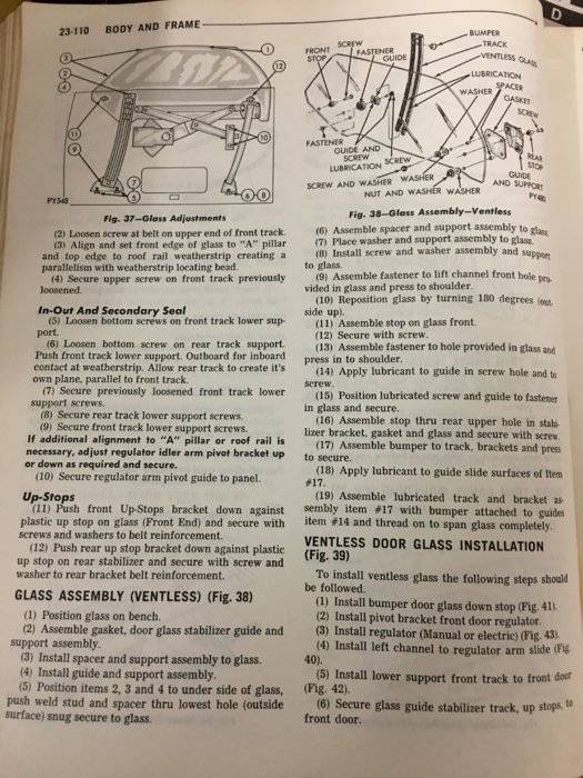

    E56F7652-7C10-4E71-B2D2-C34243A3D62C.jpeg 01D2190D-D1C4-4360-B183-3D67F0F8AE6B.jpeg 497A8601-E57E-4FC1-8B87-9B23075B6538.jpeg E56F7652-7C10-4E71-B2D2-C34243A3D62C.jpeg This may be of some use. I was already in the FM in the fuel section so .....check it out if need be. Good luck. E56F7652-7C10-4E71-B2D2-C34243A3D62C.jpeg
