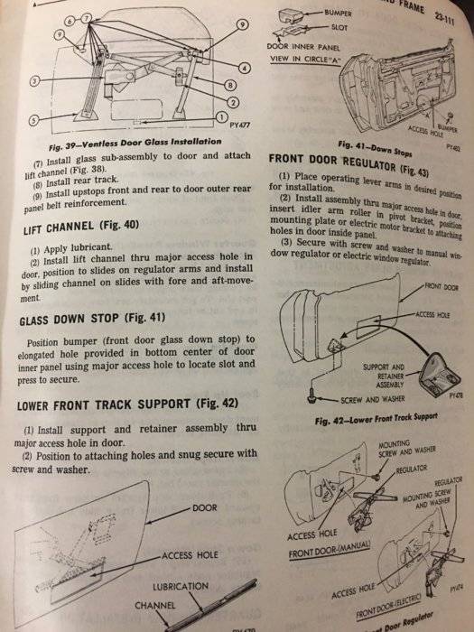

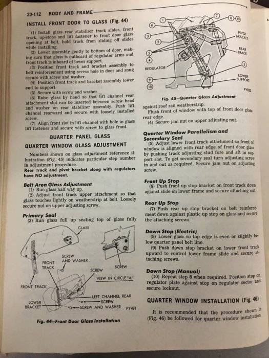

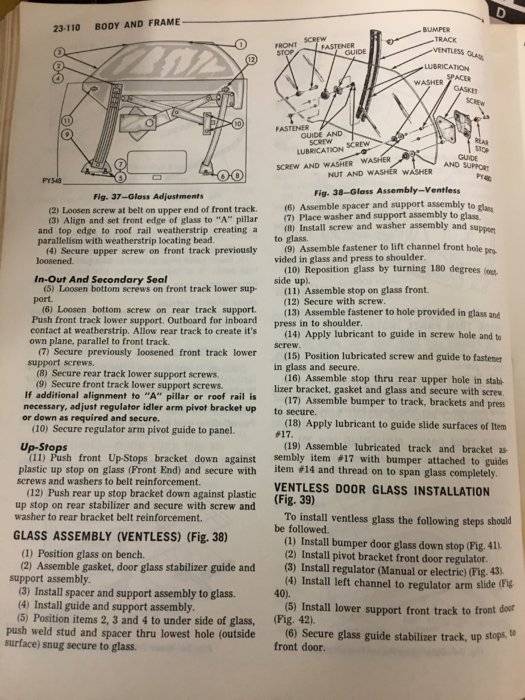

Morning, Where did you source the book? I am in the middle of changing all the glass in doors and quarters. Have the glass and the rebuild kits on hand
fasjac
Dec 27, 2019
2,494
1,256
Arkansas
Sorry all my book are in the attic while we do some work on the shop.
The easiest way would be to download the pages you need. No need to print the entire manual. Mymopar.com

Now it's my turn, I have a 1973 barracuda. I need to install both driver and passenger door windows. Looked easy until I read this thread. Which is a good heads up on what to expect. Did you ever finish the window install? any advice? Does anyone have a drawing or pictures on where the door stops go?
